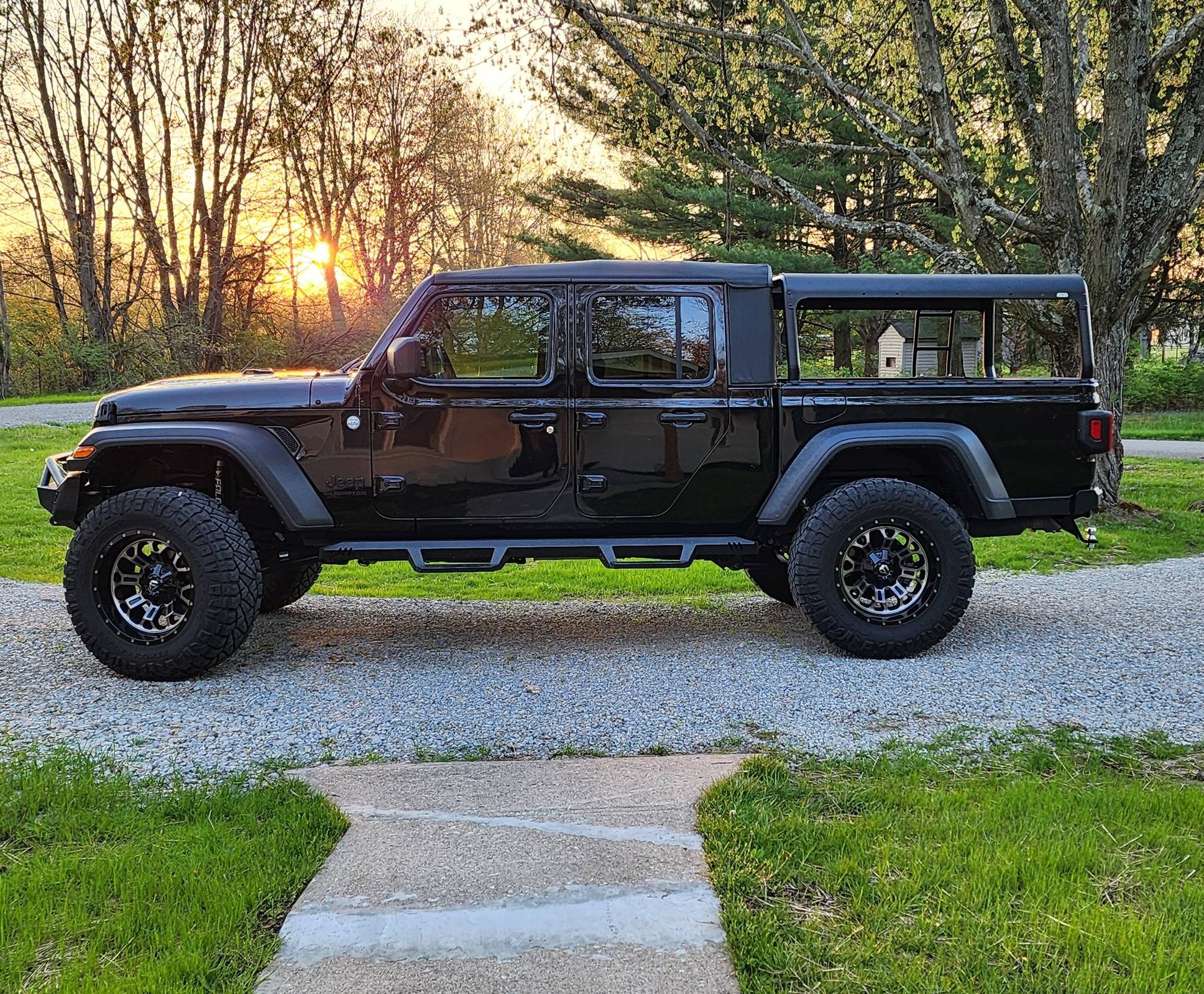

Have you ever ridden in a Gladiator with 20s?
I have a Gladiator with 20s and 35” tires. When people ride in it, they often comment how nice it rides.
