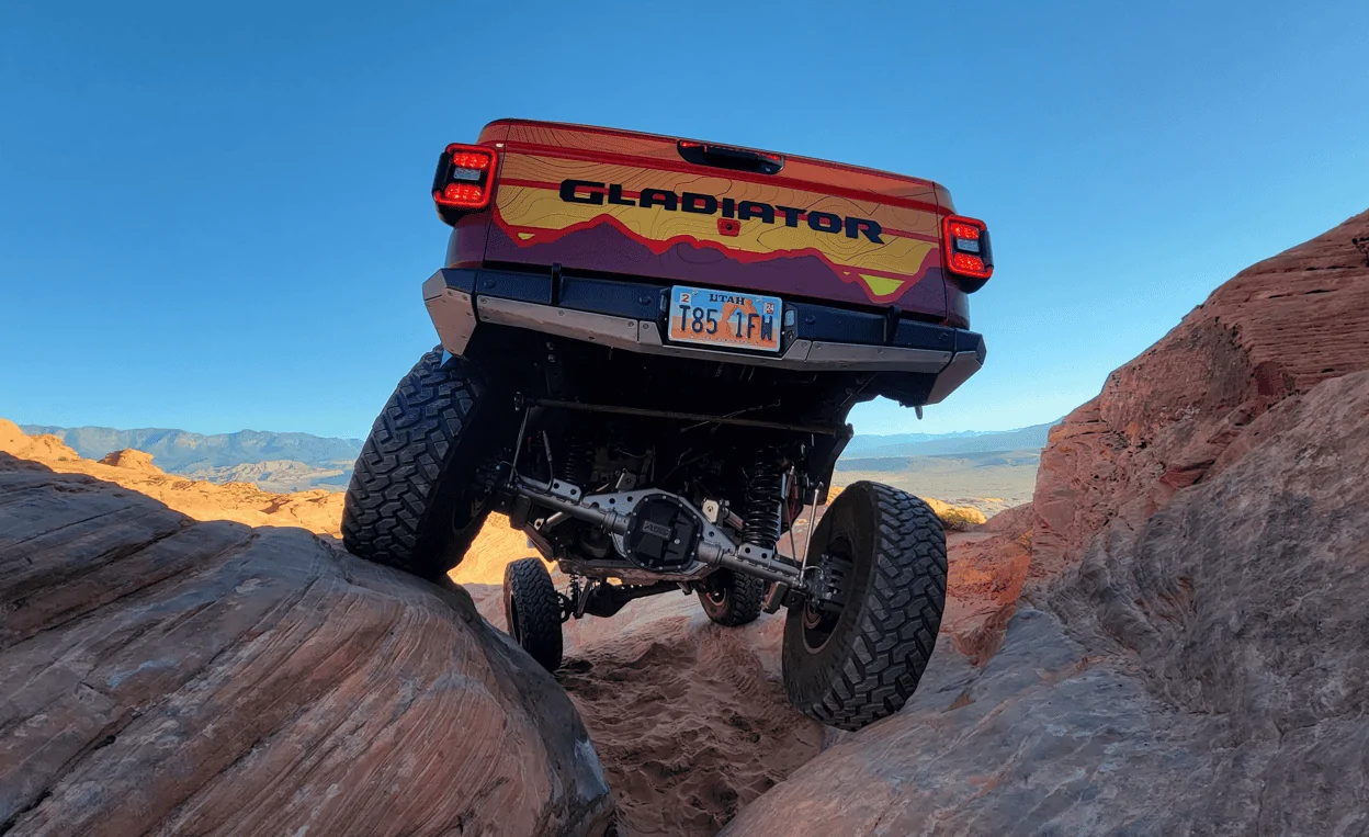

Sorry to bump up an old thread, But to help with your question. The Artec System works with all popular axles We have several Local shops running them with UD60's Teraflex axles and even 14bolts We have them with stock axles in our Diesel and a sterling rear in our Red 3.6L The sterling has an offset diff and there's plenty of clearance around the drive shaft .
