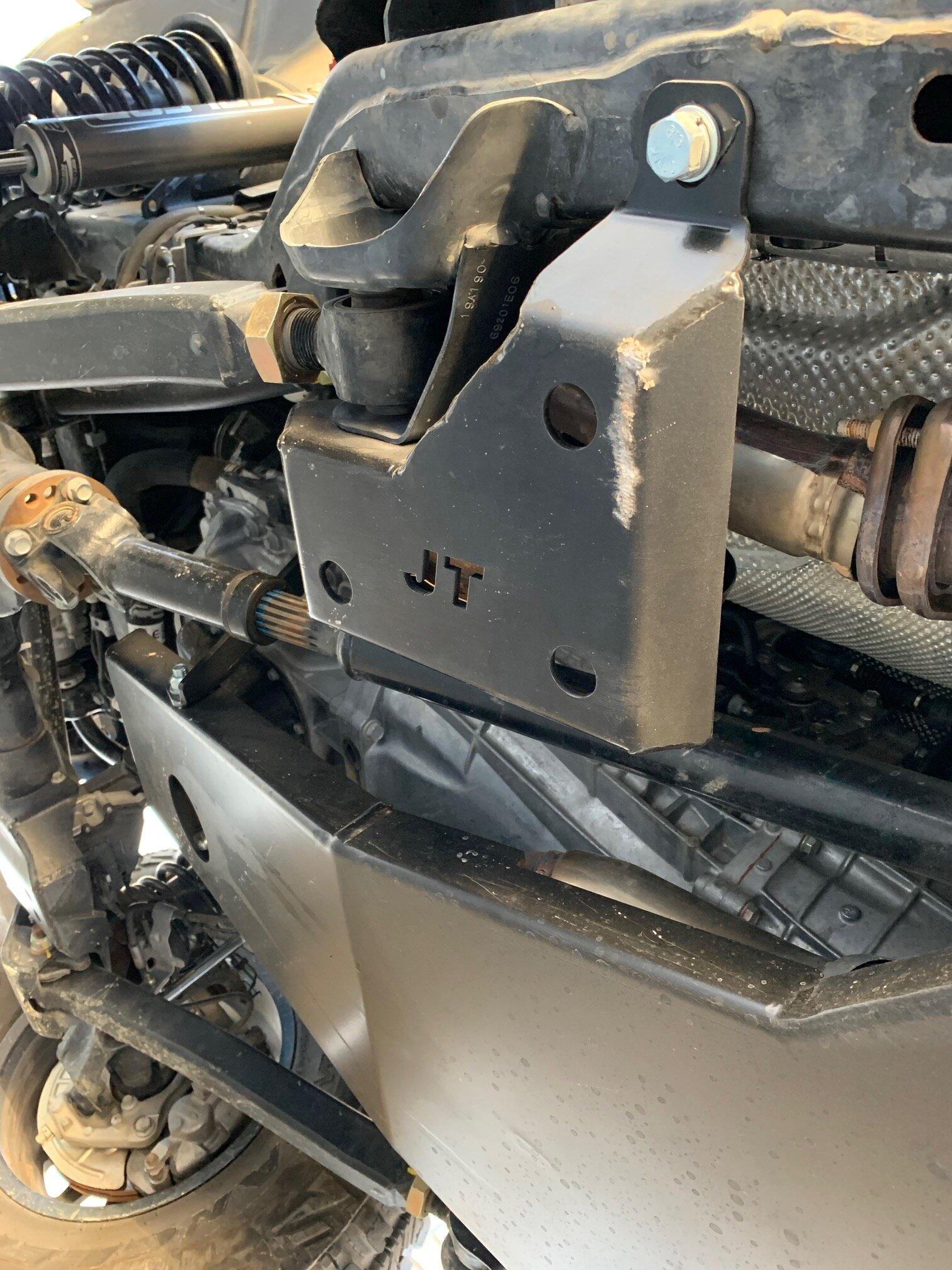

did it though? I’m pretty sure I see that top right screw hole being cracked almost to the edge.
Maybe just the powder coat being pushed aside, but at the very least it appears that the bolt hole may be out of round now. I'd love to see what it looks like if that bolt is removed for inspection. There are several big hits on the leading edge of the skid plate.
And look at the control arm bracket. Not exactly straight where those numbers are stamped. I should look at my own to see if it was straight originally.
In general, a lot of these skid plates are being attached to things thinner or weaker than they are. In that photo of the exhaust loop skid, you can compare the thickness of the skid plate vs the control arm bracket, or the frame itself as seen through the frame holes. The skid plate is beefier than the stuff it attaches to.
Edit: I studied my truck's skid and found that the bolt hole is actually oval so the gap you see in the bolt hole is normal. And what looks like two big hits on the leading edge of the skid are actually welds not hits. My skid has them in the same spots. And my own truck's control arm bracket is not quite flat either, and there is a gentle curve to the edge which shows in this photo's angle.
In general I'd say the skid did its job in this case.

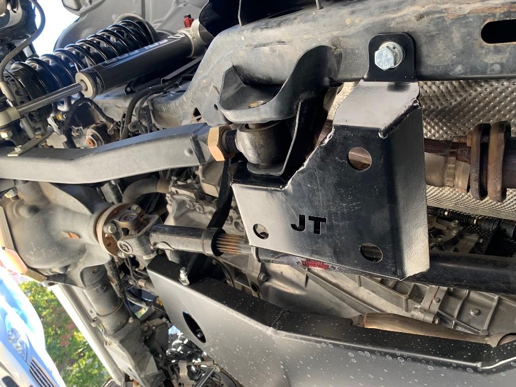

We are doing a "Badge of Honor" this weekend, so, I finally put on the Skid row exhaust loop skid. Fit perfect, easy install. The only work is getting the control arm bolt torqued back up to 180 ft lbs. Nice piece. You torque from the bolt side with a 21 mm socket and use 24 mm wrench on the nut side. It fits in there and wedges against the exhaust as you torque the bolt down. Plenty of Gussets. I like how it says JT on it. Here is a pic.

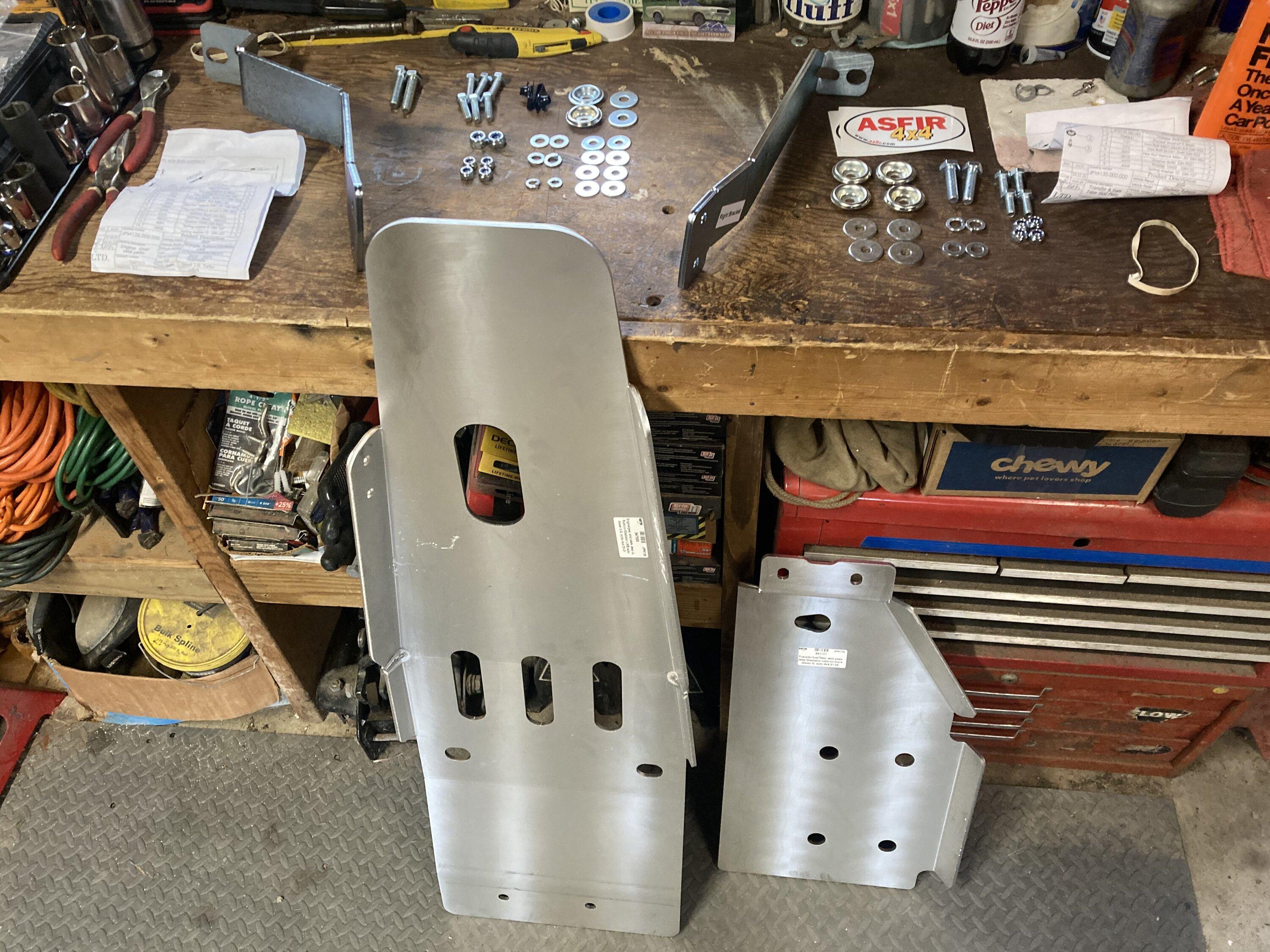

I just ordered the engine/ tranny and transfer aluminum skid set from @ASFIR 4x4. Good price. Made in Israel. Shipping was very fast. And they have them for the diesel and gasser (mine are diesel).
