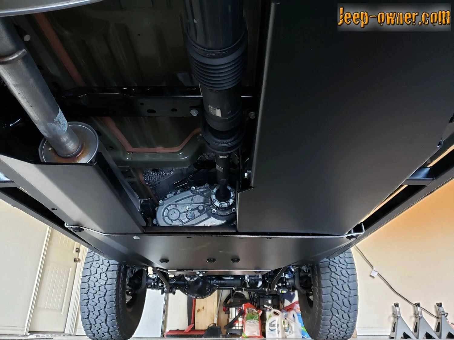

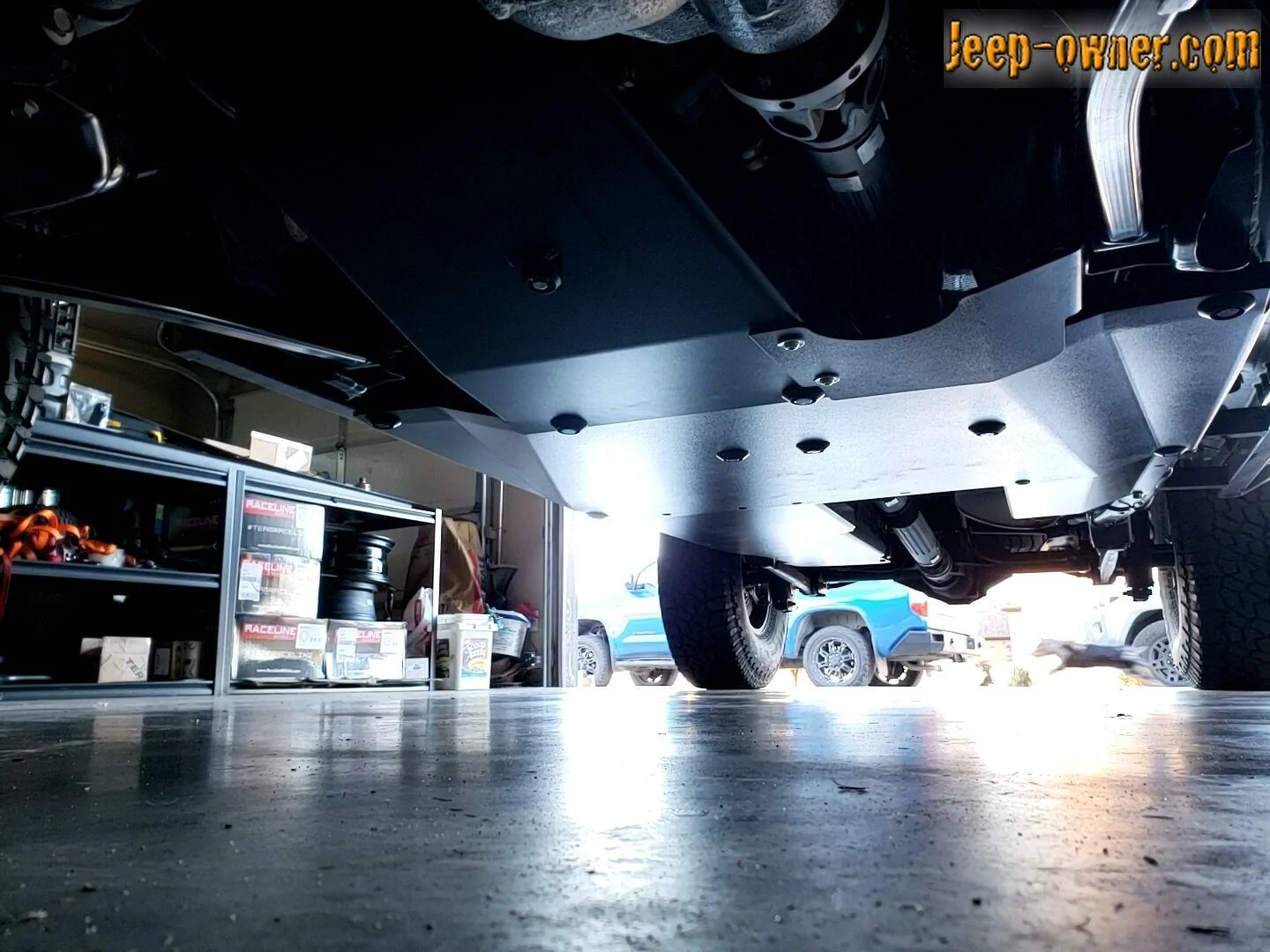

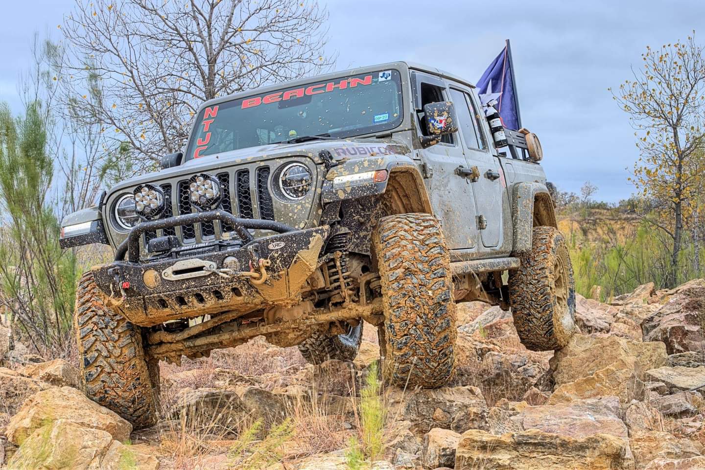

Installed Rockhard 4x4 aluminum (180lbs) complete belly pan skid plates with dual crossmembers today, what a pain...
Other than that, it is installed and quite nice. If I were to do it again, I'd probably go with Artec and hope that installation is easier, but now that they're on I plan on putting them to good use.
Nice man! Might be a silly question, but do you have any idea why they didn’t provide protection for that exposed piece of the exhaust? I know the Motobilt one does, so just sort of curious why/why not.
Probably not a very likely spot to get hit. Your guess is as good as mine, could be cost savings, lack of good mounting solution, no idea honestly.

I went with the Motobilt plates based on Bastage's suggestions and experiences here in this thread.
I will start with temps. All the temperatures that I can monitor stayed in the same ranges before and after the mods including the skidplates. I watched that pretty close for a while. The caveat on that statement is I haven't had them in a Texas summer yet.
On ground clearance. I didn't measure before and afters but guesstimate it is a touch lower than stock by maybe a half inch? I added 5 inches of GC, 3 inches of lift and 2 with the tires. The skids might have taken some back. But and it is a HUGE BUT, I know I am not tearing stuff up when I drag a little or even a LOT now. Second time I had it out I did a rock crawl that most folks in modified two and four door Jeeps wouldn't try.
I think the Westins would tear up quickly with the way I wheel. The smoot bottom slides on rocks but the Westins would catch. I did notice the Motobilt has some vents for mud and water and they seemed to work well.

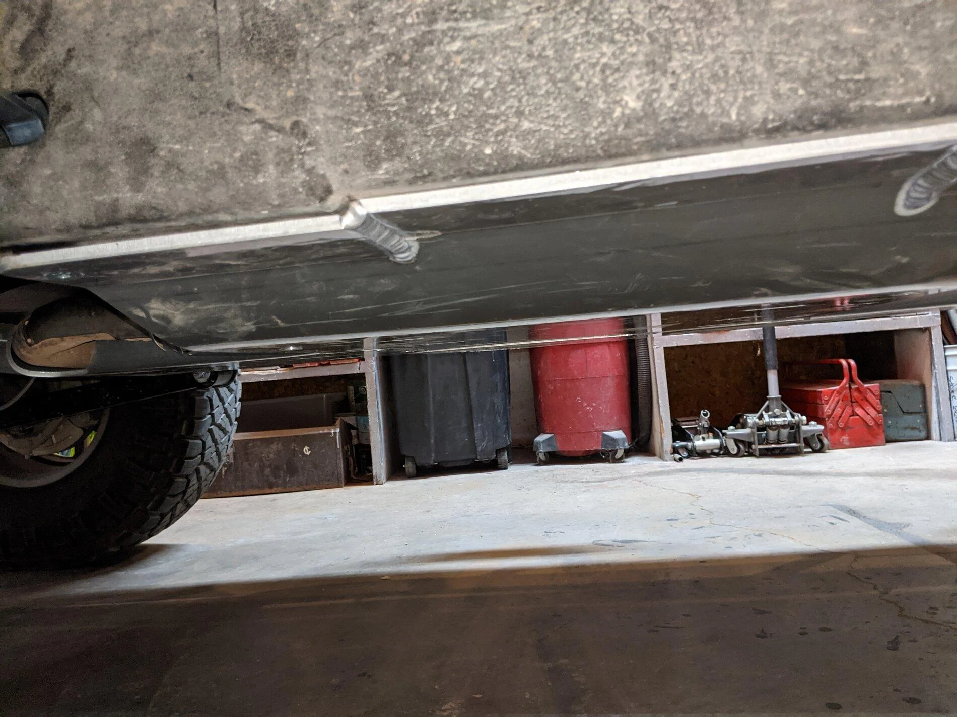

I too went with Artec.... the fit was amazing... millimeters apart in the gaps on the skids.. they all fit tight together.
But their instructions are not for a JT... you would think they could send a guy out with a camera, do and install and write up the parts that are different than the JL? Instead you are left to figure out the positioning of several brackets that are not in the instructions. So the negitve here wouldbe that they don't actually have a set of instructions for a JT. the front skid plate mounts are nothing similar to the JL. The rear gas tank mounts entirely differently than the JL, and there is this strap on the JT gas tank that has to be removed for everything to fit right, but is not mentioned in the instructions at all. So that is the one complaint.
After figuring all of that out on your own... every thing fits very tight, parts are high quality, you really do gain GC! and it is flush mounted on all the fastners.
I treated mine with a teflon paint to keep it slick in the snow, I've hit them a few times... and have no dents... just normal shallow grooves like I get in all skid plates...

looks like the only other exposed parts are the CA hangers, diff and resonator? I'm debating whether to get a "full belly pan" because it looks like a lot of the stuff they cover doesn't actually need protection.
Depends on what you need but if you're going with most body pans, the fuel tank skid stays in place (as Jeep only straps one side and the other side of the tank is supported by the skid) so you're adding a lot of weight. Artec doesn't do this so their aluminum system only adds like 20# to the truck with nearly full protection. It's the one dig I have at my Metalcloak skid system and I'm definitely going to find a way to remedy it at some point.
For me it's not 100% protection but also that it creates a mostly flat bottom that slides over rocks instead of just getting hung up on things. Probably less important if you're just doing forest trails but here in the west it's pretty effective with this long ass wheelbase. If I were still in VA odds are I'd just have gone with a few aluminum skids for the front half.

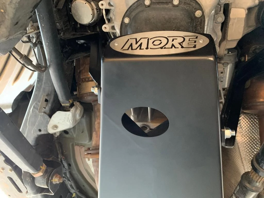

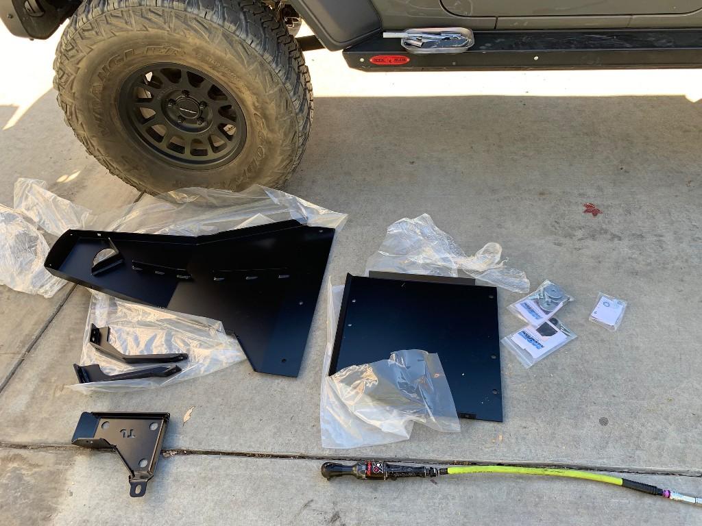

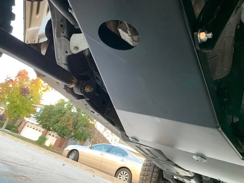

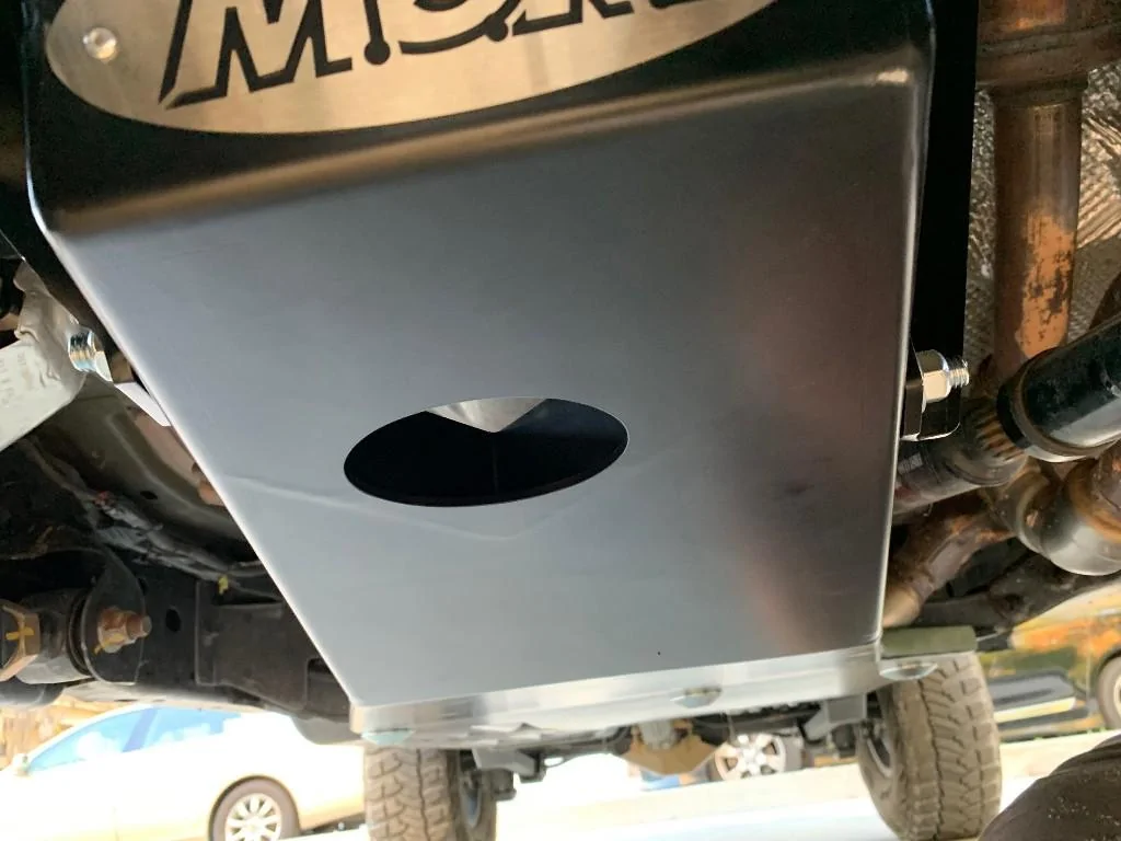

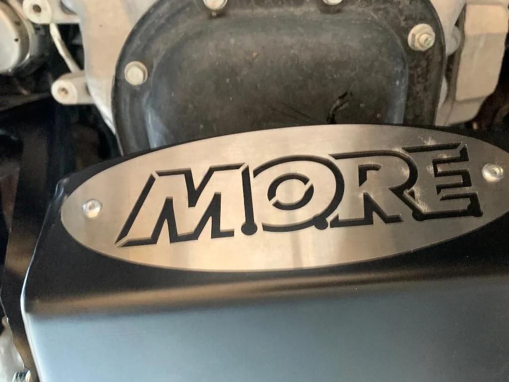

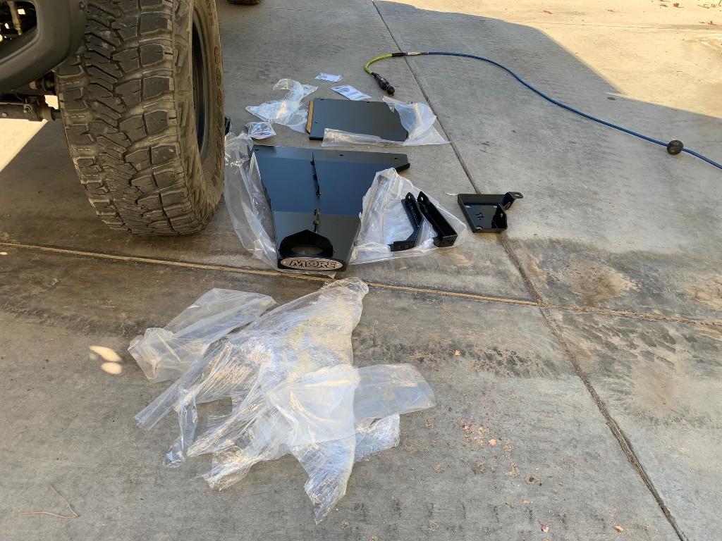

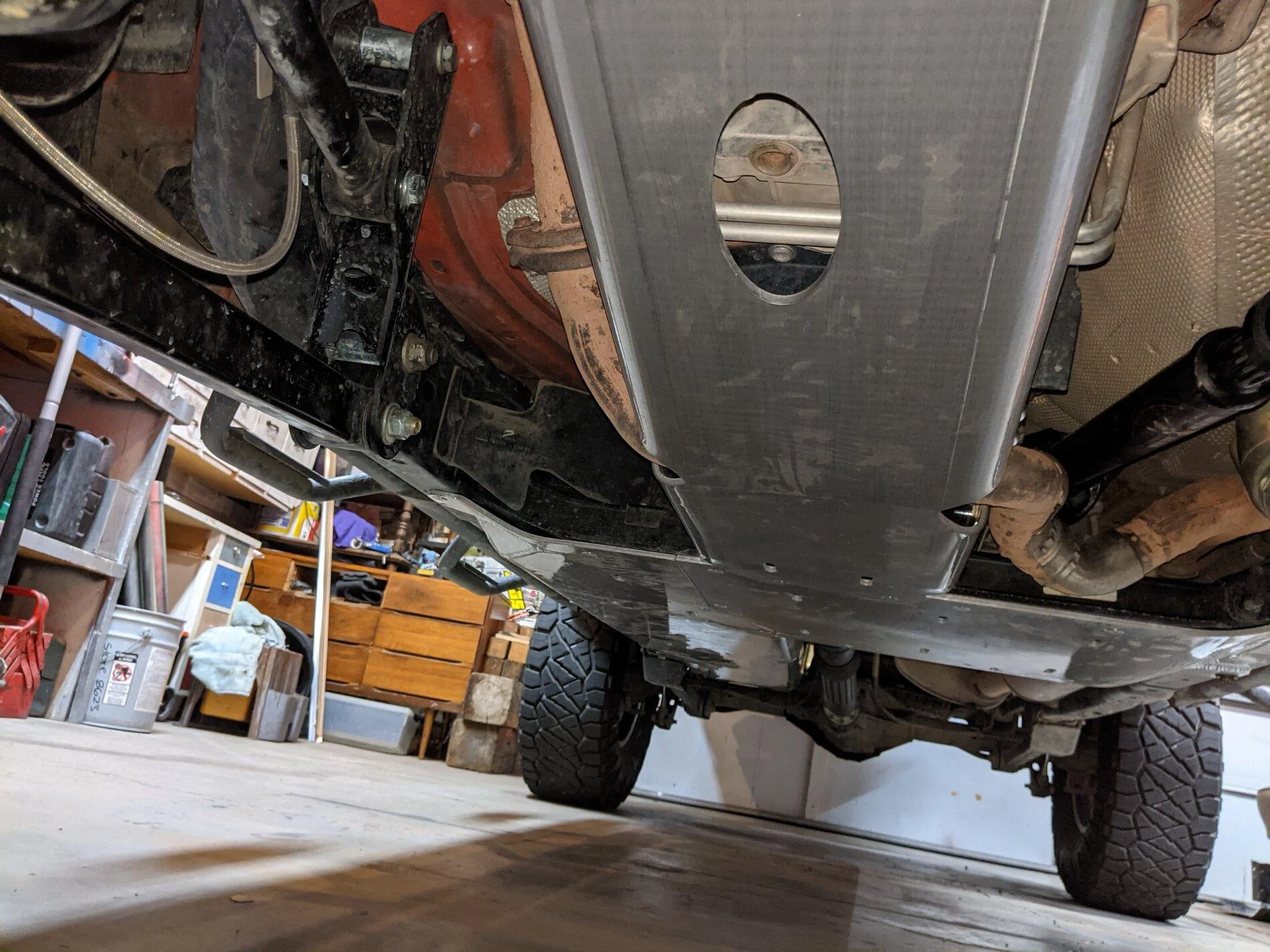

I recieved the M.O.R.E. engine, tranny, transfer case skids and the skidRow exhaust loop skid. Installation was simple and fast. The big steel engine, tranny plate is kinda heavy, but, I did it all myself under the truck without a jack. You may want to use your jack to hold the plates up while you put the screws in, but, I did not need it. Fit and finish were great. The braces and skid plate are updated for the JT relative to the old pictures on the website. For the braces, there is no loosening of the motor mount bolt. There are two motor mount bolts with lots of thread sticking out the bottom of the motor. All you do is slide the braces on and torque flange nuts on. Super easy. You can see the geometry of the braces in the pics below. There is also a full V-notch for oil changes.
Here are some pics without the exhaust loop skid installed.
