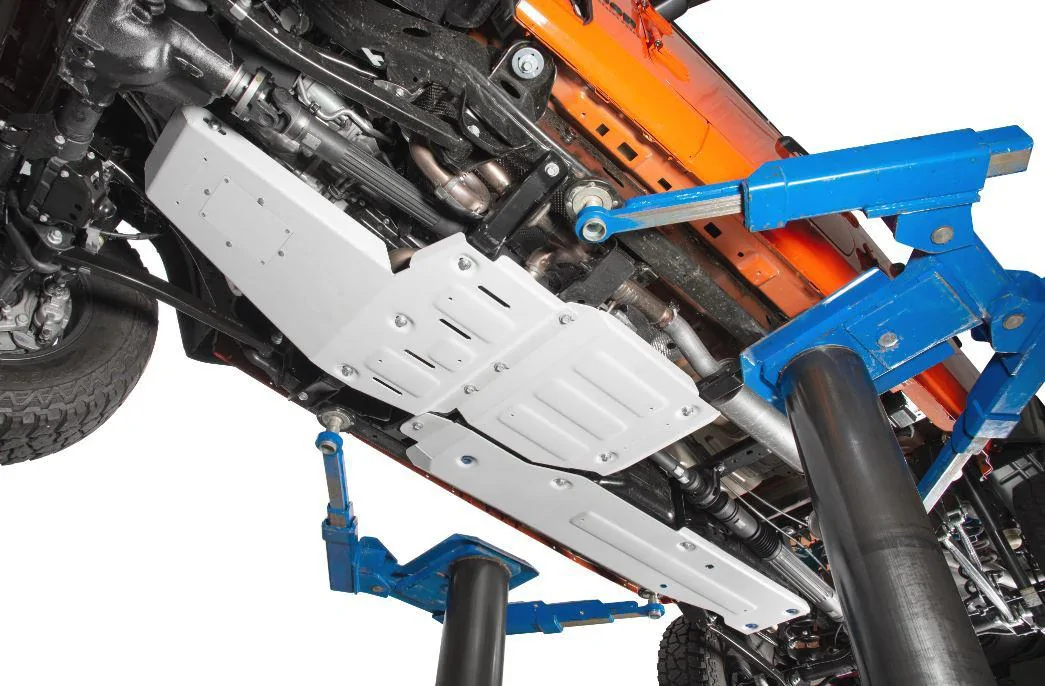

This is the Quadratec system I installed. Install was easy. Parts were made in Russian federation. I waited months for all 3 shipments. It came with 2 replacement cross members.

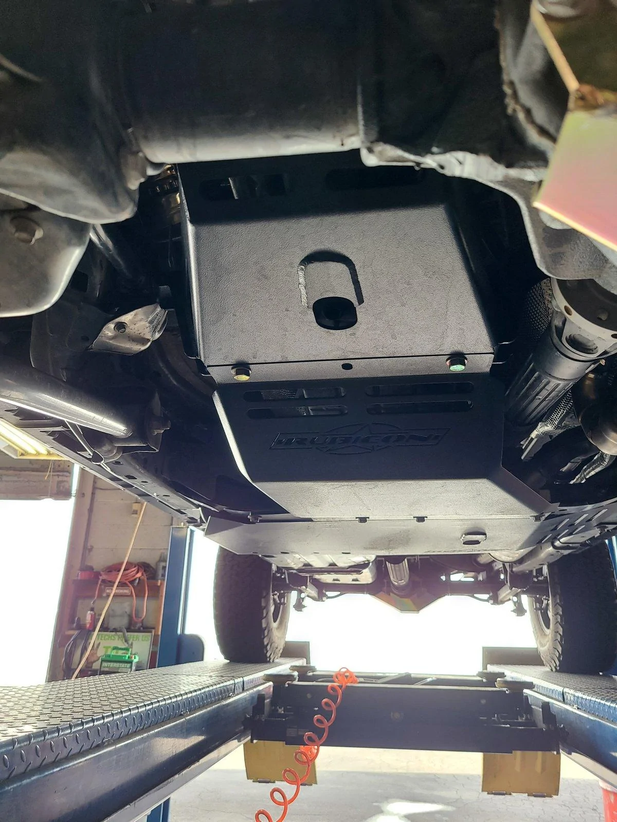

Finally got my Rubicon Express skids on. Debating on putting on the gas tank skid to save some weight. Have heard the factory tank skid is decent. Will keep posted on how well it takes a beating.
What happens to the front crossmember? On one site it calls it a trans skid with cross member. In the pics it appears to be gone.
40,496
54,007
Probably out of extra tank parts........ J/K
Looks like good coverage and well-anchored.
