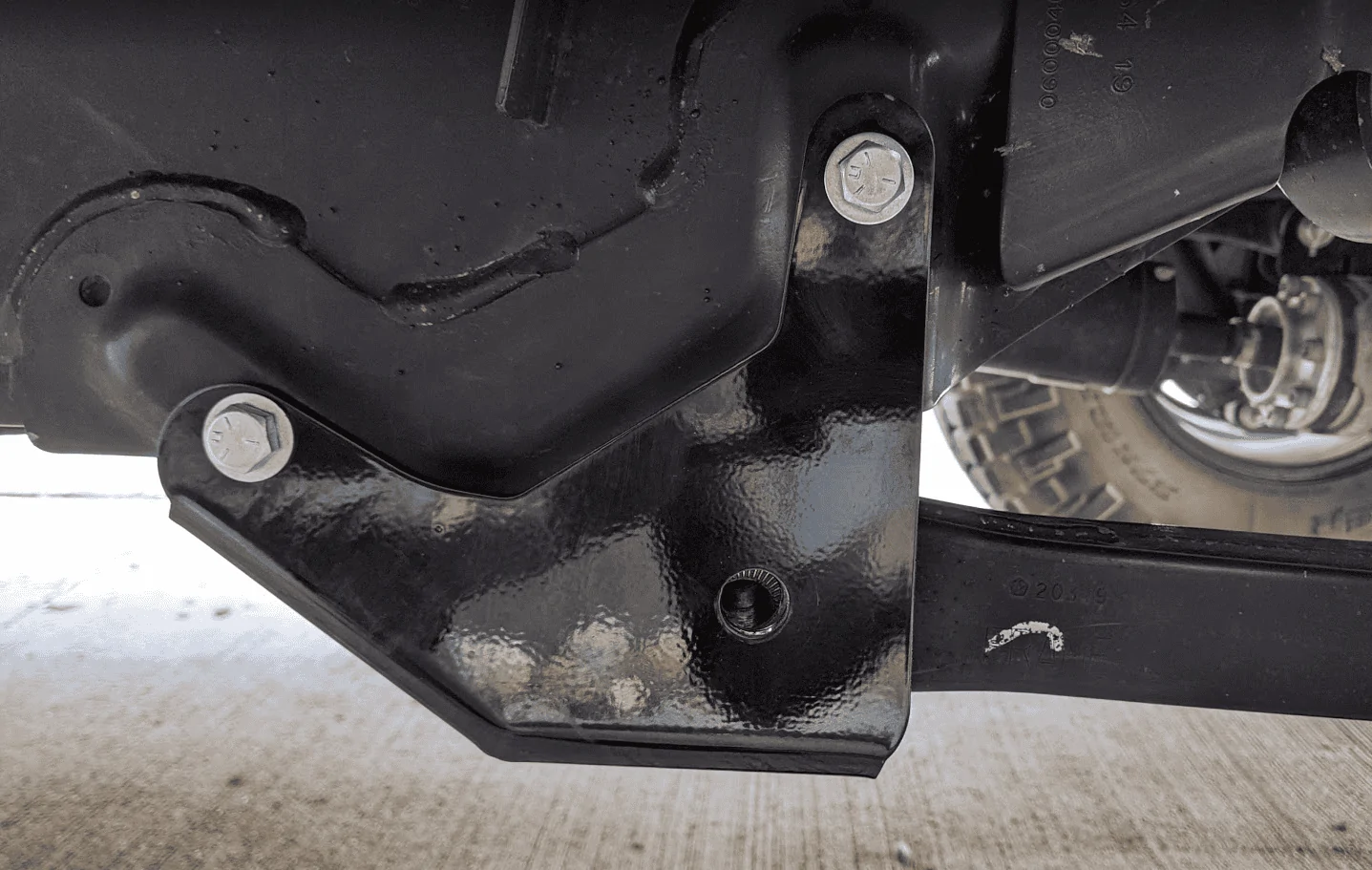

I have them and simply had to enlarge the forward hole by one bit size... no elaborate grinding or elongation needed. Yes, I know it's still a slight modification but nothing 1 minute of your time can't remedy.
I simply think that people are not leaving the (2) small bolts extremely loose during install. I kept them loose enough for the entire bracket to move around. Below is a pic of how very close the skid hole lined up with the OEM LCA bracket hole... then I just needed to line up the arm hole itself.
I wouldn't be deterred by the negativity in the threads. I think they are worth it.

I didn't bother to drill anything, I left the front bolt out. It's not doing a dang thing the other two bolts aren't taking care of.

I have the Rock Hard 4X4 LDA skid plates. Don't have them installed yet, but looks straight forward.
