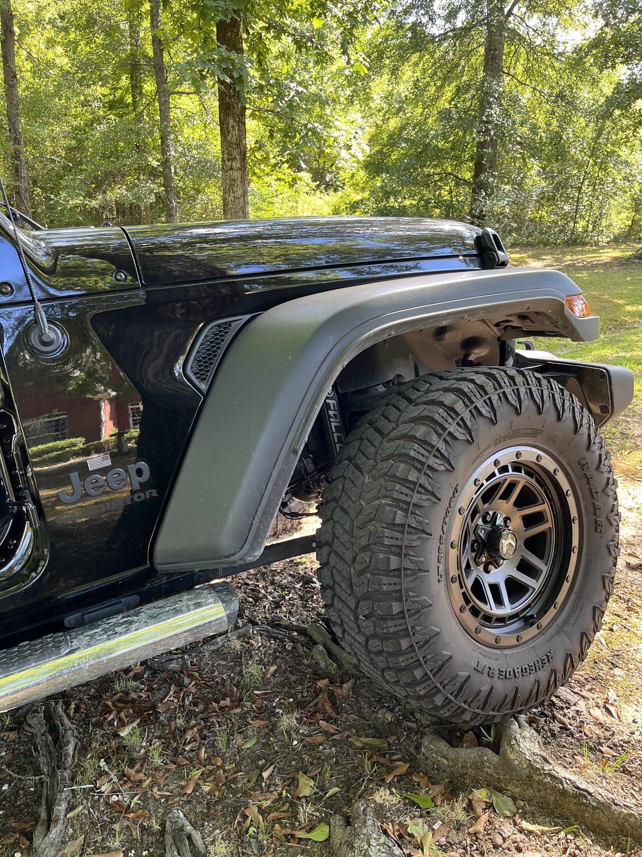

My JT sport Max tow did this bad when I first got the Jeep. Once I added a level kit, new Falcon shocks, bigger wheels and tires the problem of jumping and skipping at highway speeds went away. I really think the Falcon shocks helped the most. Made the truck feel planted to the road.

Running 295/70r17 RT tires, wheels are 17 x 8.5 inches with a -6mm offset. Teraflex leveling kit full 1.5” & Falcon SP2 shocks set on soft.
