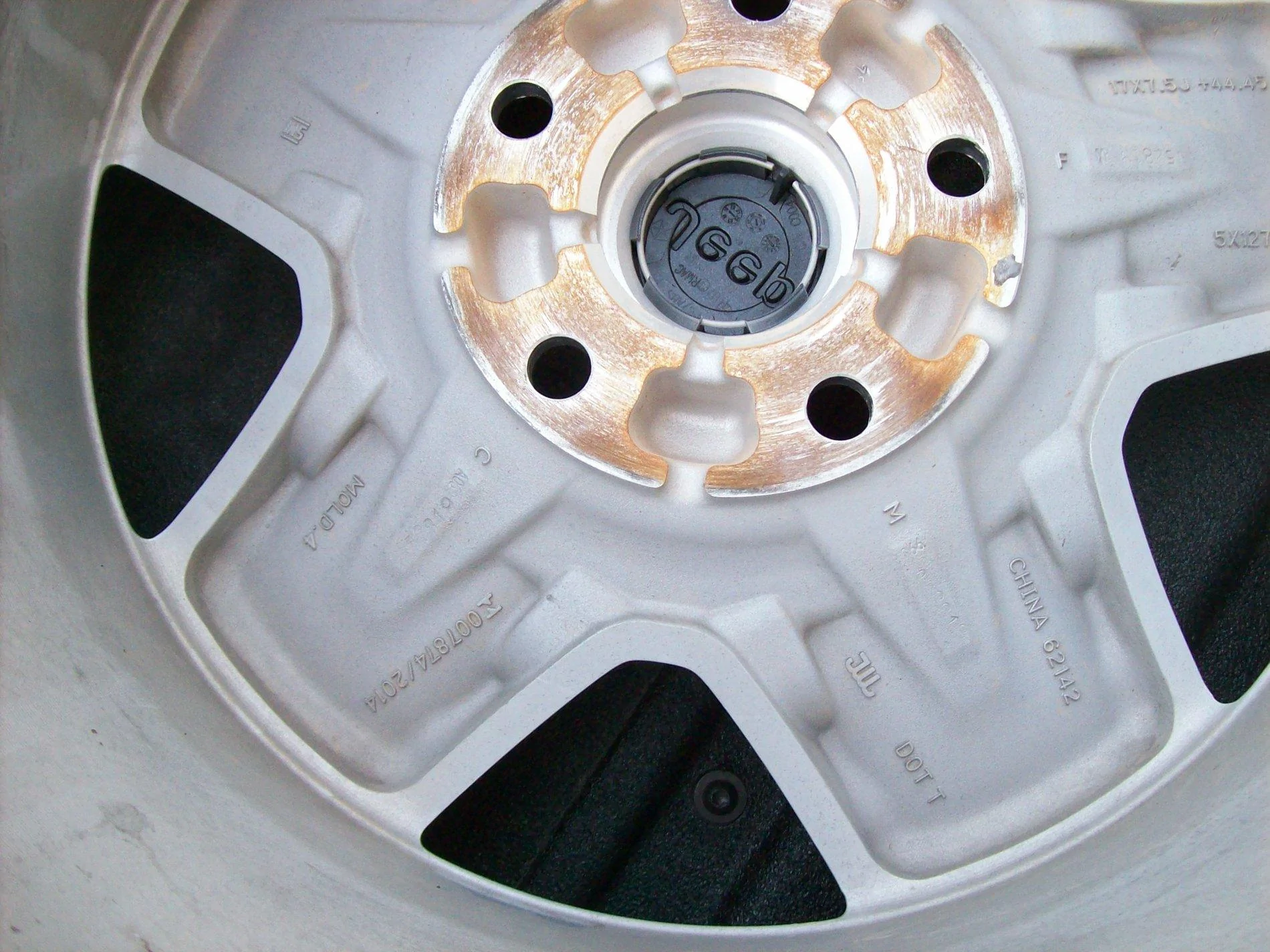

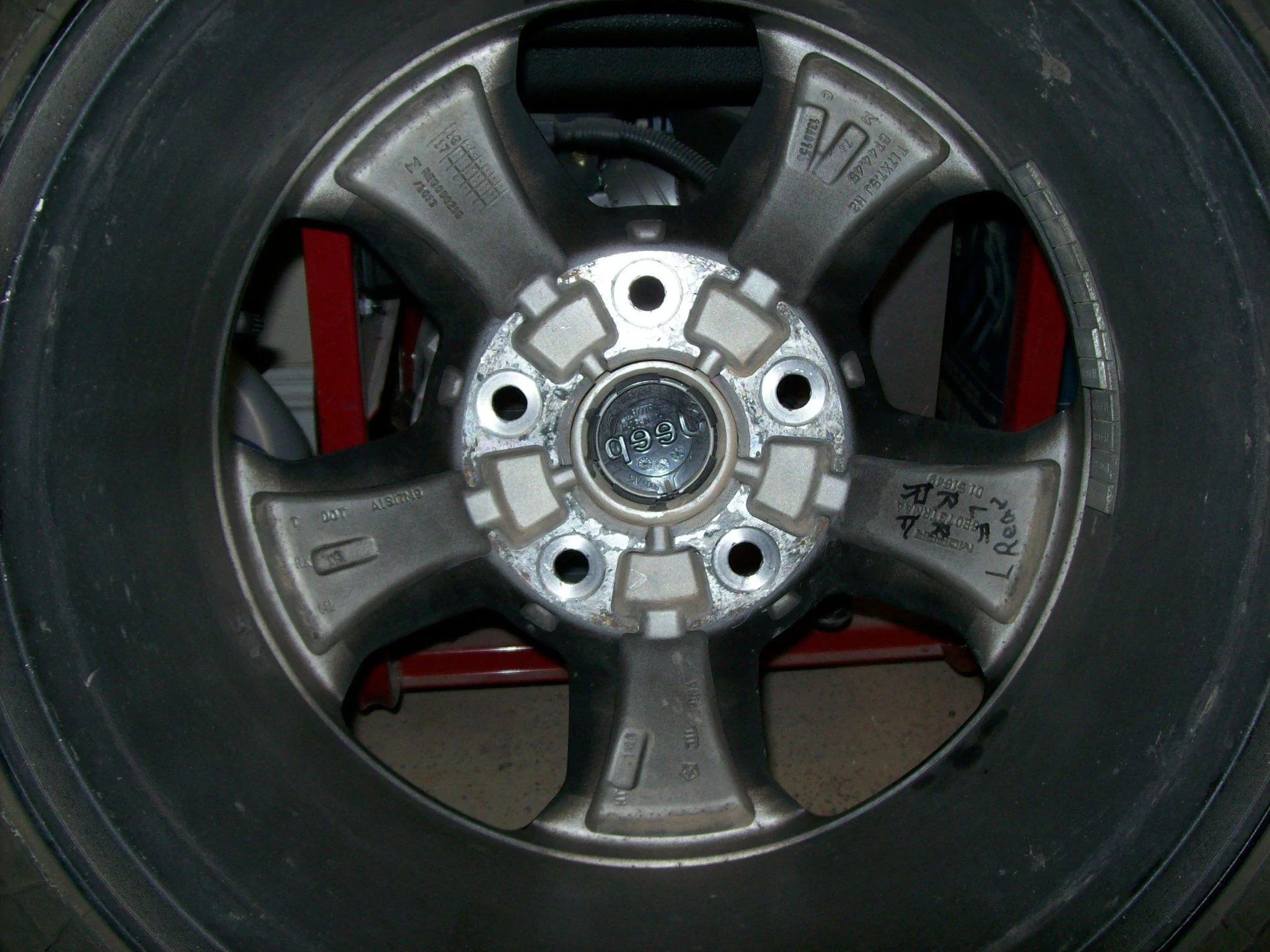

He needs to use his lug nuts for the proper 1/2 x 20 thread of a JK. Make sure there are no retainer clips on any of the studs that the factory used to retain the brake rotors during assembly of JK's. JK wheels have reliefs machined into the mounting surfaces to accommodate those clips. JL and JT don't use the clips and don't have the reliefs. First photo is a JK wheel. Second is a JT wheel mounting surface.

Thanks for the help. I’m pretty sure it’s the retaining clip issue. You would think a shop mechanic could look at that and see it. I’ll check it when I get by his Jeep. I would advise him to buy better JK lug nuts but want to see if we can use his stick ones first.
