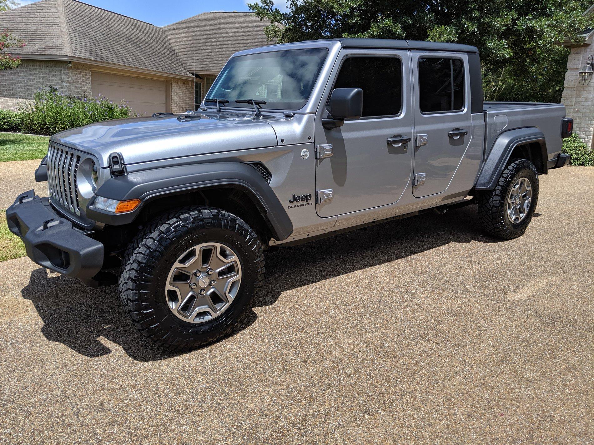

I took the wheels & tires off of my 2015 JKU Rubicon & swapped them out with ,my 2020 gladiator Rubicon, already had 35 x 12.5 BFG KM3s Working out fine.
Mkay
Mkay
Michael
Jun 9, 2019
2022 Gladiator Mojave, 2001 Wrangler
MKay, did you have to use spacers with those wheels, if so what size.
Thanks ?
Sorry, bud just seeing this.. no spacers needed.

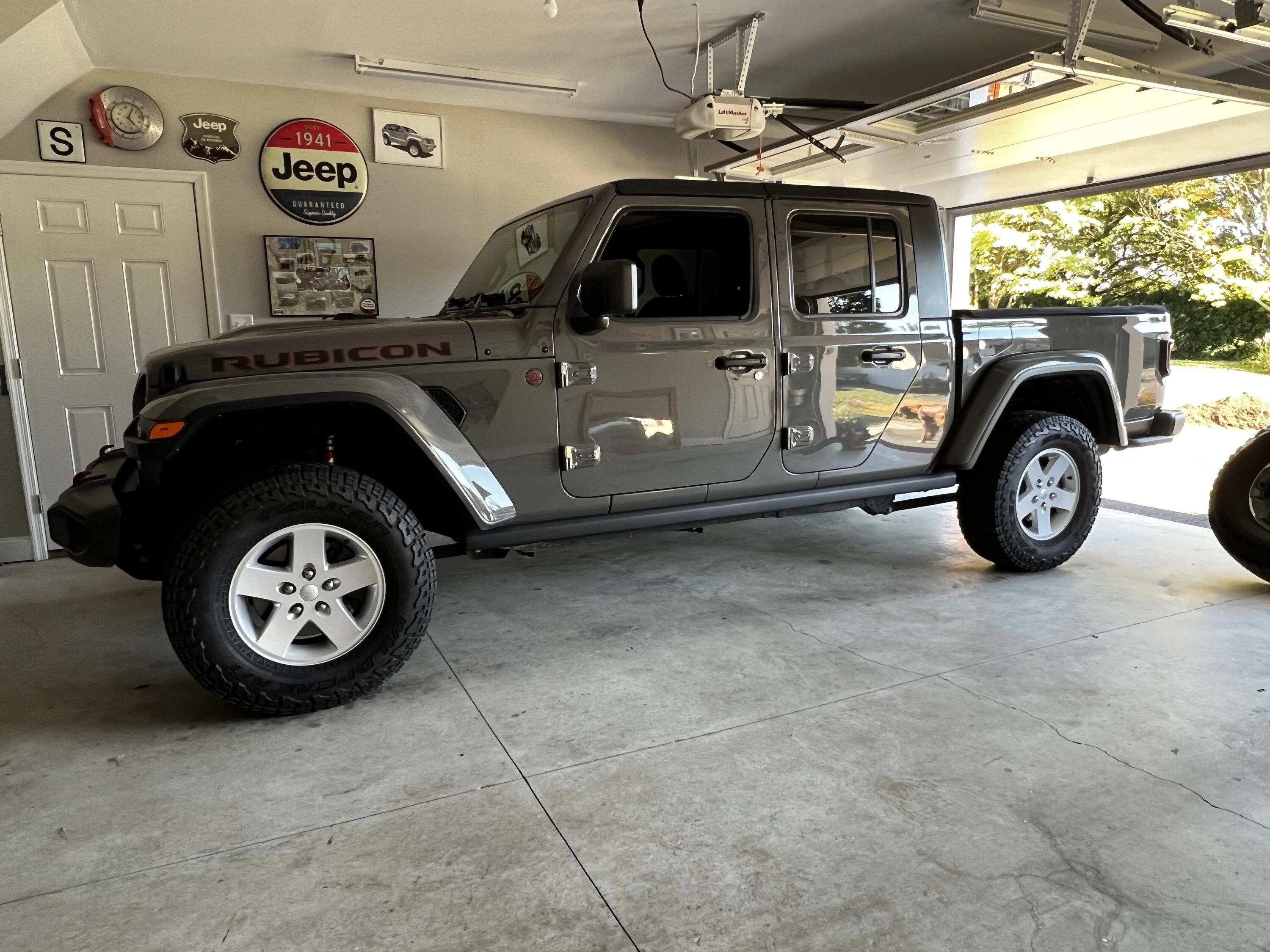

While waiting for new wheels to arrive, I had to throw on an extra set of JK wheels I had lying around. No issues with rubbing with factory size tires.

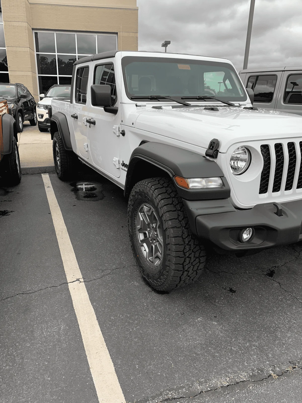

So, seems my experience was different than most. I tried to swap out my stock 2021 (Texas Trail) wheels for 2016 Wrangler Sport stock pull offs (thought it would be nice to put most my highway miles on the Wrangler AT's and swap out for the Gladiator mud tires when going out to play). The front went on fine, but the rear callipers scraped the inside of the wheel. Checked the front again and realized the balance weights caught when trying to turn past the calipers. I don't know what is different between what I tried and what others have done, but I would highly recommend you try before you buy if you want to try wrangler wheels on your gladiator.
