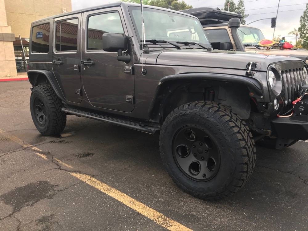

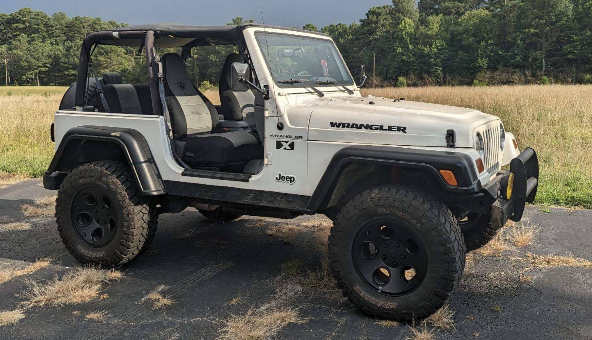

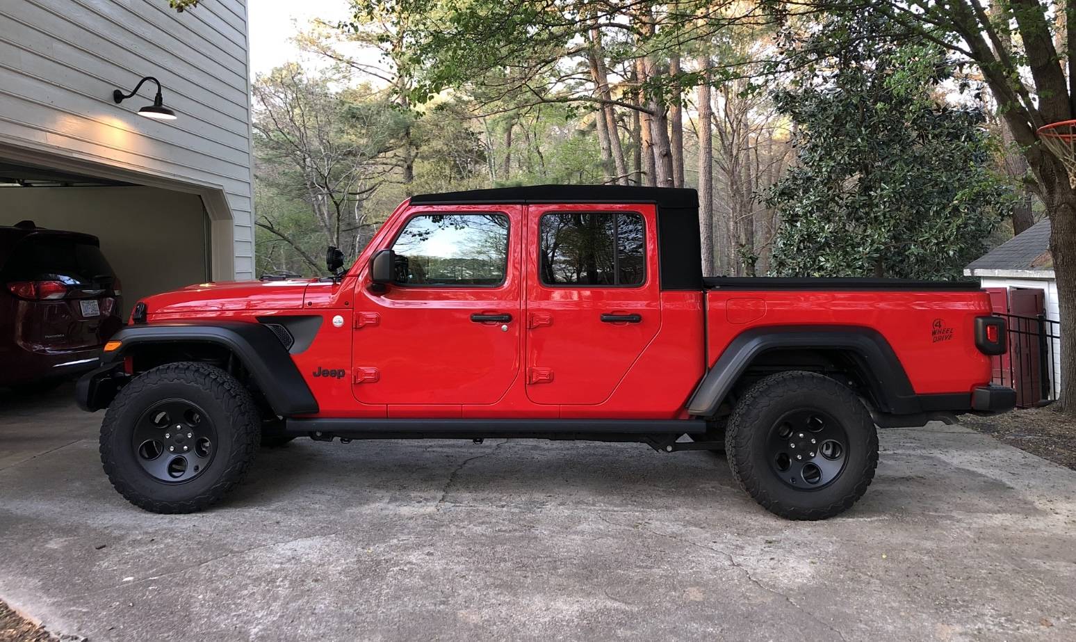

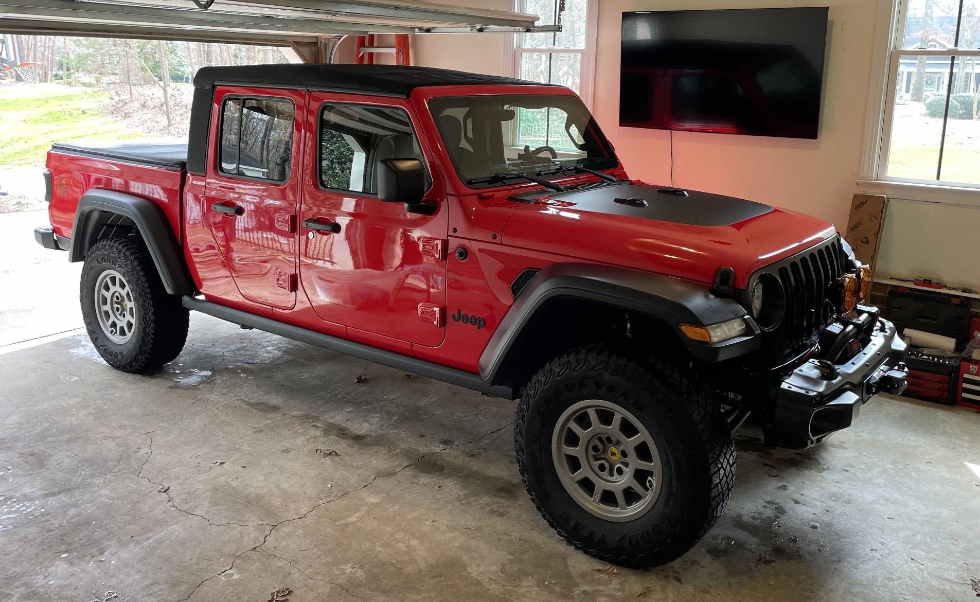

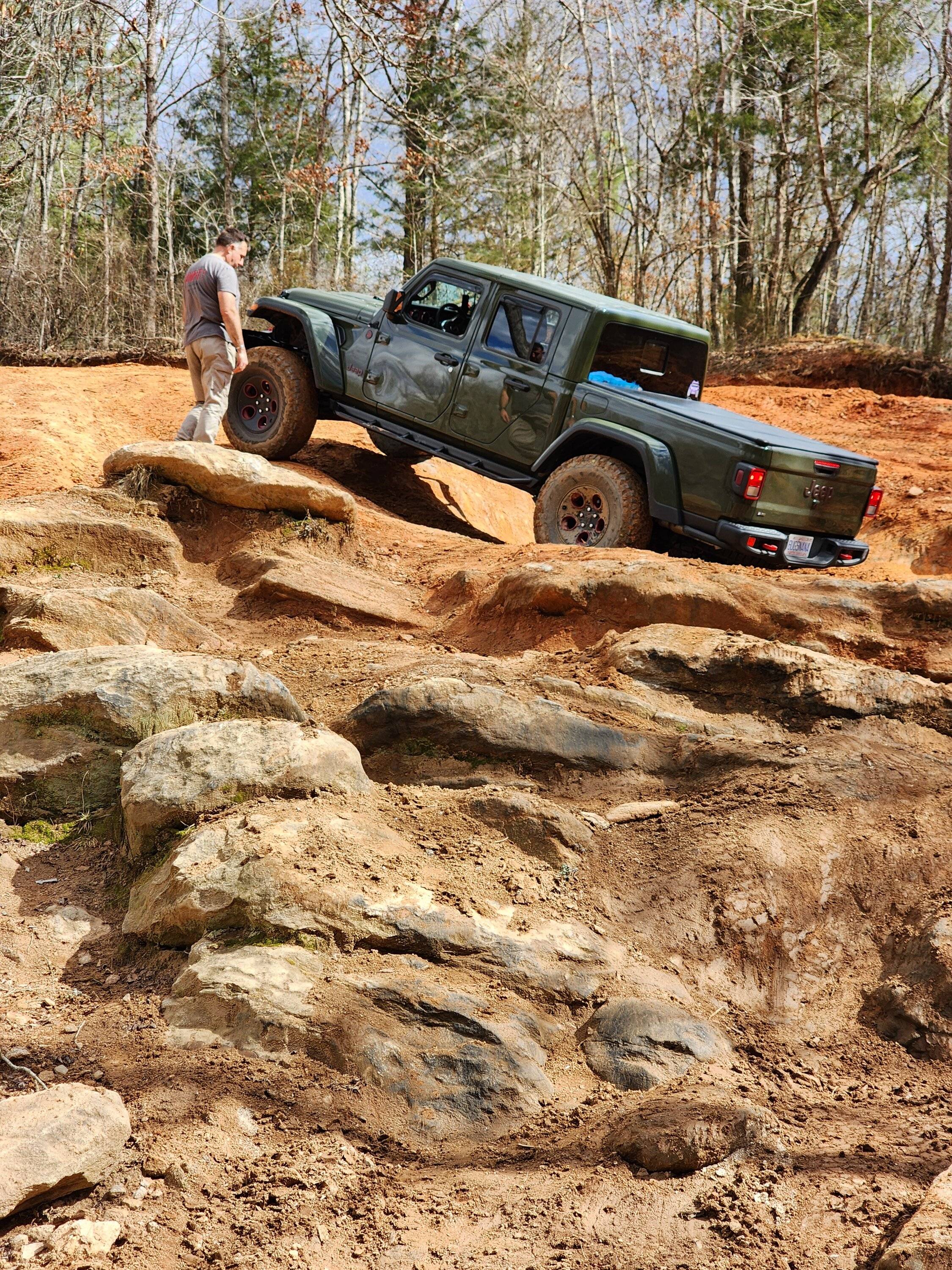

Nice find! They will work great. I previously ran them and gave them to a buddy who is running them on his TJ. I'm currently running the same JK spec in a salta

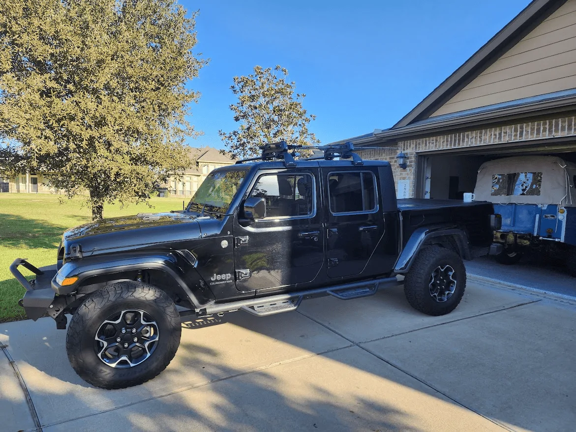

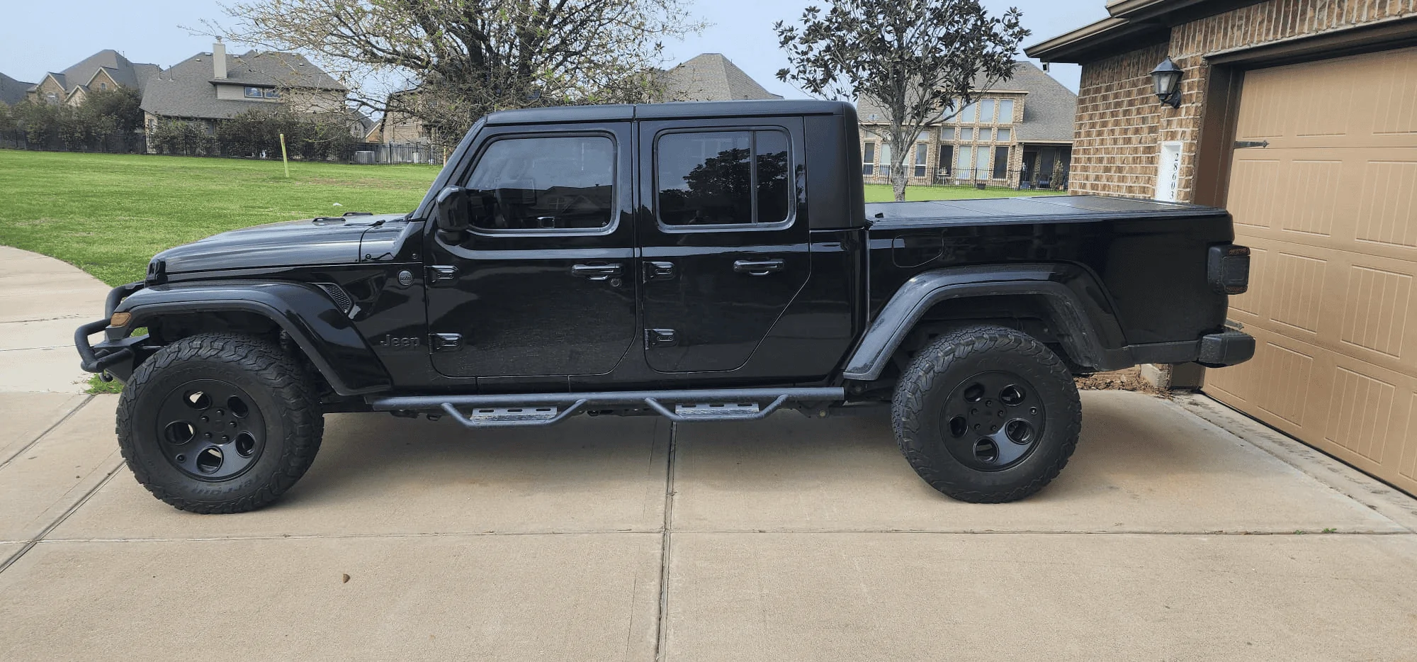

Since searching this forum for the AEV Savegre will inevitably lead to this thread, I figured I'd post an update. Today I mounted the JK Savegre's that I scored last week. It took a week because I was seriously considering powder coating them a gunmetal color or a darker bronze to jut mix things up. I didn't want a black Jeep, and I certainly don't like the black on black on black trend of late. But today I decided to just roll with it so I could see how I liked the wheels before I committed to changing colors. Then there is always the option of putting them on my wife's Sting Gray Rubicon...which I know would look damn good.
So here is how it ended up. While I normally hate black wheels on a black truck, I think this looks much better than I thought it would.
Jeep Gladiator JK AEV SAVEGRE Wheels on JT 1709927357226

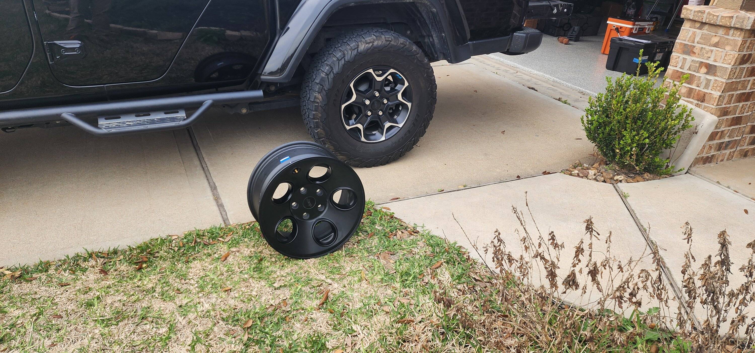

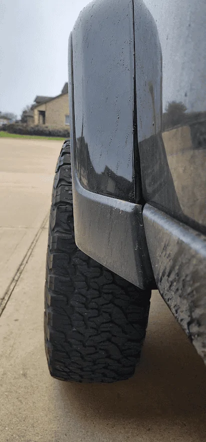

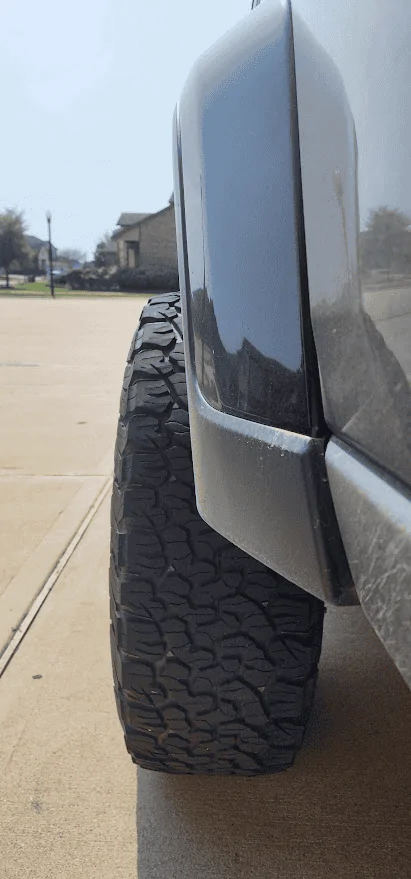

I knew offset would be a bit of an issue. I calculated that the tires would stick out 0.6" (15mm) further than the stock wheels. I was wrong. I based my calculation off the AEV Savegre II spec, not the OEM spec. Somehow I wrote down the wrong specs when I was comparing. So what I ended up with was tires that stick out 1.33" (34mm) further. Pictures below.
OEM Rubicon wheels and tires with +44mm of offset.
Jeep Gladiator JK AEV SAVEGRE Wheels on JT 1709930656089
AEV Savegre originals for JK, with +10mm offset.
Jeep Gladiator JK AEV SAVEGRE Wheels on JT 1709930764853
I'm not particularly thrilled about the offset as it sits right now. But, I didn't mind the offset based on my original calculations because my intent has always been to change the tires to Mickey Thompson Baja AT in 255/85/R17...aka the pizza cutters. I'll make the change when these tires wear out, which should be in about 10k miles. That tire is 1.2" thinner than the 285/75/R17 that is on their now, meaning the outer edge should move in about 0.6", or half the difference of the tire size. I can live with that.
