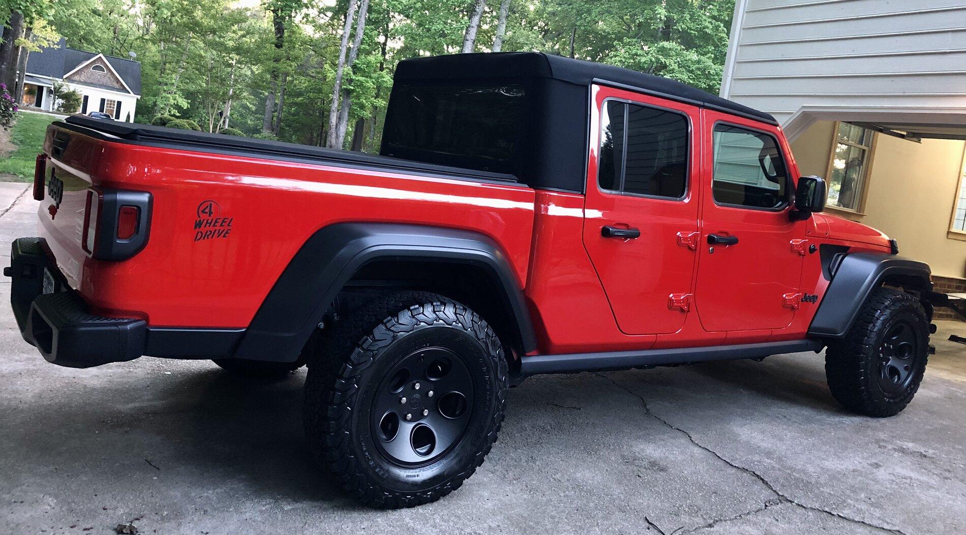

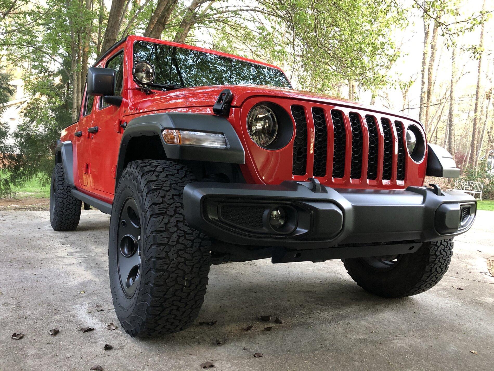

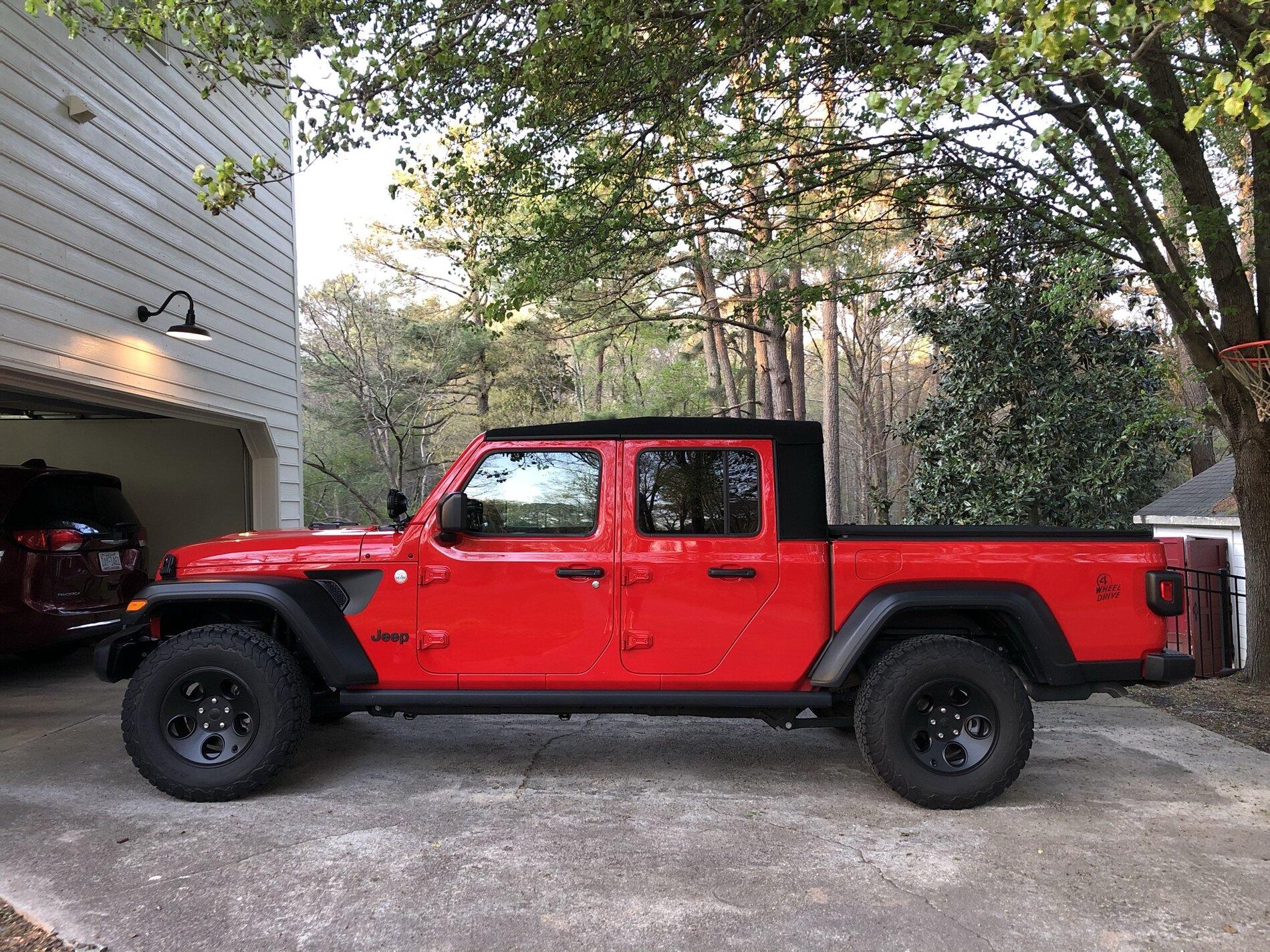

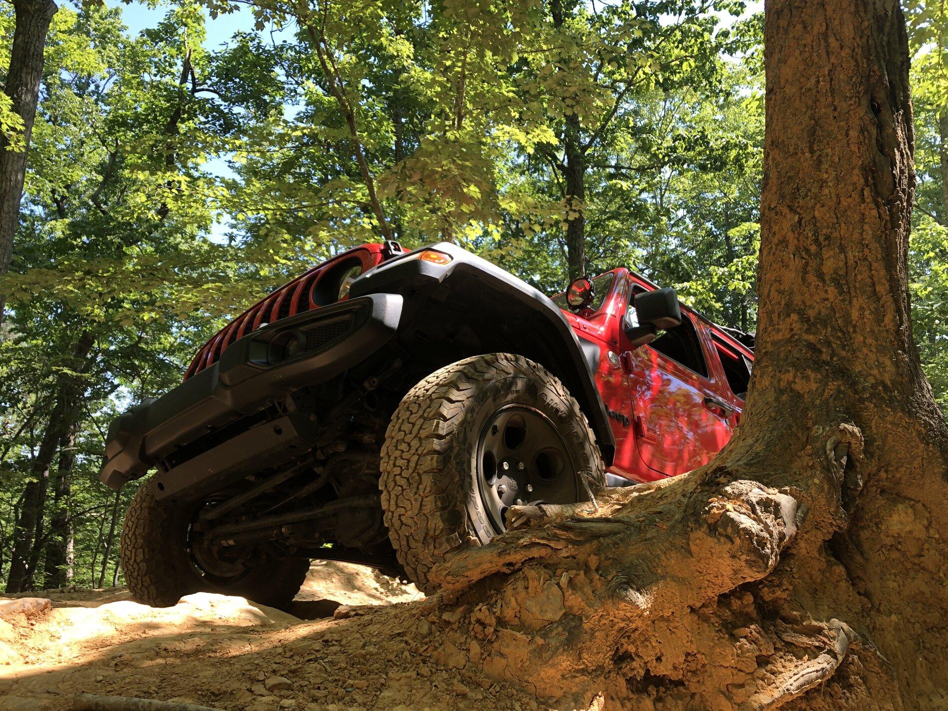

I have OG savegres. OEM lug nuts -barely- fit, but they do fit
these are on 285/70/17 bfg ko2's
