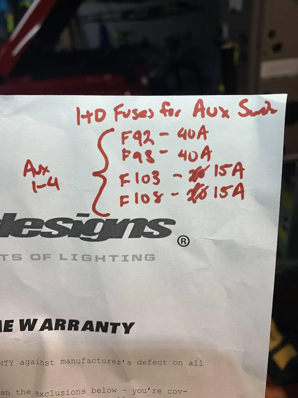

If they provided 10 and 20 amp fuses, it's possible they only used wiring rated for that, so not a bad idea to swap as you said.
The factory aux switch fuses? If you have factory installed switches, it's in the fuse panel. Double check, but this seems to be accurate:
