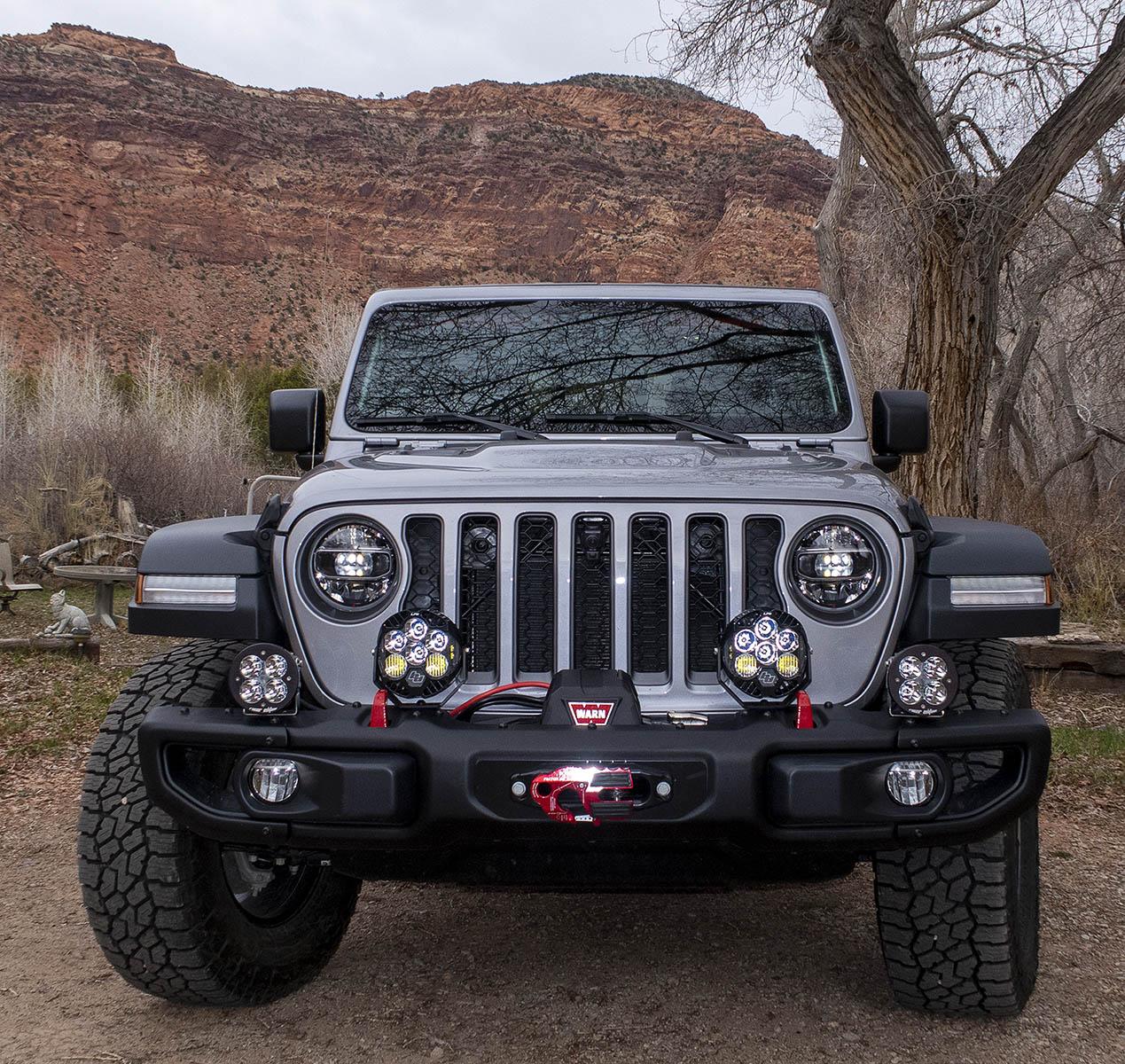

BD LP6 Pros and XL-R Racer Edition Spots mounted directly onto OEM steel bumper using existing bolts:
Jeep Gladiator Grill Bar and Front Bumper Lighting for 2022 Wrangler 392 Spots

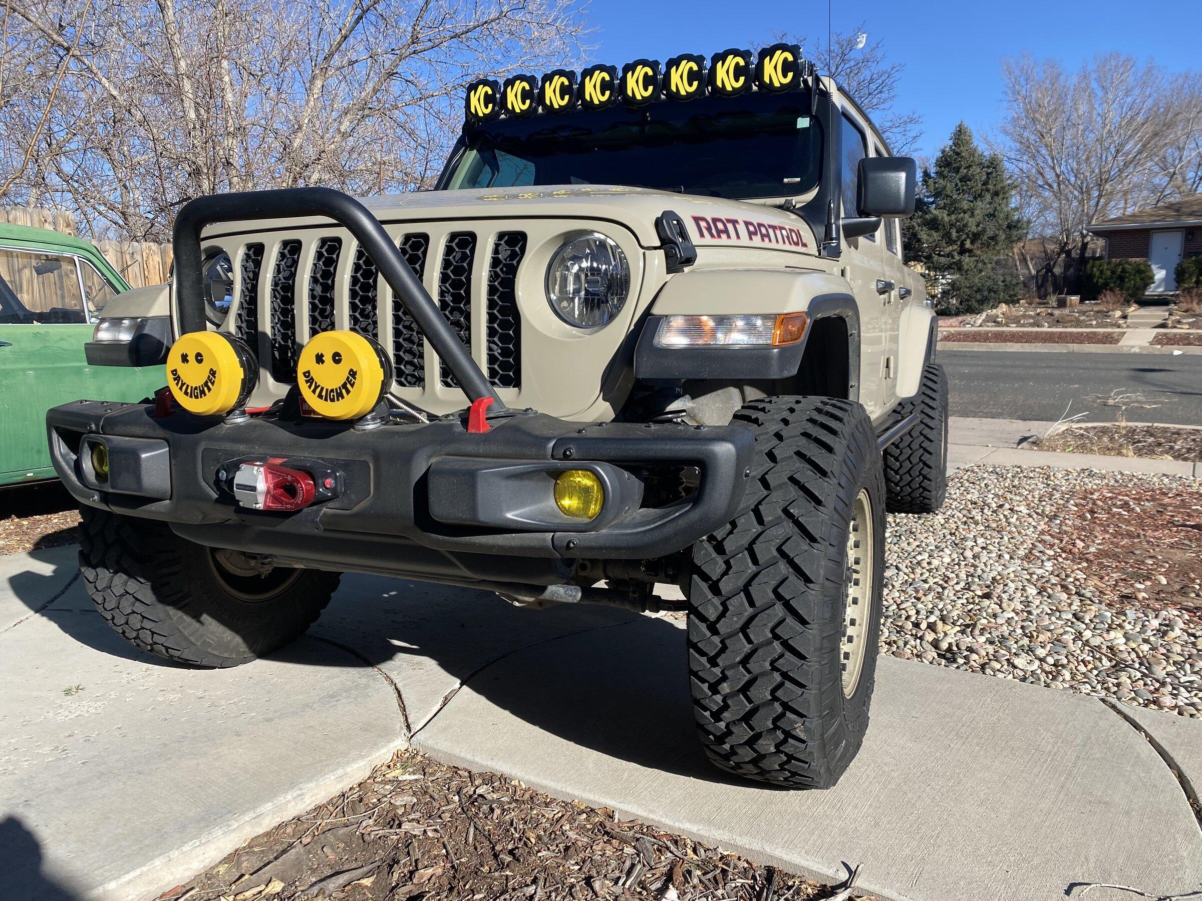

I went with a hoop that bolts to the factory mopar. I used a step bit to punch out two of the bolt holes. Quite happy with my set up of winch, lights, hoop, and hooks.
Jeep Gladiator Grill Bar and Front Bumper Lighting for 2022 Wrangler 392 IMG_9681
