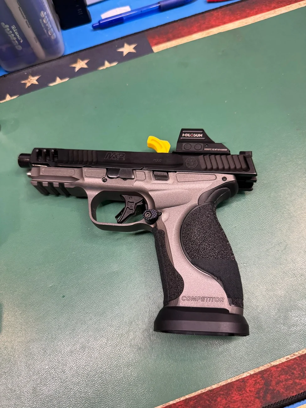

My newest range toy….. M&P 2.0 Metal Competitor. Have about 1000 rounds thru it already. Installed a 14lb recoil spring /guide rode this week but haven’t shot it yet.
I was having eject/feed issues with the husbands reloaded ammo (lighter). I also have a 15lb spring in the parts bin.
One of these days…. I plan to get a better trigger. I know Apex seems to be what everyones using these days, but I will do some research.
Excited to try It with the new recoil spring!!

The hubby has been loading 124gr with 3.8g powder for at least 6 months, that’s shoots just perfectly thru everything else we own. For some reason…. I get some failure to eject/feed with the Competitor and his Prodigy. So, I’m trying to fine-tune for reliability (at this point). I think my problems are….lighter loads and weaker ‘girl grip’. The husband doesn't have any problems (bigger hands, stronger grip). He’s bumped up the powder to 4.0gr and that’s helped tremendously but not 100%. I’m hoping the 14lb or 15lb spring will get me to 100% reliability. He’s beginning to load the 4.0’s for everything.

Hey @Janster I think you will have better luck with your failures, with a high velocity round. My wife switched to 1640 fps and hasn't had any failure since. The bigger bang forces the slide to do it's thing.
I agree…that the higher loads help. His 3.8g powder loads were the worst for failures and the 4.0’s were better but not 100% failure free.
Actually…the 14lb spring worked perfectly yesterday. Went back to the original lighter 3.8gr loads that was giving me the most failures, and it was flawless (knock on wood). The gun felt a bit smoother too.
The whole idea…is to load ONE recipe for everything and keep the press setup for that load (consistency & accuracy of loads). If you start changing the charge (powder)…it takes a while to get It consistent.
