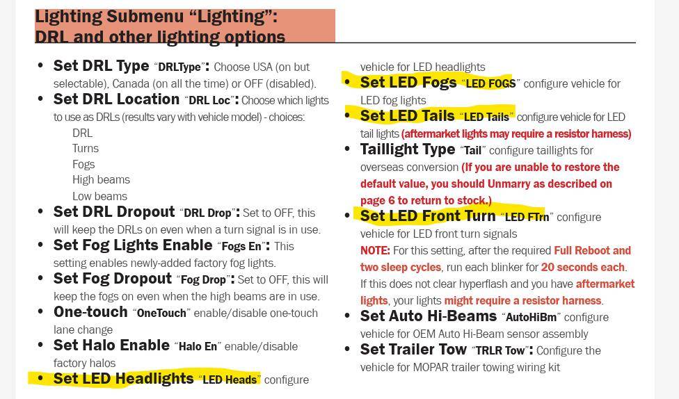

I understand the resistance and how it works both ways. I would say that electrical is my weakest link. I just absolutely hate anything related to electrical engineering and diagnosis. Some say you don’t need resistors if you change settings. Some say that their aftermarket lighting, even with resistors was not plug and play. I simply left everything as-is. The Tazer happened to take care of some pulsing in the fogs and tail lights, as I saw this suggestion and solution on another Jeep forum. My lights are consistently bright no matter what the charging system is doing. The systems on these Jeeps are very fickle and sensitive. I’ll just choose to call it magic and say that I got lucky. 🤣
