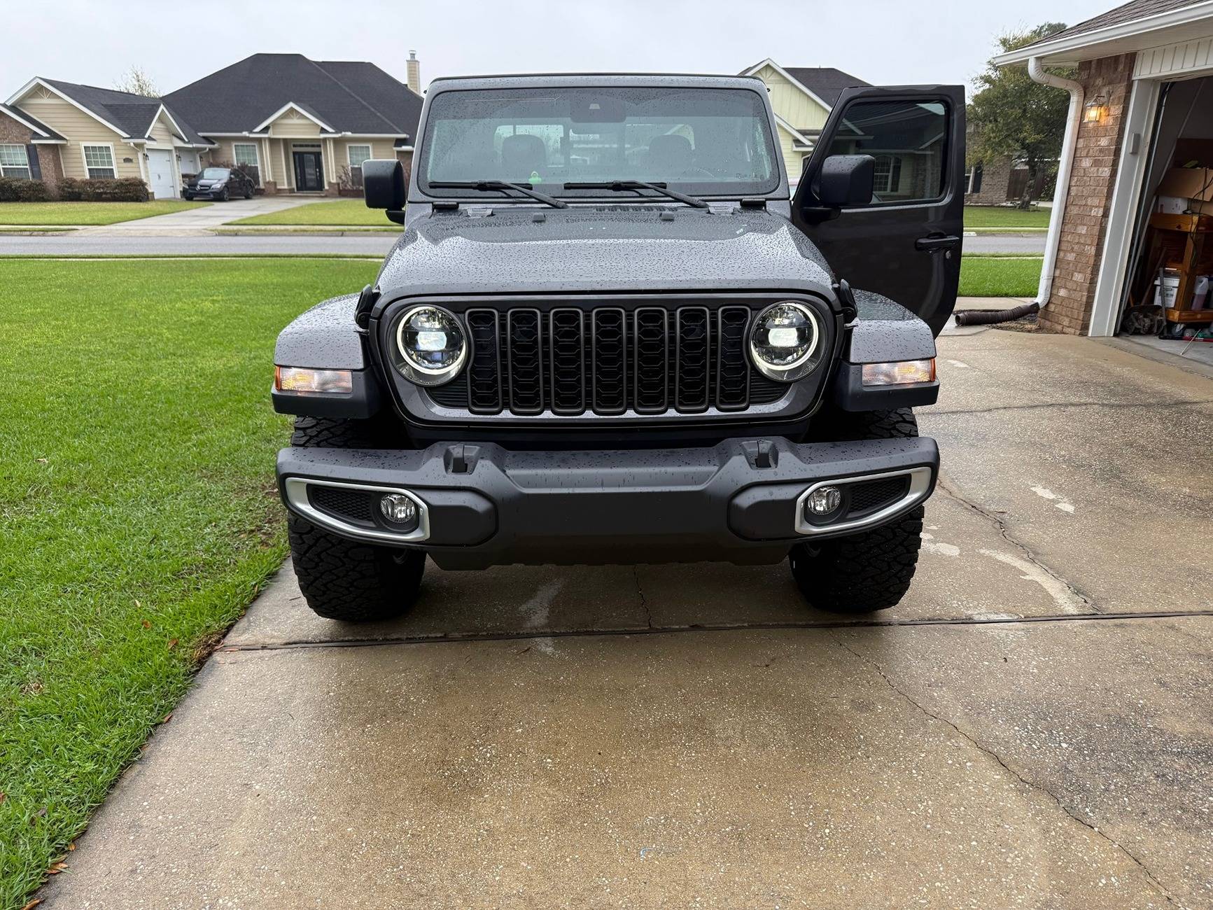

I installed the OEM LEDs yesterday afternoon after a weekend trip. It was very easy to install - took all of 15 minutes. The harness did have four wires on each side so I did not need the additional harness for the passenger-side halo.
I used JScan to modify the following settings.
High Intensity Discharge Lights On/Off - Active
LED Quad Headlamps On/Off - Active
I searched adaptions for "Signature". This brought up two options for Signature Lamps/Lights. Set both to "Active" for the halos to work.
Lastly, I enabled LED High and LED Low beam. I am not sure if this was necessary as the headlights appeared to work with them, but a number of threads included those settings so I updated them just in case.
So far no issues. Once these storms pass, I will properly aim them as they are a little low right now.
Next, I am leaning towards OEM taillights, but will likely go with aftermarket fender and fog lights.
