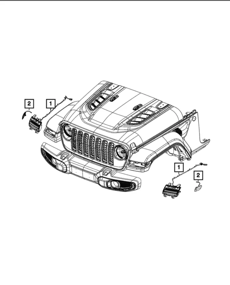

The picture:
Jeep Gladiator Complete OEM Halogen to OEM LED Conversion 1687284032650
....seems to indicate the harness comes with it - but I am not sure. You might want to call BAM and ask.
I don't think there is any way you are going to source the headlight kit with halo harness by the way. It's been unavailable for a year and a half. I waited 1 year then gave up and bought the left and right lights separately. Luckily didn't need to do the harness.
