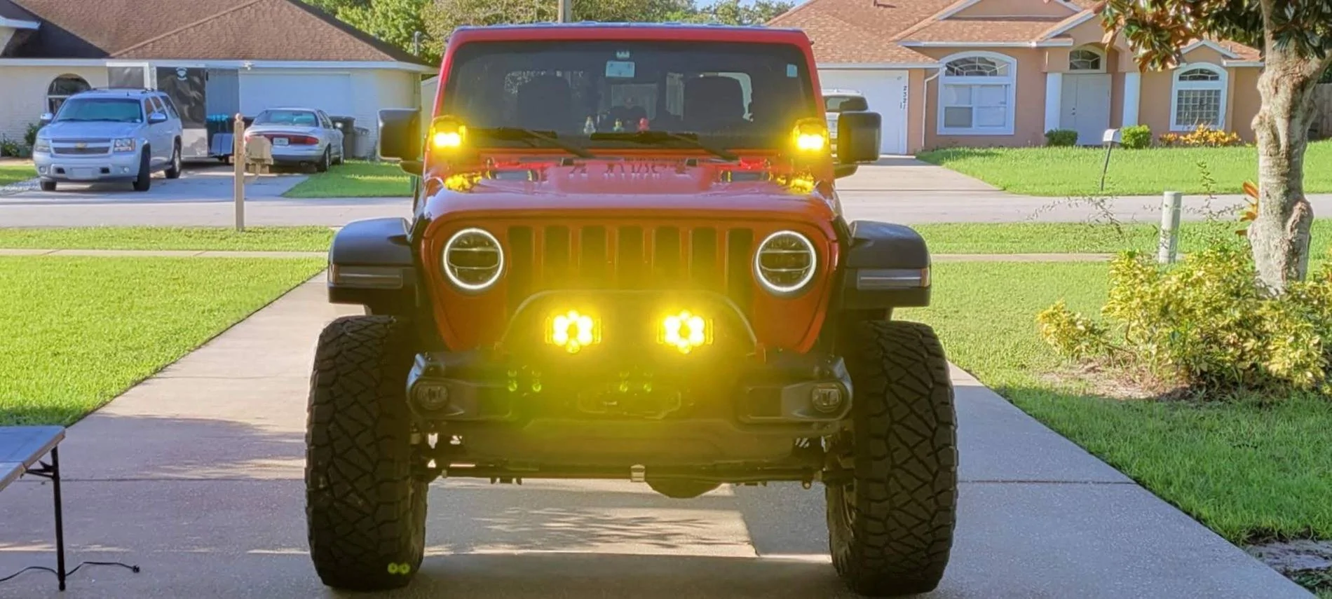

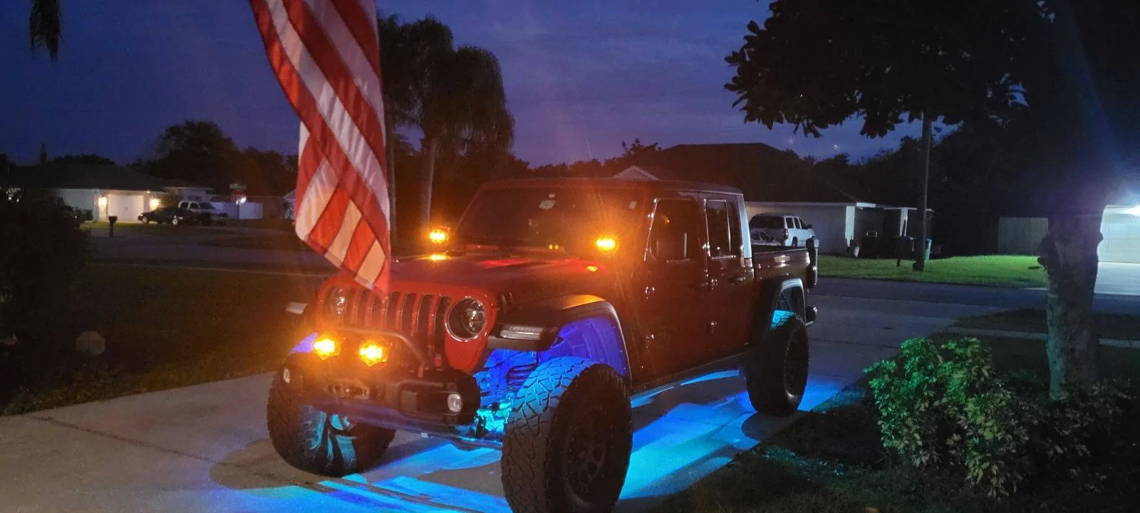

I have the 4led on the cowl and the 6led on the bumper. I made my own wiring harnesses and wired them into my Voswitch 8 switch panel. I wired up the 6 led lights to switch 1 lows, switch 2 highs, switch 3 is back lights for both sets of lights. The 4 leds are on switch 4 for spots and switch 5 for floods. The first picture is jut the back lights, I like running the amber covers.
