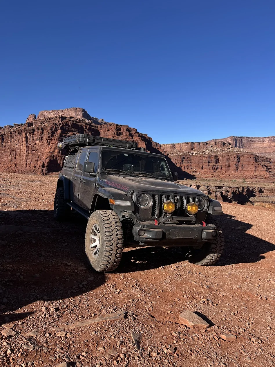

I think for the money they are very good. Better than any light in that price range. I think 1 step below Rigid. They don´t look or feel cheap. The connectors are tight and should have no trouble keeping moisture out of them. There are a couple rivets that cheapen them a little bit. I saw what I thought was a slight scratch or gouge....it was a sliver of silver against the black finish. I looked closely and I was just seeing the edge of a metal (I think aluminum) rivet that was not painted. I chuckled, but overall, they seem to be very good quality.
They will get a test as to how they hold up to winter and road salt. After years of road salt, rain, sun, mud, and crud, my LP6 lights on the JL look as good as new. If I could spare the $$, no question I´d have gone with a Baja Designs equivalent, which would be an LP4 in my case.
Here is a pic with the back lights. They are as bright as they look here.
The reason I went with the 4 instead of the 6 is because the giant hooks on the Arcus bumper forced me to mount them to the outside. The 6 was tall enough to get a little bit in front of the headlight which I think would have caused a shadow. So the 4 was a better fit.
I´ll get some better brighter shots soon. I washed the truck last night, so it is parked until departure to Moab. I have to work 12 hours each day today and tomorrow, so I won´t have a good chance to get some good pics until Friday.
Btw, the cowling lights are off Amazon. I can´t remember the brand, but they are pretty good. But they´ll be replaced at some point by the spots on the bumper and the bumper will get two Roadshocks with flood low beams.

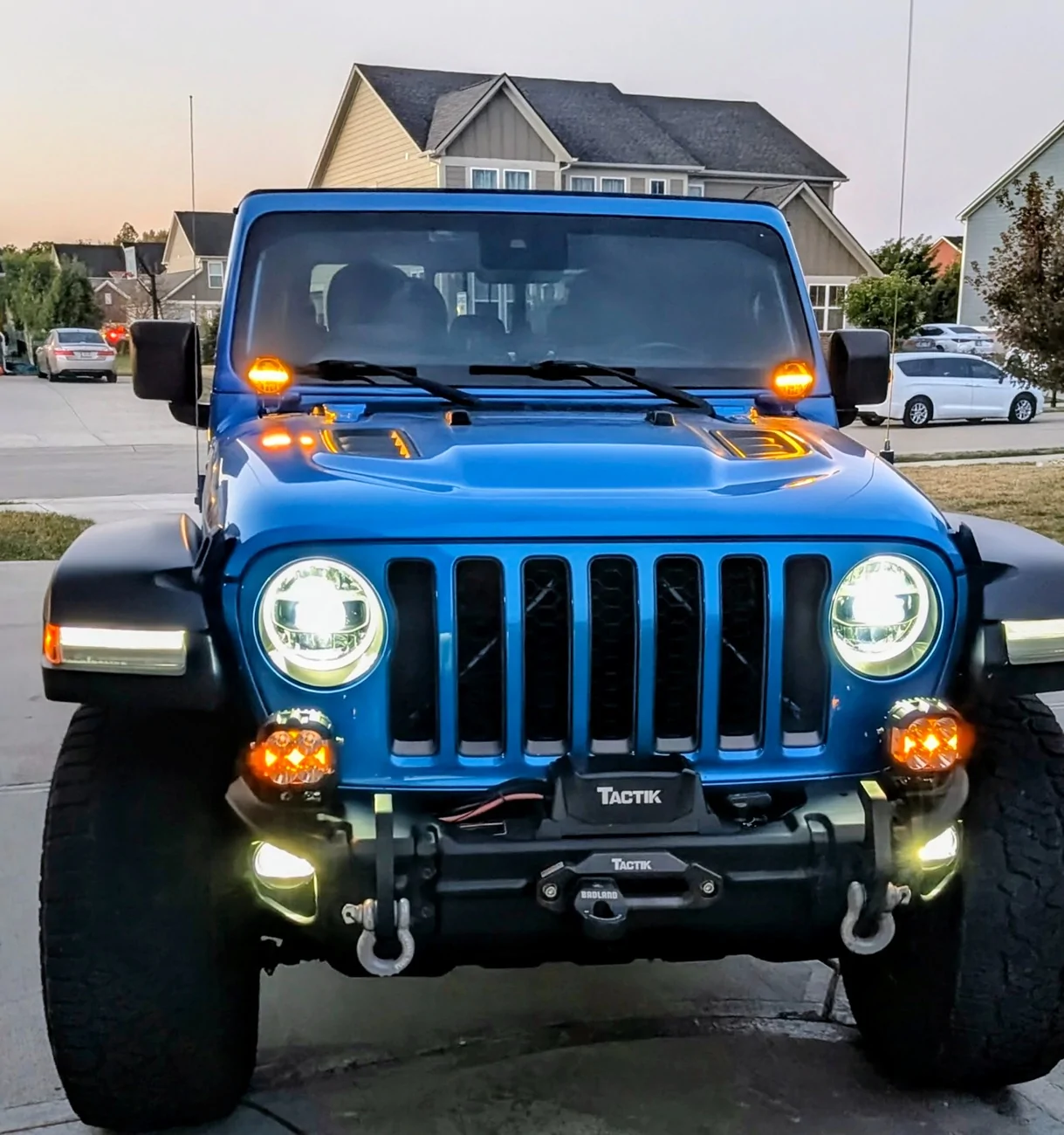

I have the large 6 LED HF lights. Used factory Aux switch 1 for low beam, switch 2 for high beam via a 5pin relay. Your not supposed to power high and low simultaneously. The relay kills the low beam side when activated. My next step is to remove from switch 2 and tie to head light high beam. So I will activate low beam via aux switch then when Jeeps high beams are on the HF lights Highs are on. The backlight is tapped to a ignition hot wire, so if the Jeep is running the backlights are on.
The side shooting led's on these mitigate the need for ditch lights for me!

The 5pin relay is amazing, but to save a switch, I tapped the highs to the vehicle's highs. Works great
