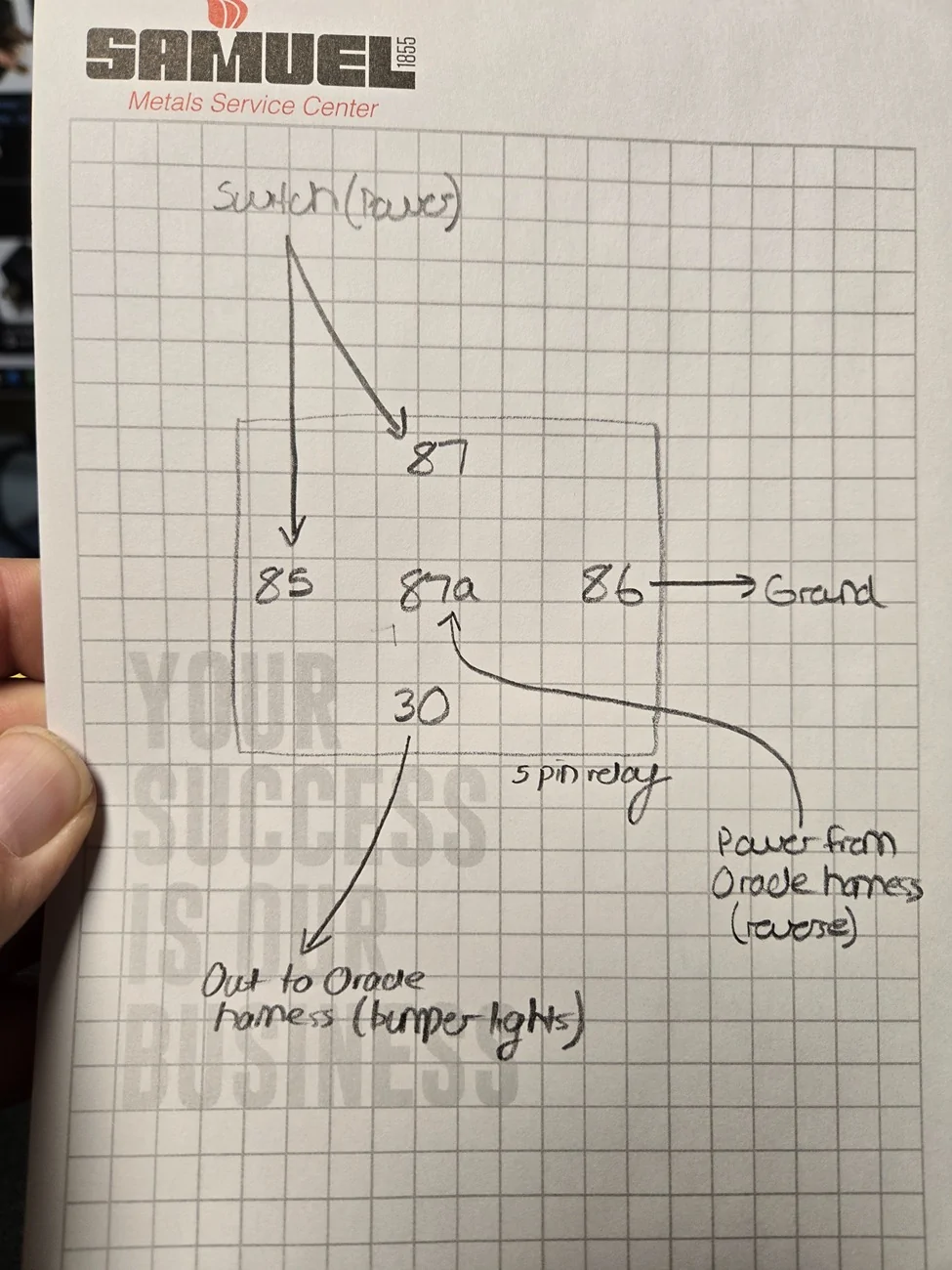

I hooked up your bumper reverse lights to the backup lights but keep thinking I want to use them when not in reverse (setting up camp). Is there a way to do both at the same time?
Yes — it’s possible! The easiest way is to add a relay. That lets the lights still come on in reverse, and gives you manual control for things like setting up camp. If you have aux switches, you can tie the relay into one of those. If you don’t, you can still use a simple manual switch and pull power from an ignition-on fuse so the lights only work when the truck is on. It’s a little extra wiring, but very doable.

I have the aux switches. Where do I put the relay?
Should be something like this. Its been a while since I did this on my truck. In my truck one switch locks the rear lights out and another switch activates them regardless of gear position - so this may be slightly different than how mine is.

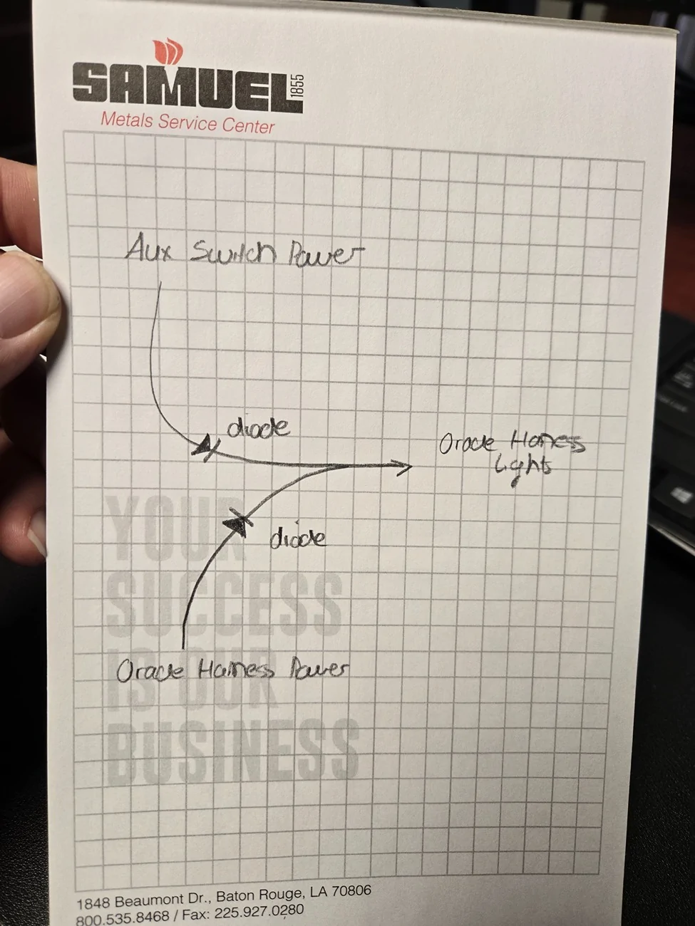

Same basic function can be achieved with diodes depending on amp draw of the accessory and the rating on the diodes. This allows multiple sources to feed one item without backfeeding into the other power sources.
If you have the factory aux switches, then hook them to that. They have relays built in. No need to add one.
Not sure, so double check me here. But I think you need to feed into a relay like ChrisNLA described to keep the circuits separated, even with the relay on the AUX wires. Otherwise there is a loop with the backup wires and the AUX line. Something like that. Wiring gurus need to weigh in.

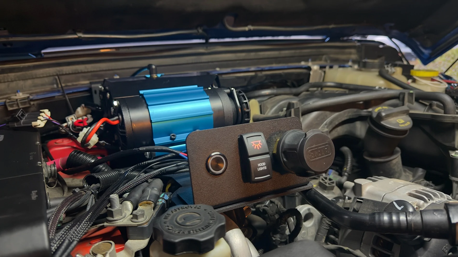

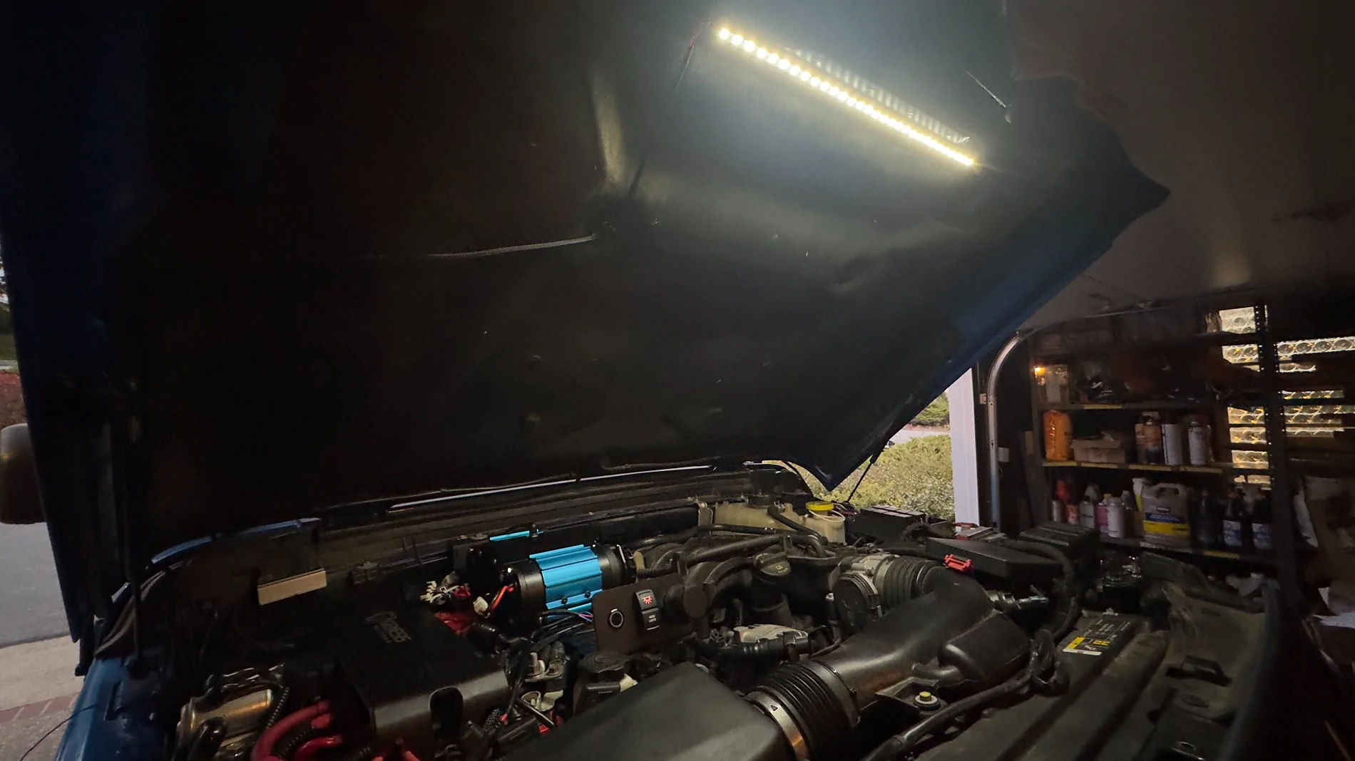

LED strip under my hood. Surprisingly bright, makes working/navigating in the engine at night a breeze. Switch is attached to my 813 Fab ARB plate, next to my air chuck and tank purge.
Nice! How do you like the hood struts? I've thought about it, but I'm short, so I don't feel like climbing on the bumper every time to close the hood. I suppose I could do the awkward side hood close.
