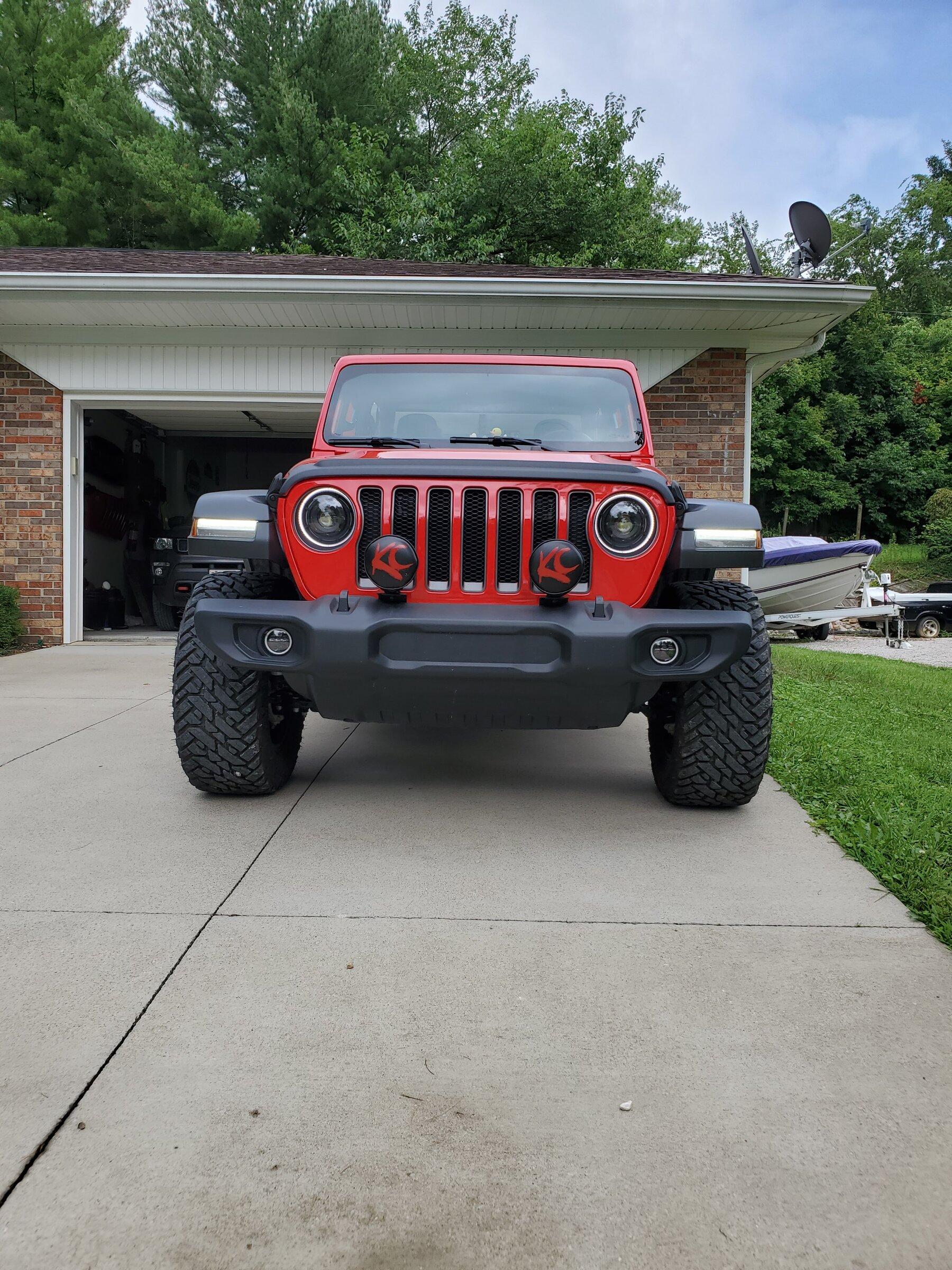

I have the baja designs LP4 lights with amber backlight installed on my bumper. They’re much brighter than the high beams and highly recommend them. You can either mount them directly to a steel bumper if you have that or buy ring mounts to attach to the hoop. Also have removable amber protective covers for snow and dusty conditions.

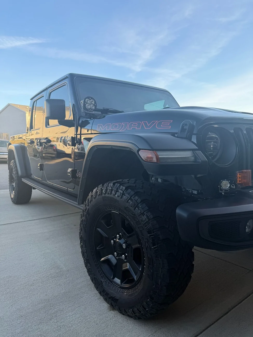

Use a driving/combo or spot pattern on the A Pillars or risk glare from the Mojave hood. I have a pair of Baja Designs XL80 in driving lenses on some Artec cowl mounts, then a set of Rigid DSS Pro flood beam and Baja Designs S1 wide cornering lenses angled out on the bumper. Plenty of good throwing light and have amber lenses to snap in pending inclement weather.
Jeep Gladiator Lighting advice needed IMG_8316
