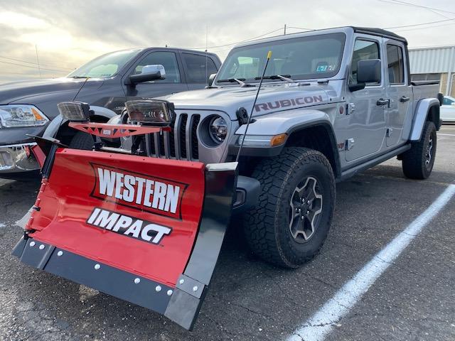

I have a build going with a plow. Anyone have recommendation on lighting that's good in the snow. I was going to do some yellows but I have heard others talk about having blue lights in the snow. I ran with straight white halogens on my last Jeep. Thoughts?

The plow blocks both the headlights and the fogs. The headlights on the plow are okay.

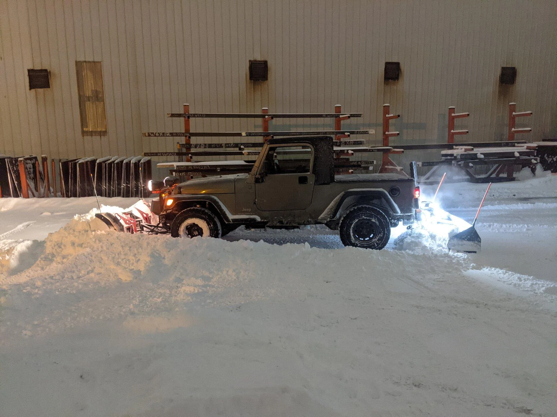

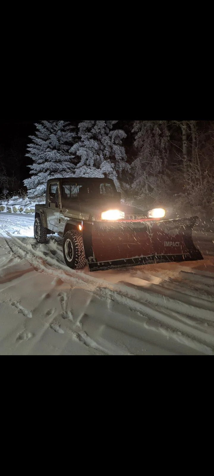

Here's my little jeep lj half cab plow truck with a western v plow and pull plow on the rear. All I can say is it best little rig I've plowed with. I can't wait to plow with my Gladiator. But I have a feeling it won't be as good as my LJ

Can you supply more info on this plow setup? not seeing It as an option on the site. Appears it's a UTV plow. any insight is appreciated
Thanks
