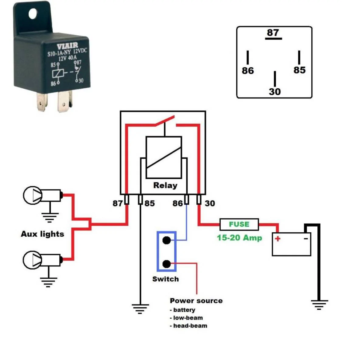

Please ensure you review this a couple times- then, once you confirm all connections are ran exactly how the diagram shows- connect power…. Key note- ensure lights are grounded relatively close to the lights, and not ran back to to negative terminal or anything else crazy….
also!!! Diagram shows 15-20 amp fuse….. if these are LED lights they probably only use 2 amps, potentially less! Use the manufacturer’s recommended fuse size….

Aside from the numbers on the relay wires ( which I have no idea what they mean) this is how the lights are wired. It has a 30 amp fuse on mine. The entire harness came pre wired as one larger unit with a small jump connection for the switch and just required connecting the positive and negative at the battery and unplugging the connectors to the 12 volt outlet inside the vehicle and plugging in a part of this harness so the switch could be connected which also has a fuse (5 amp). The harness plugged into connectors on the lights. Every connection was connector plugs which snapped together so no chance of not plugging in far enough, except the switch which has 3 wires, a "trigger wire and positive and negative with all clearly indicated each with their own slide on connectors.
