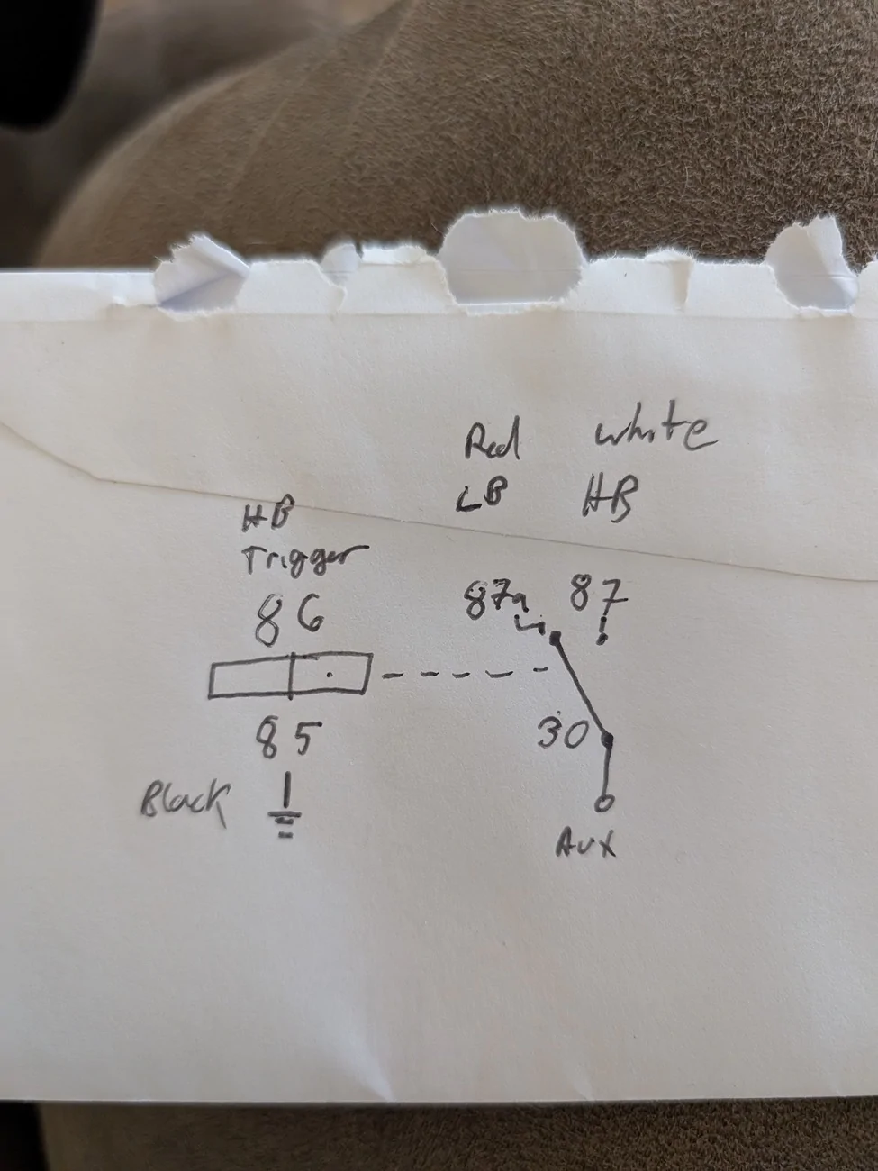

I used the aux switches for my edge4 lights.
Back lights tapped into running lights
Using a 5pin relay as follows:
Jeep Gladiator HF Road Shock Lighting--How Did You Power Them 1000014921
This setup allow the low beams of the edge 4 lights to be turned on with or without the vehicle low beams on.
High beams on the edge4 lights are activated when: aux button on, and turning high beams on.

Why don't you use the relay like I suggested? Uses only one aux switch

Out of curiosity, How many switches are is use?
I have 3 sets of lights:
2 sets are on my chase rack and each set takes an aux switch. These lights are wired in as I mentioned above with the relay. For the high/low beam functions and backlight tapped intothr trucks running lights
1 set on the bumper that takes an aux switch but it has no back light or high beam.
