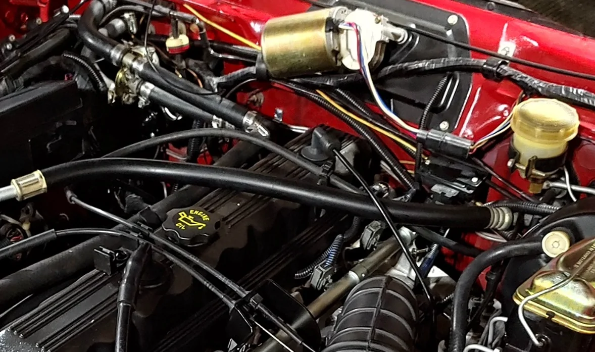

Heat gun.
When I put the Jeep 4.0 in my car, I wanted to use as many of the Jeep's hard lines as I could - neater and don't get messy like rubber vacuum hose.
So I used a heat gun - GENTLY - and softened the tube JUST ENOUGH to slip the fitting out of.
I cut and shaped the lines as needed, put the fittings in and heated them to fit.
Some of the connections used a hose over the plastic and over the fitting end, others were direct fitting into plastic line.

Heat gun.
I replaced many of the "hoses" in my engine bay with the lines salvaged from a 94 ZJ
Otherwise, not sure if it's been said here before or not - You can usually push hard enough to get the thing started. I think people are used to the lowered force required in modern brakes, where I was so used to manual brakes with no assist, I just instinctively press the pedal harder and get to the point it will start - although it's only happened on my Jeeps once or twice after sitting for a week or more.
Yep, I should have tried that first. It just looked so formed on to the nipple that I figured it would never go back on tight.

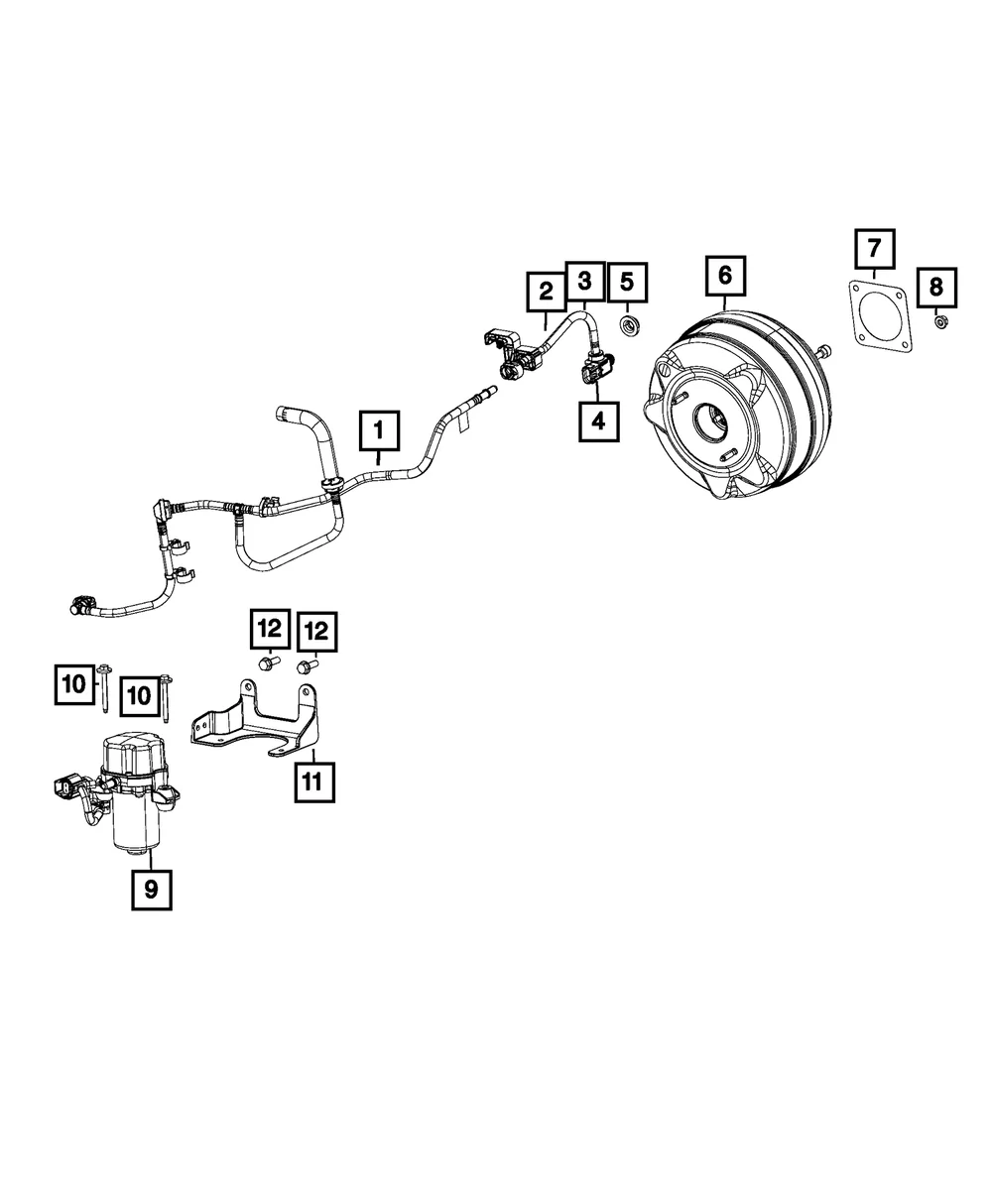

Does anyone know where to source the just the hard line?
The pre-shaped Mopar part (68358377AB) lists for about $90 (about $60-$75 on many sites). The part (#3) includes the fittings and sensor/check-valve, but all I needed was the hose (#2, but not sold seperately).
Some bulk line and a heat gun would be ideal! (I needed to tap into this line for my towing brake system, and ended up replacing that segment with traditional hoses and clamps.)
