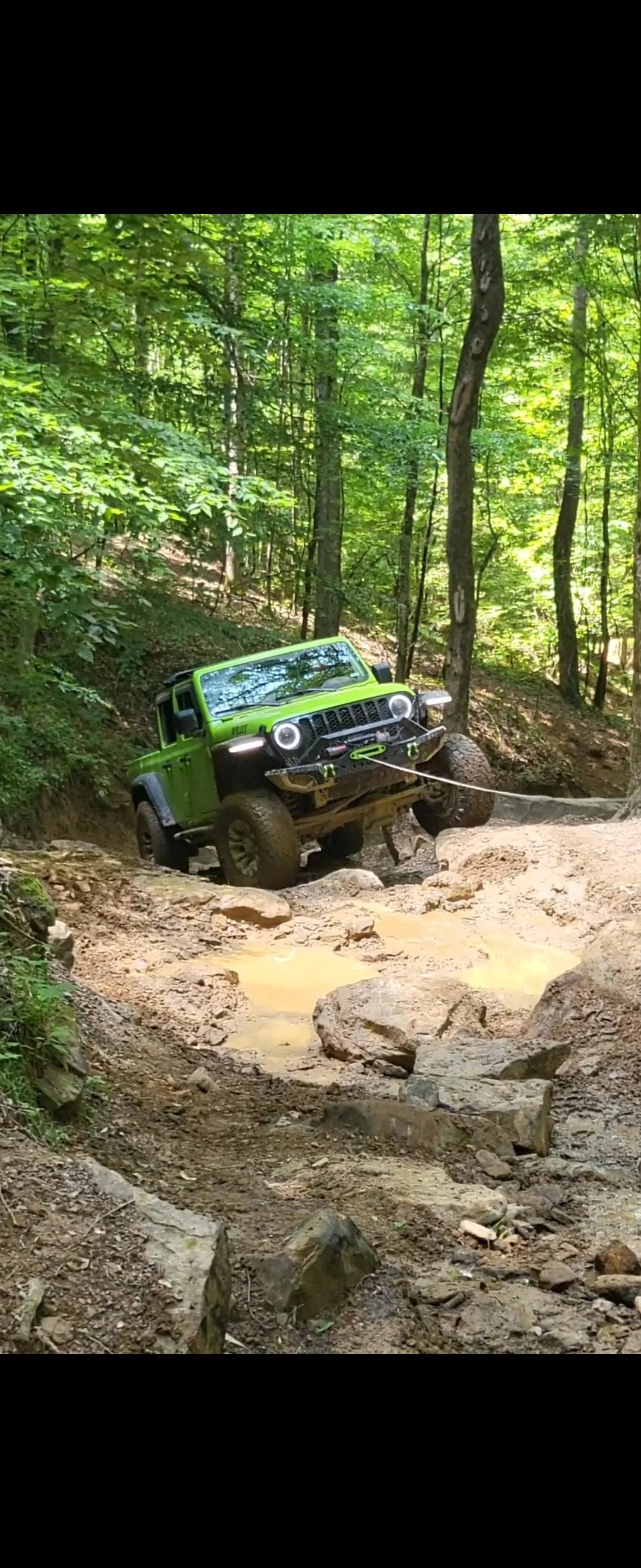

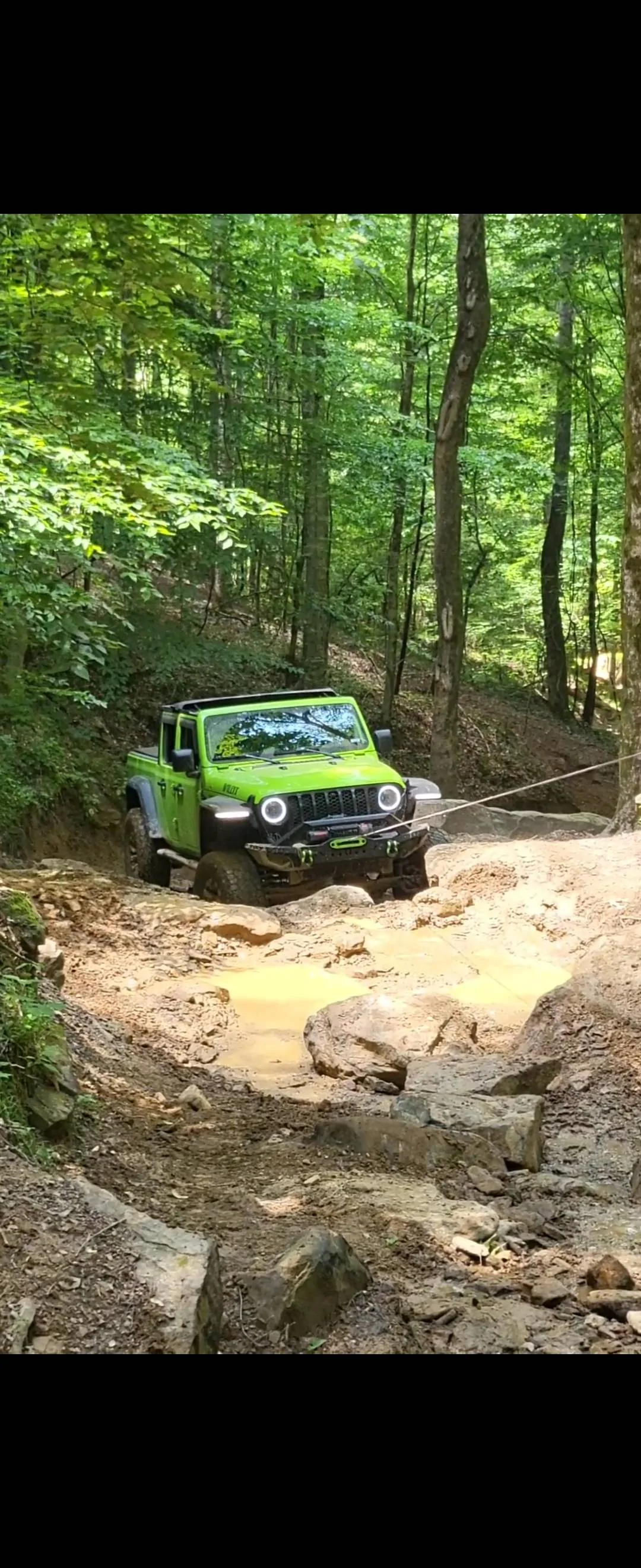

Might need to use pulleys to add multiplication of the pulling strength.
Very true. Good call. Cheap way to increase pulling power, if you have enough line.
Yes absolutely a great call. I have a block in my arsenal. The winch never laid down but it was grunting pretty good.
Will definitely keep that in mind if I get in real trouble. I do keep a block in my recovery box.

Sounds like a great time.
Which brand winch were you using?
It is a Rough Country 9500 pro. Great winch and has never failed me. It will be going on my wife's JT to replace the 8000# winch she has.

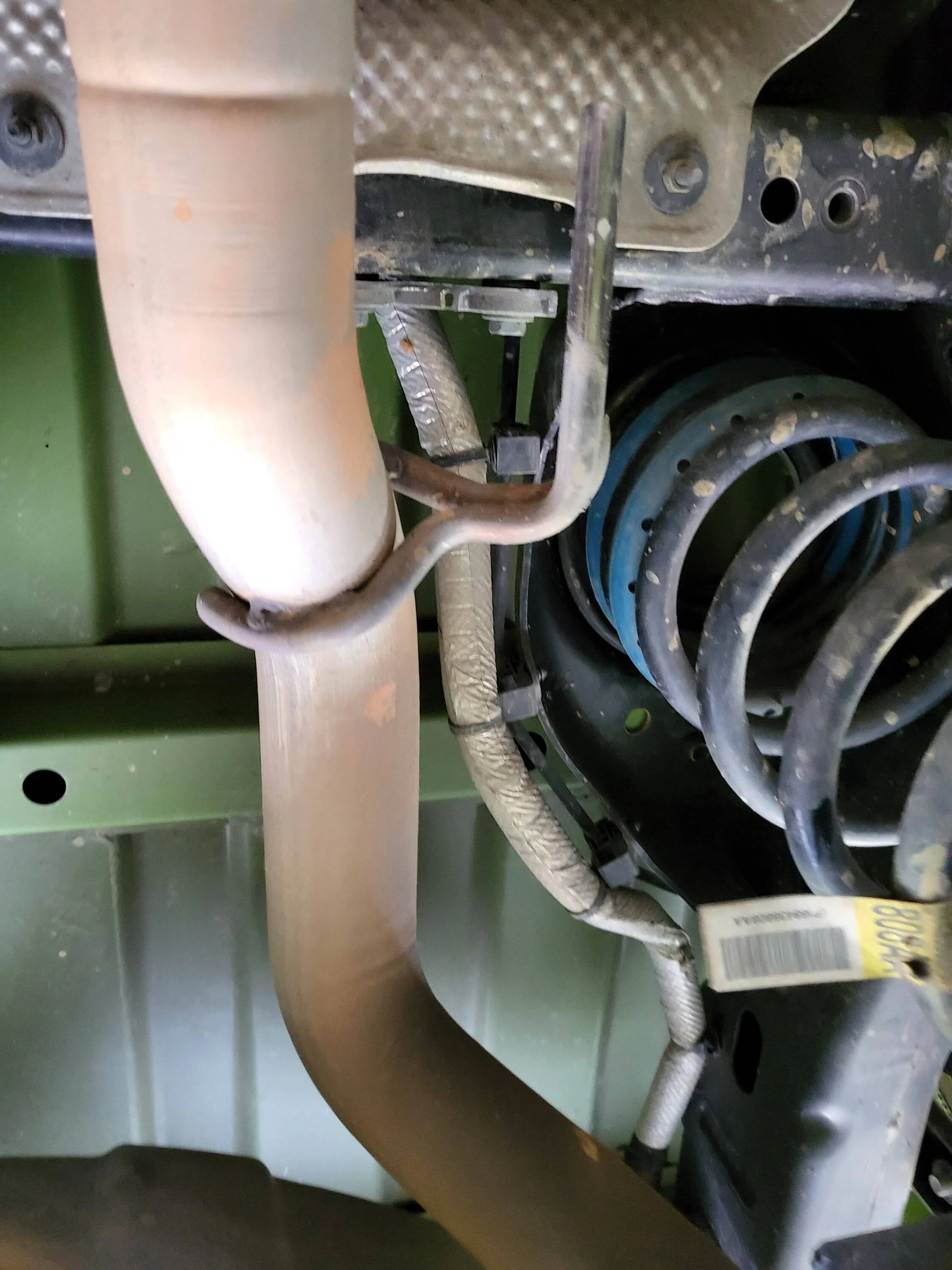

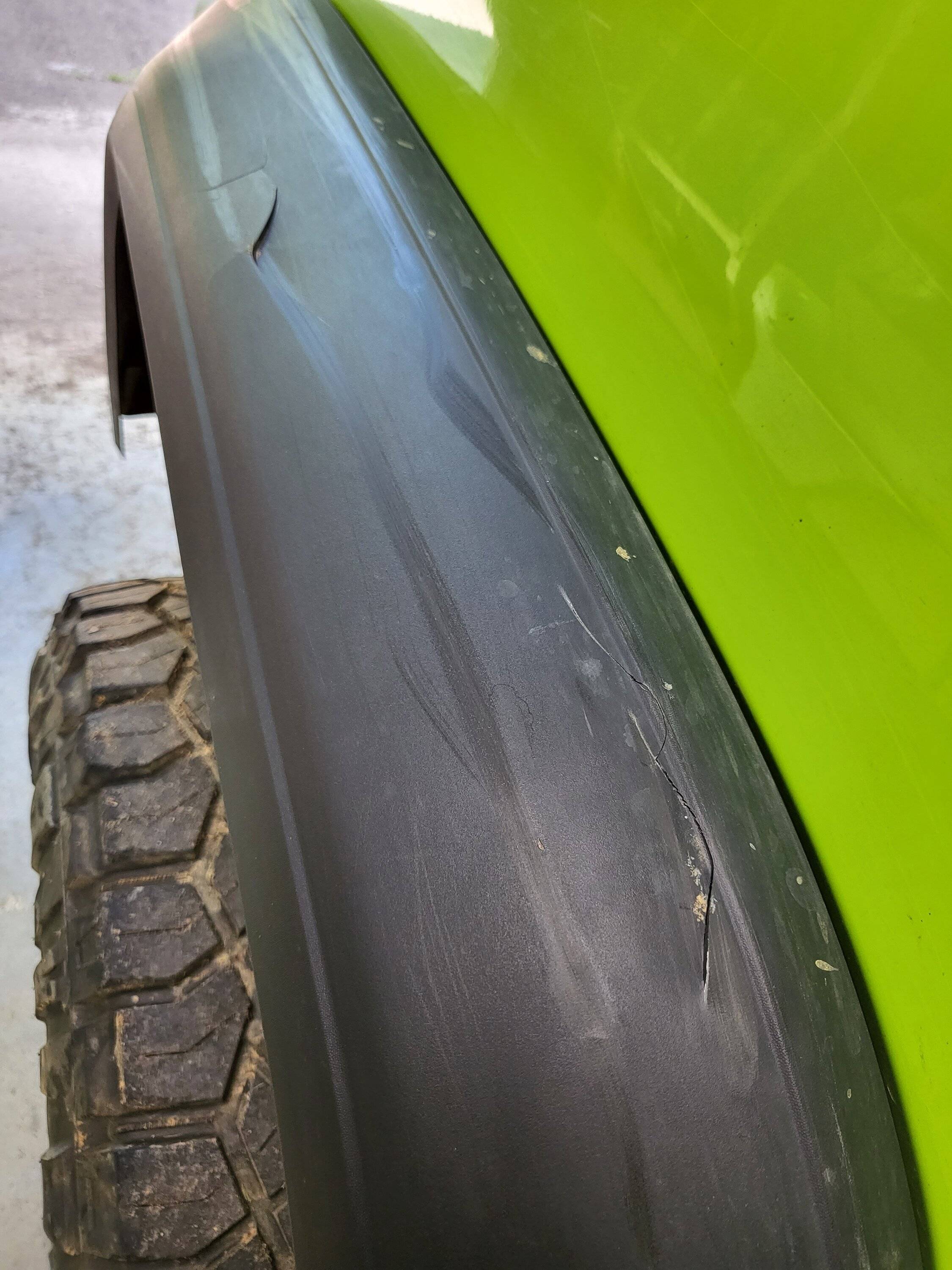

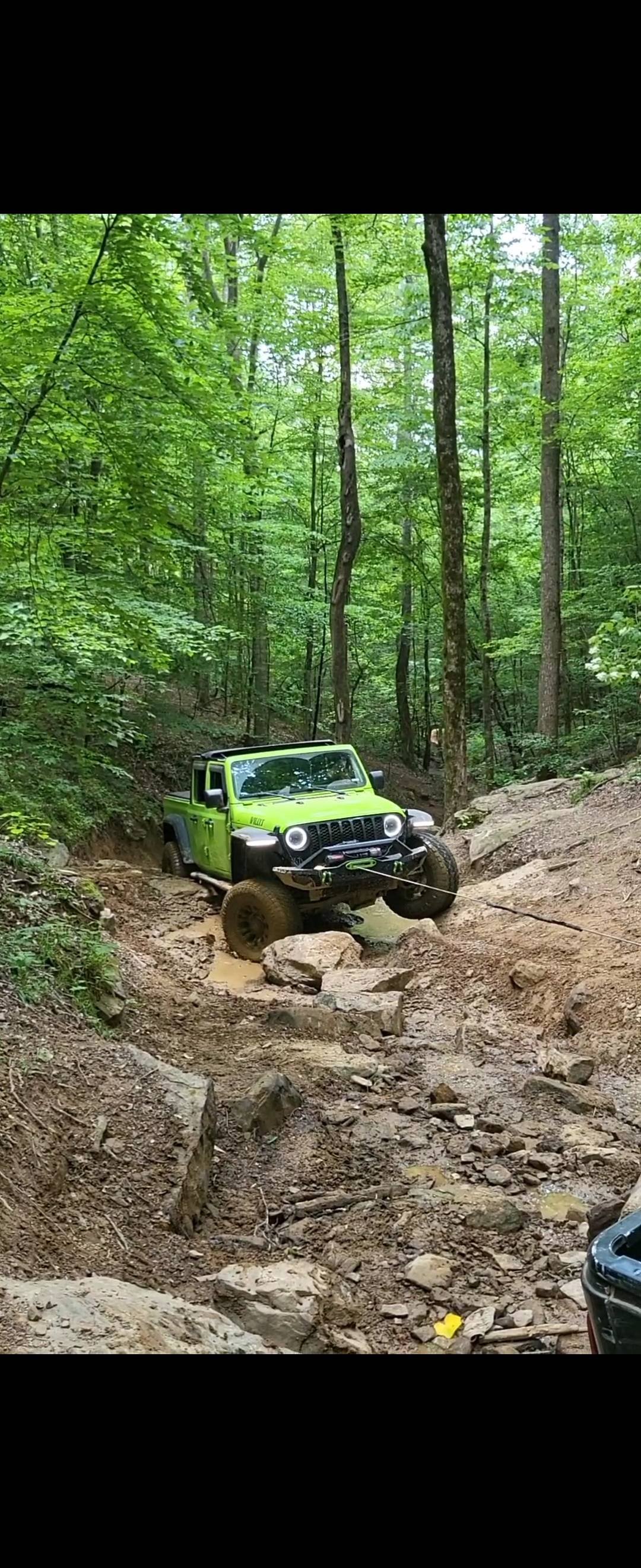

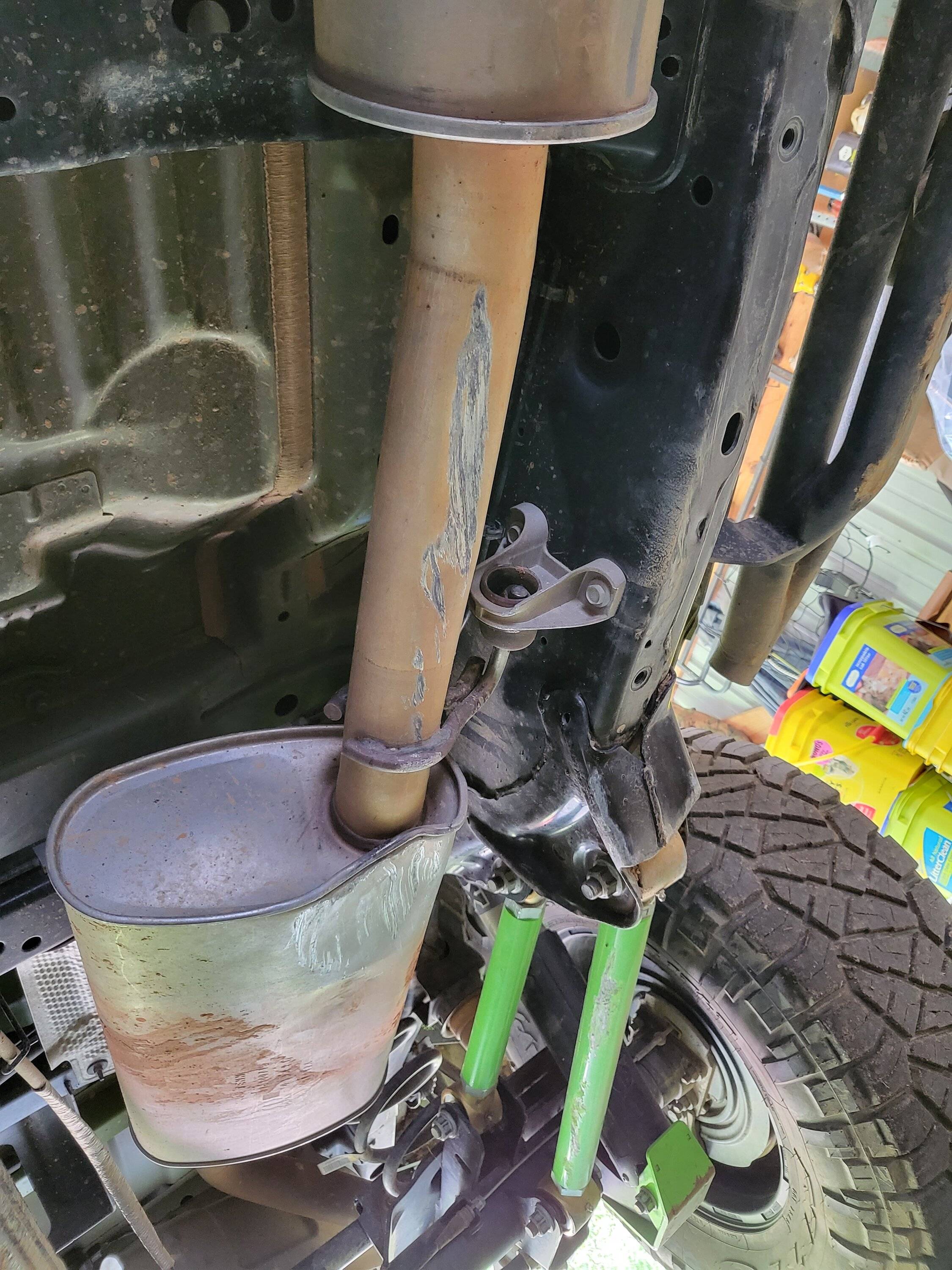

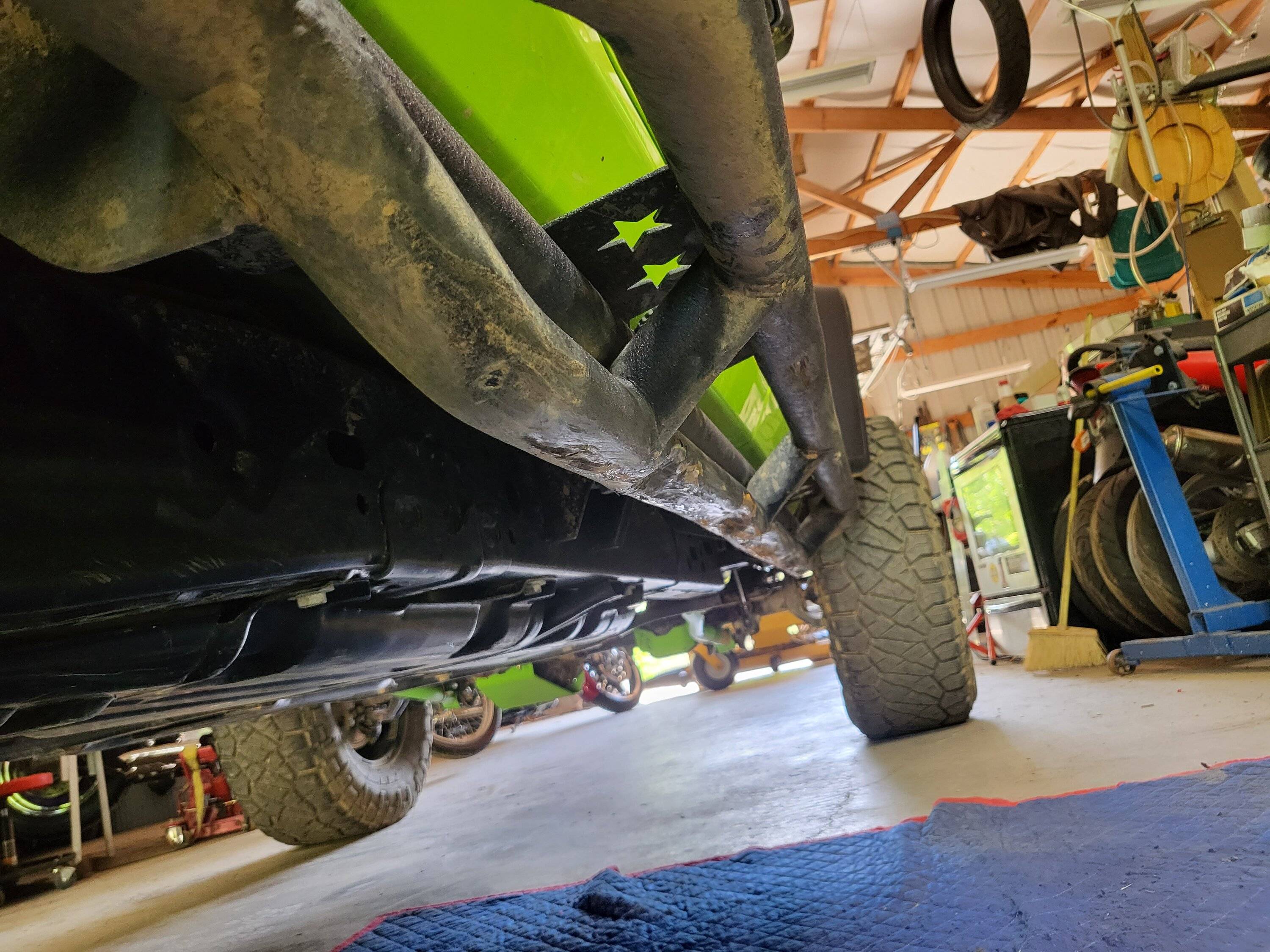

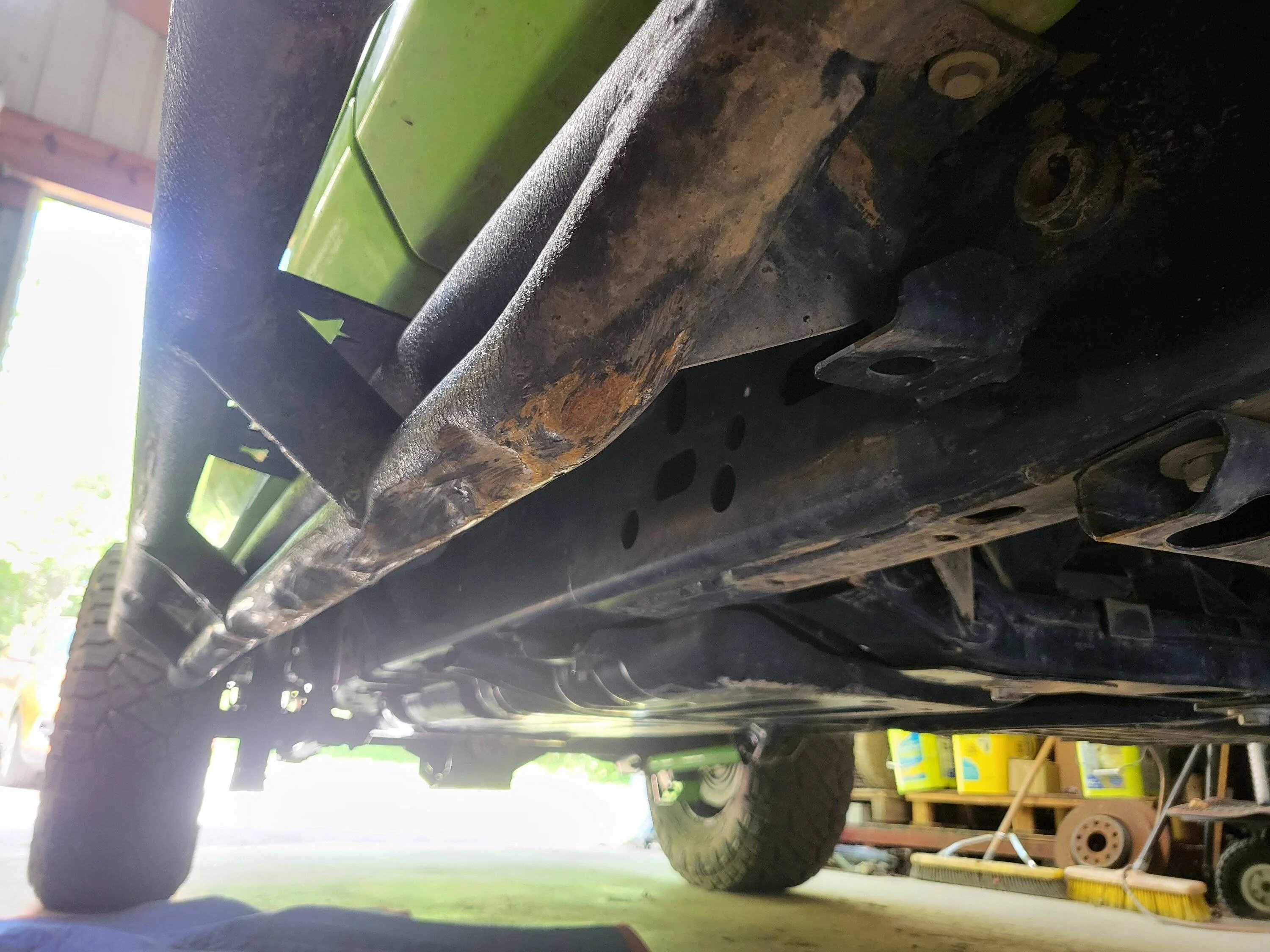

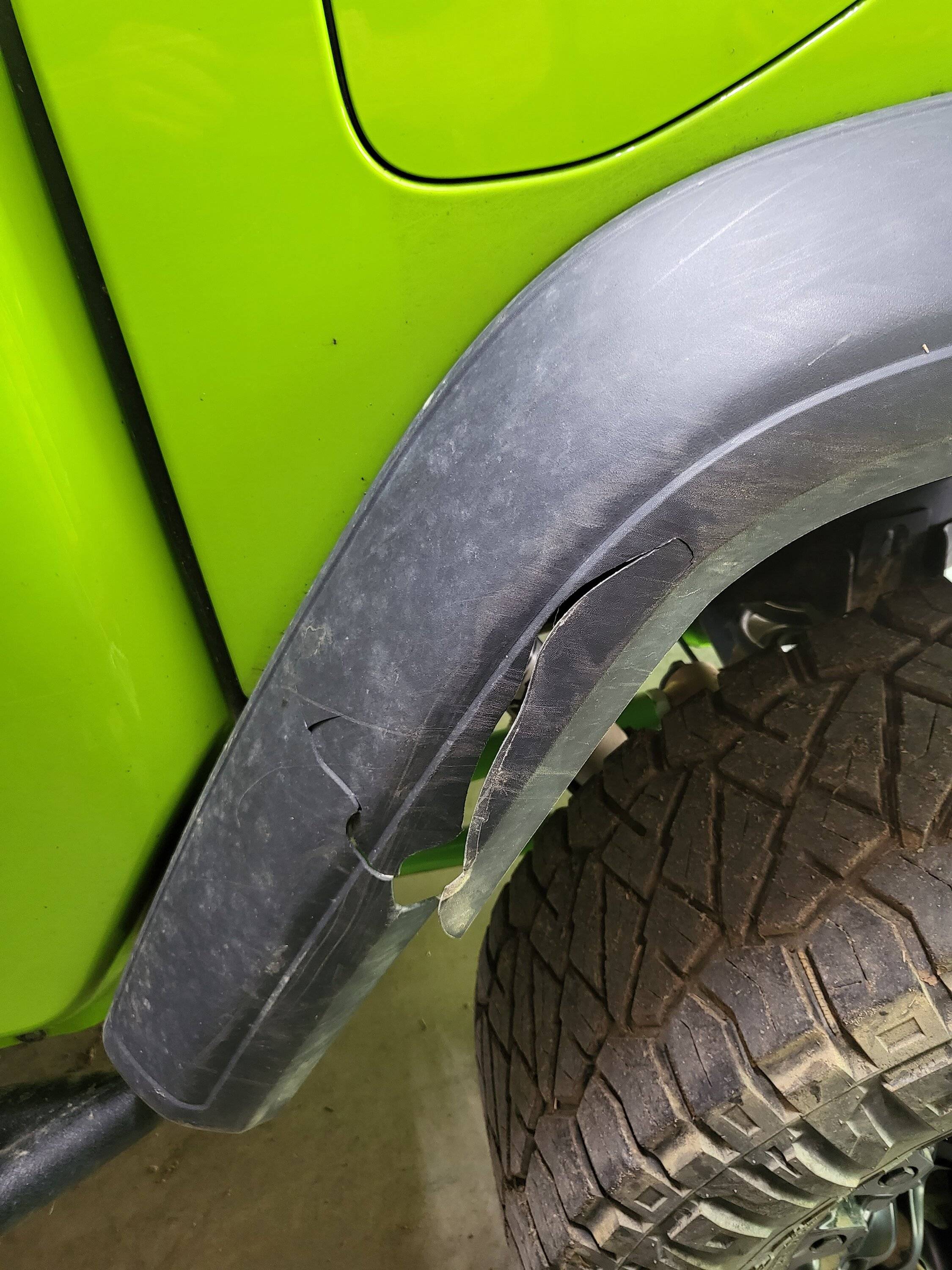

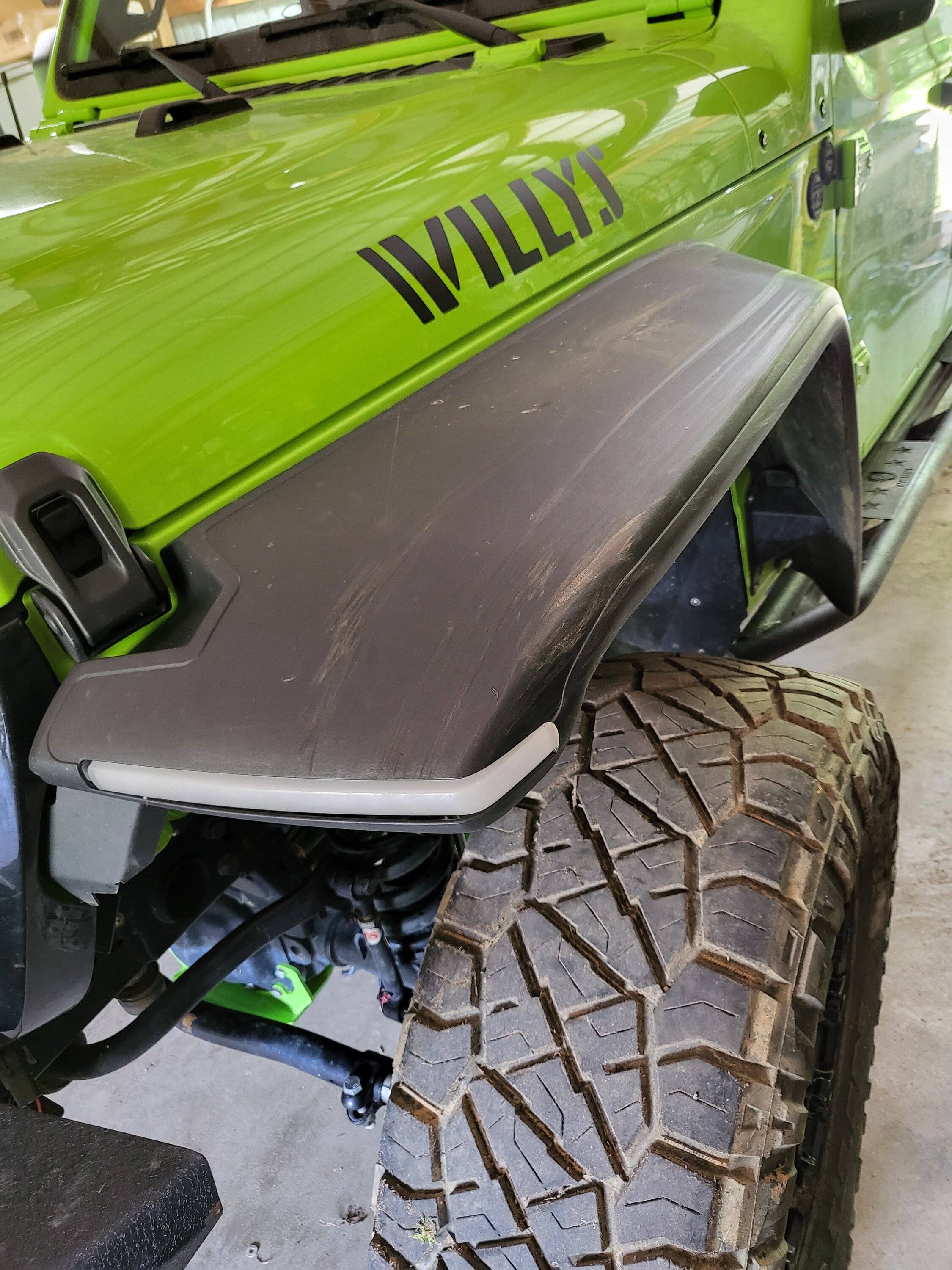

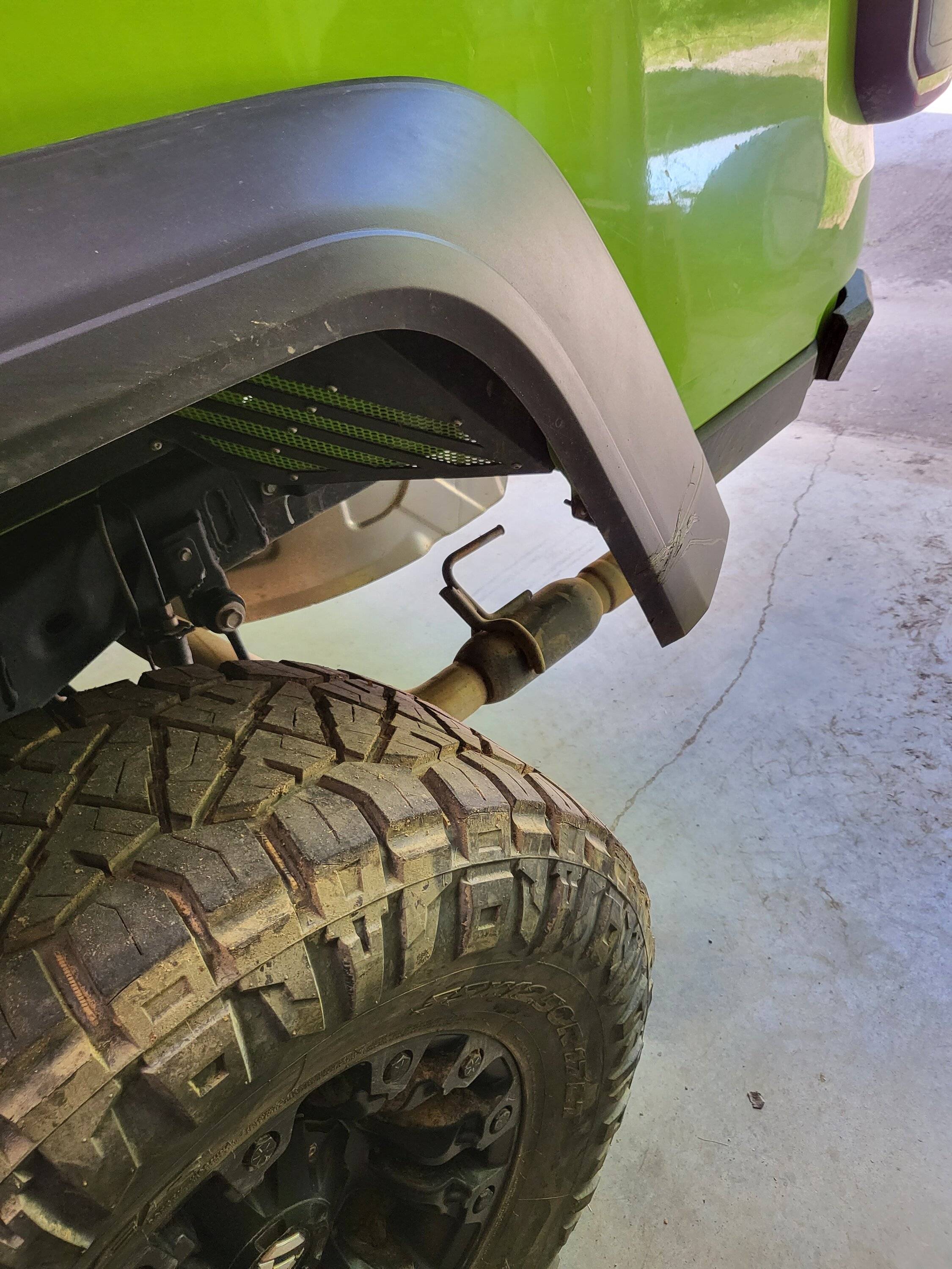

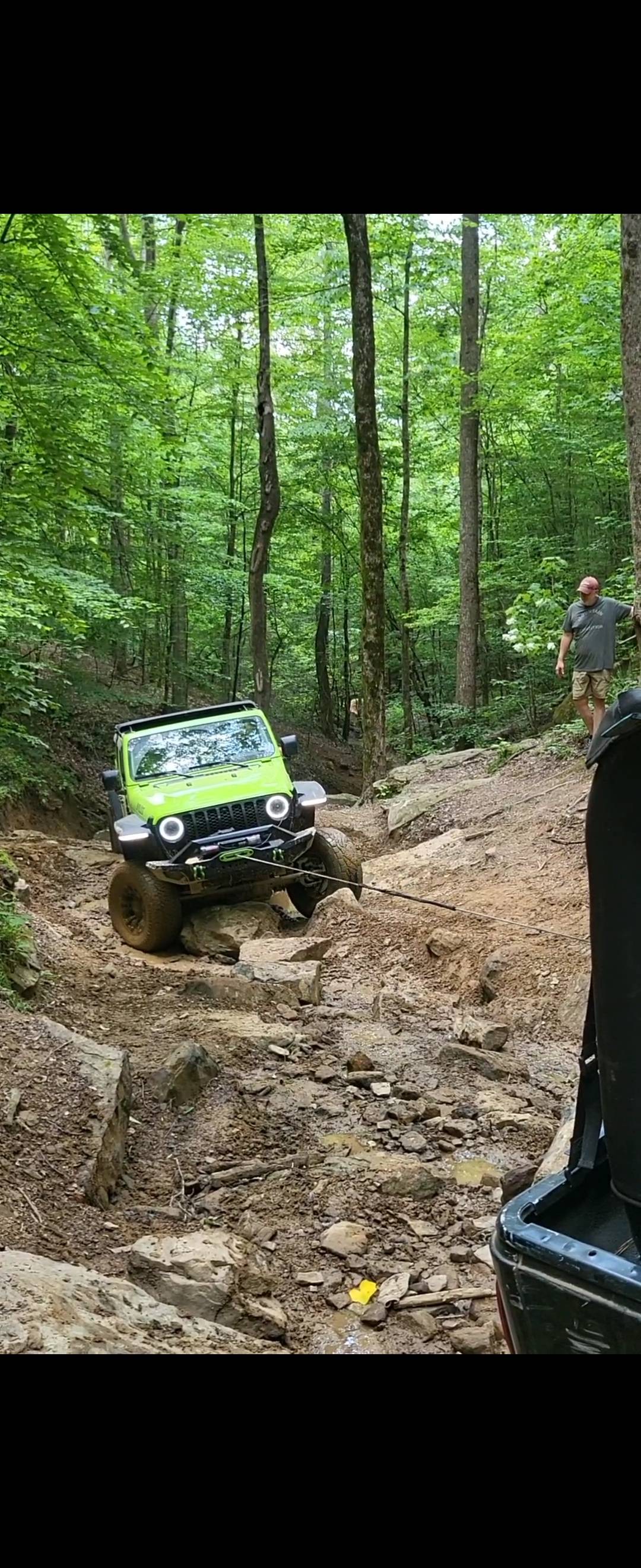

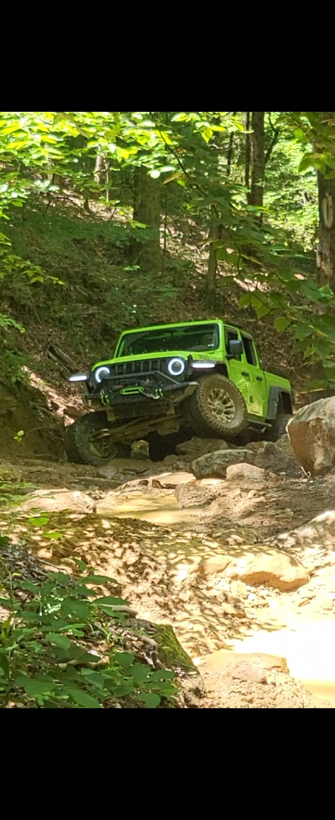

Hard day of wheeling on Sunday at Stoney Lonesome OHV in Bremen AL. but we had an absolute blast. Broke both back fenders, one tail light, bent the front fender LED bracket down, knocked the tail pipe out of one hanger and broke another one clean off, tweaked the exhaust enough that it loosened the driver side manifold at the head (exhaust leak), bashed in the rock sliders, bent a rear sway bar link like a banana, and found out my winch is way under powered. We had an absolute blast wheeling though. I'm pretty sure fender deletes are coming. I love the rugged ridge max terains but they're not made for hard wheeling. No mechanical failures though so all is good.

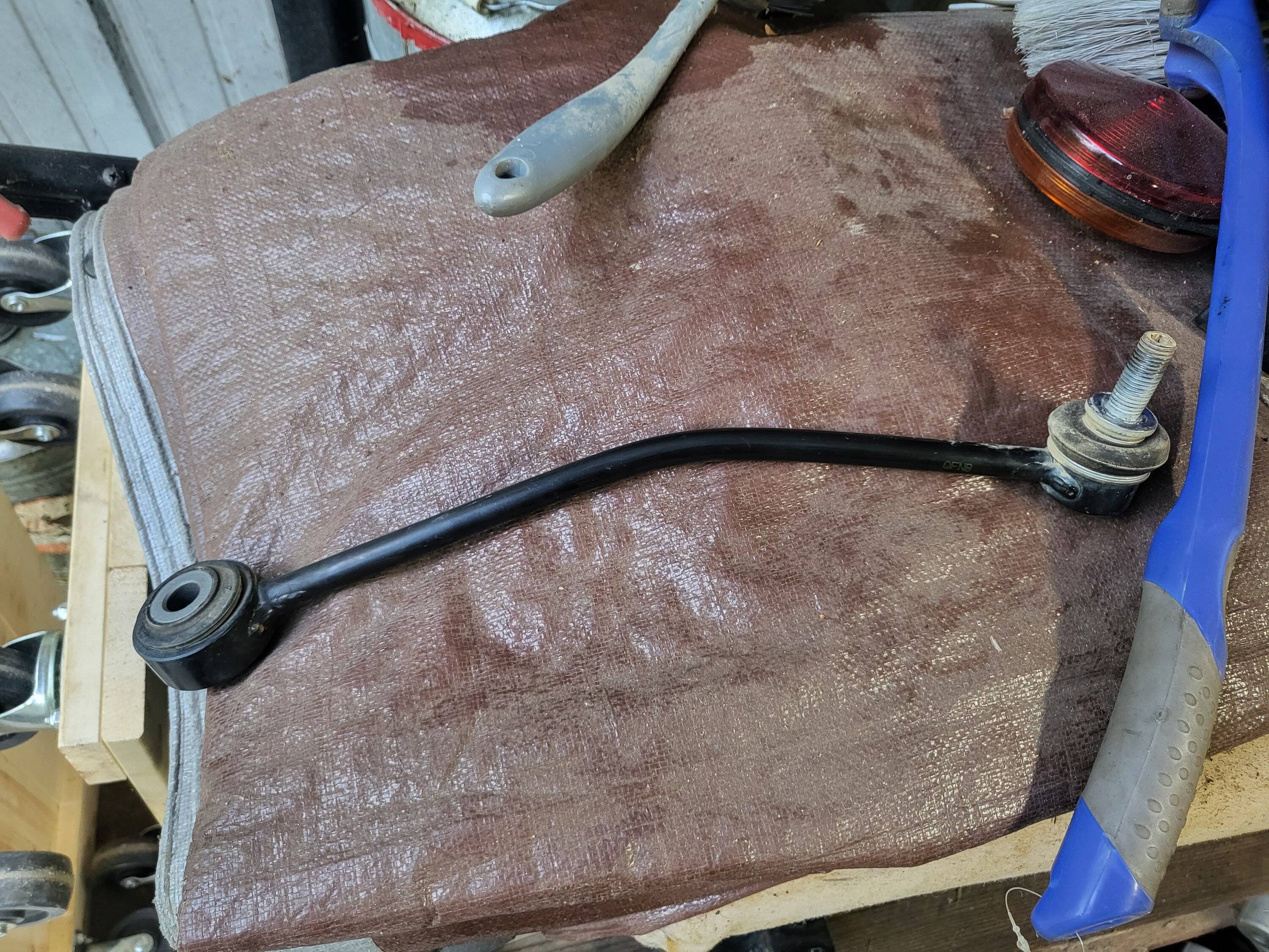

A little late to the thread but here is the rear sway bar end link. It's back straight now.

What did you have to do to fix the exhaust leak? Once you put everything back in place did the leak go away? I'm dealing with a similar situation, but when I put it all back together with a new gasket the leak is still there, albeit much better than it was.
I ended up clamping the header/catalytic converter in a vice and flat stoning the gasket surface. It was not flat. If you lay a straight edge across it you could see about a .010 gap under the flat edge. A good long file would speed the process followed by flat stoning. That finally sealed it back up. I went through 3 gaskets before checking for flatness.
