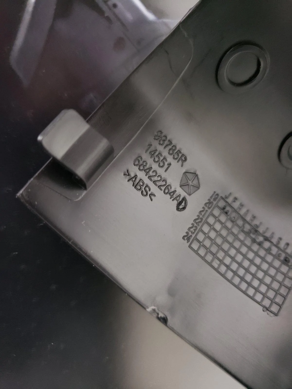

OK, the panel that covers the plug on the hard top in the rear, driver side corner is Mopar p/n 68422264AD. The part I pulled from a Gladiator on the lot has the same number molded into it on the inside. It lists for $6.35.

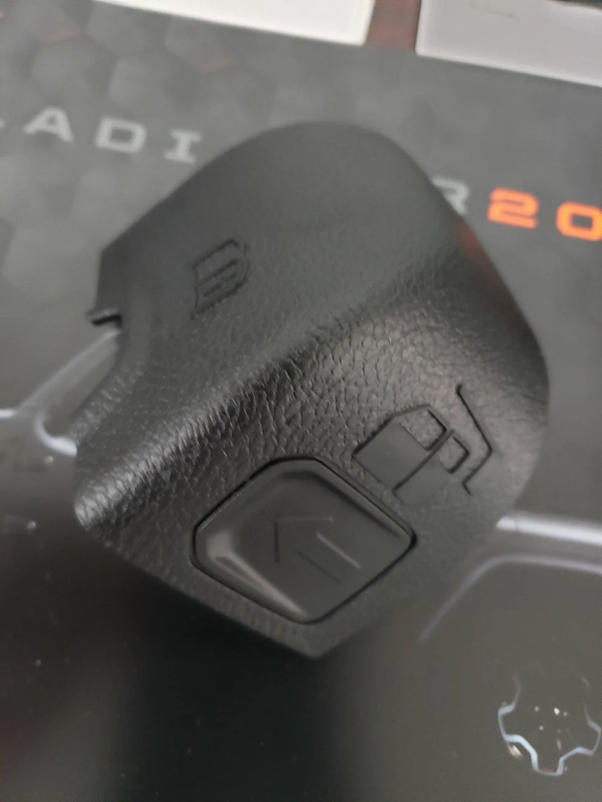

@Elwenil

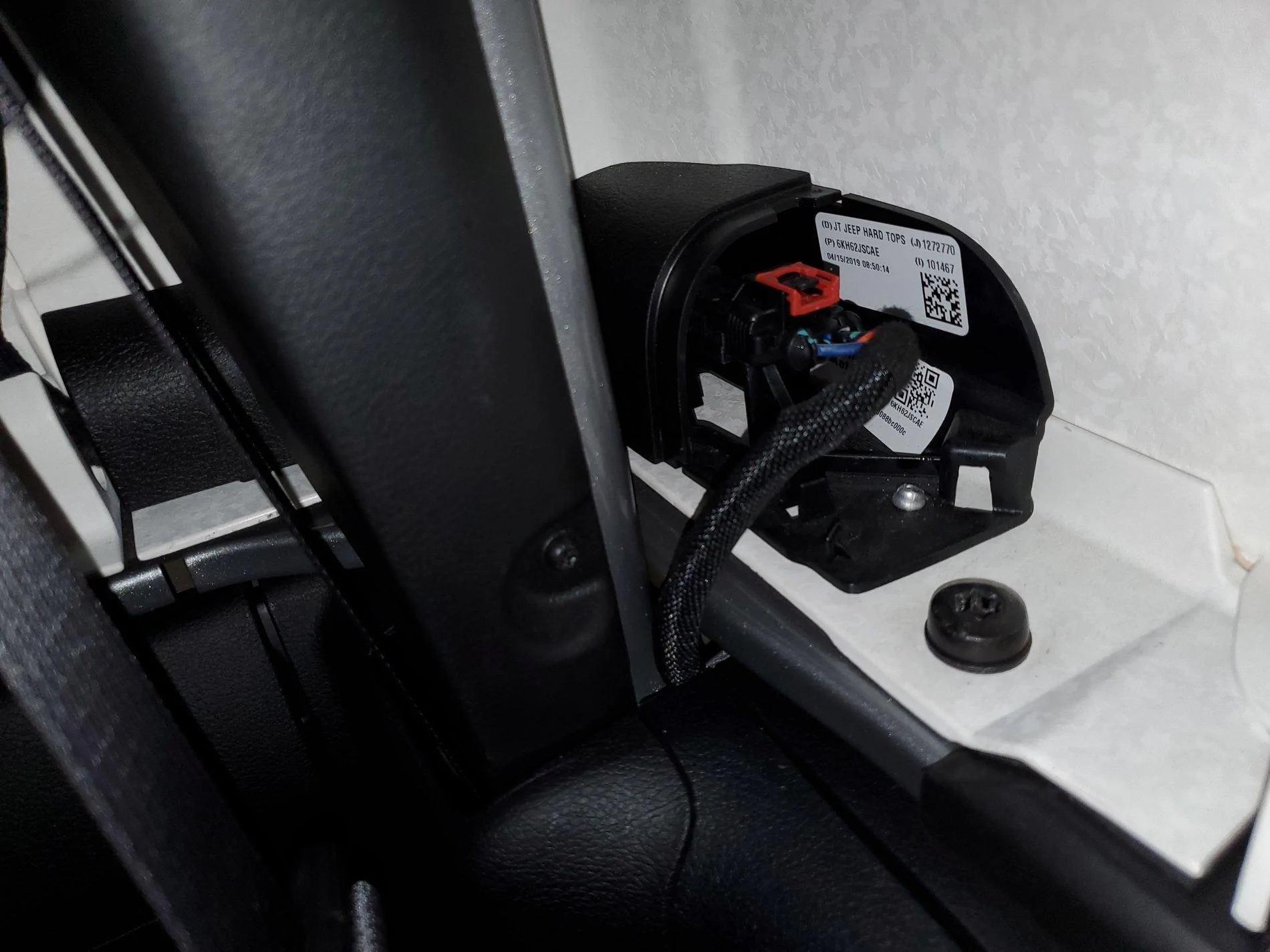

From the pictures that I found of the part you posted, I'm not sure that's it.
I need the part that covers this.
^^^This. Based on the pictures I found I believe the part listed by @Elwenil is the counterpart on the vehicle side to the part both I and @RIPLER need which is actually part of the hard top.
I replied before I saw you last posts. Thanks for the information. When I googled the part number last week it showed a picture of the other cover on the vehicle.

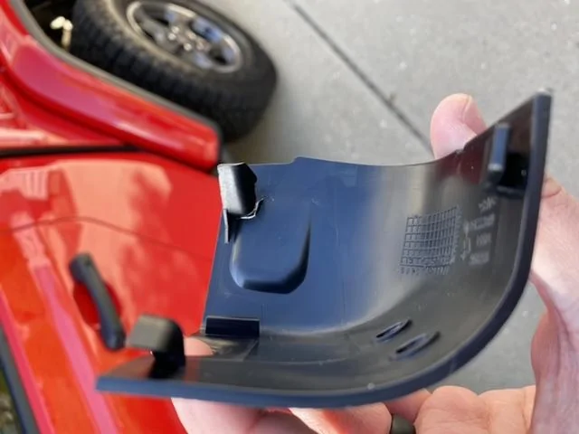

This forum rocks. First day of good weather with the roof off and I did the same freaking thing then couldn’t find the replacement part.
Thanks for your help everyone. $5 part, I’ll live.
Mine broke exactly like this one did. I think this cover needs a redesign.

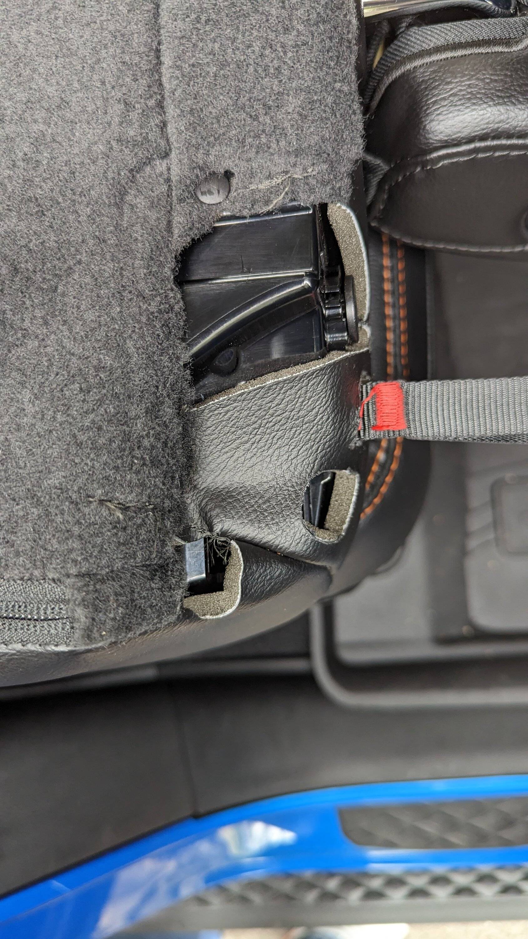

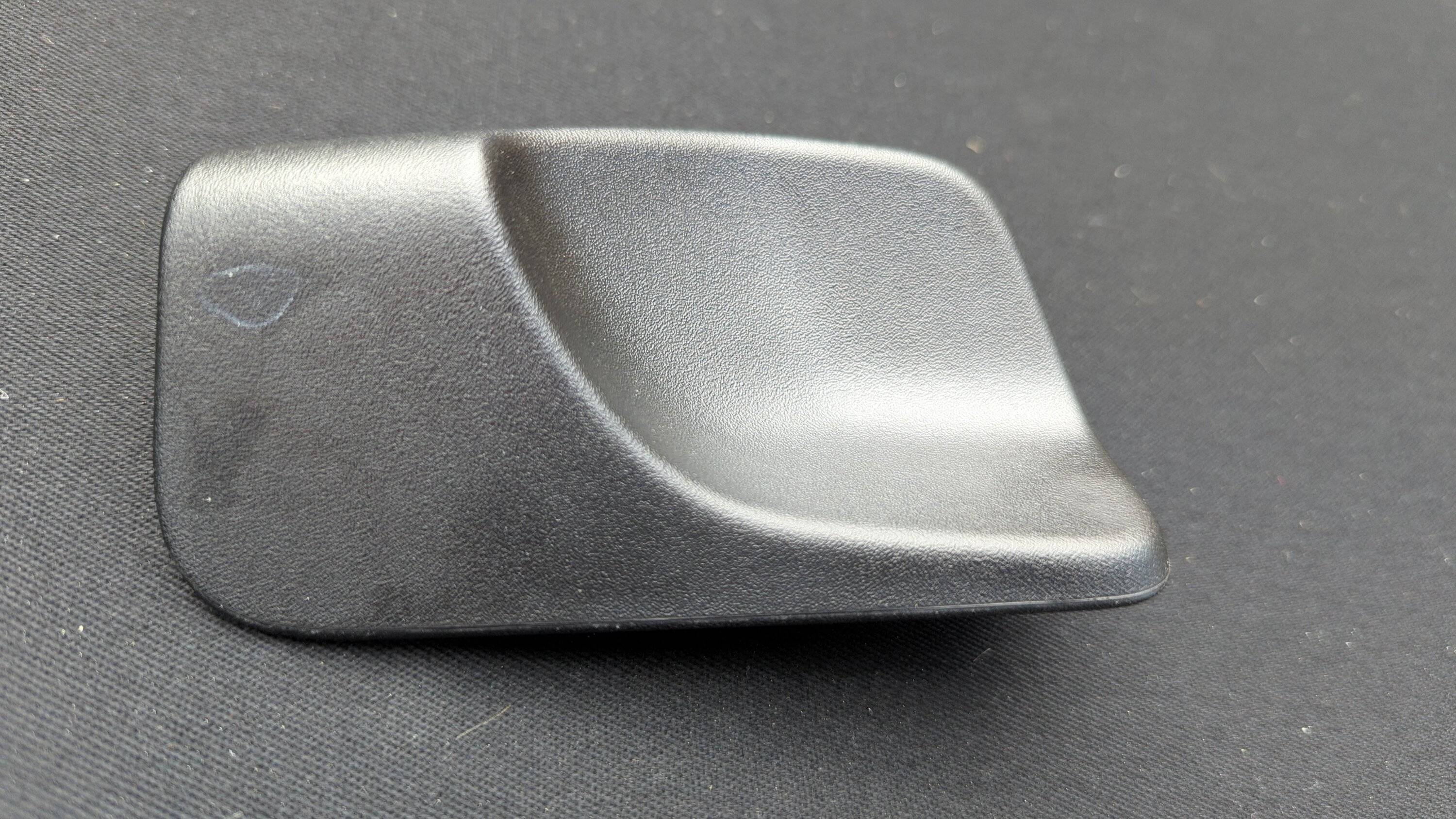

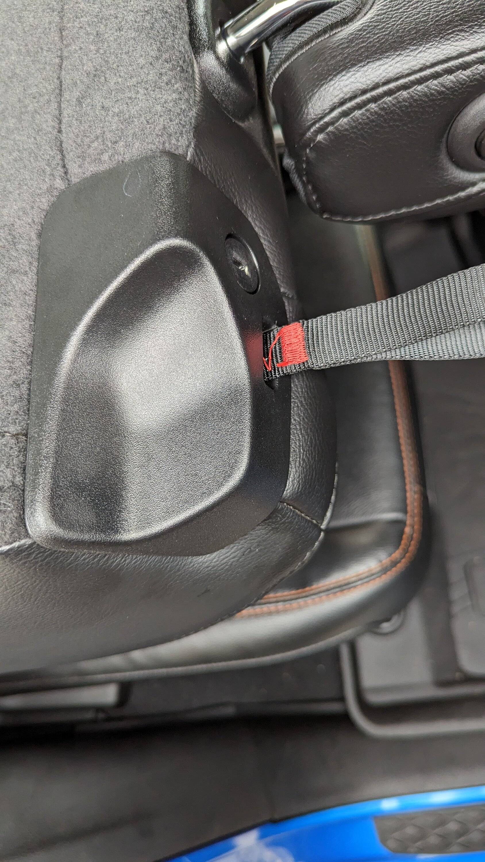

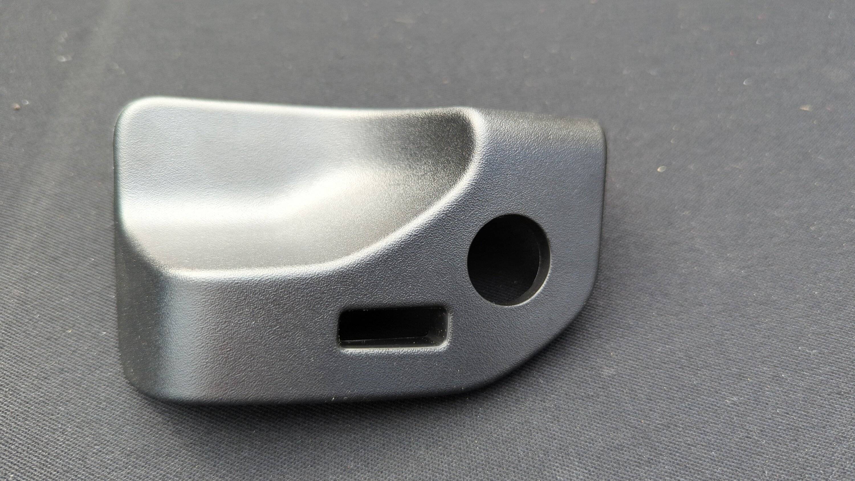

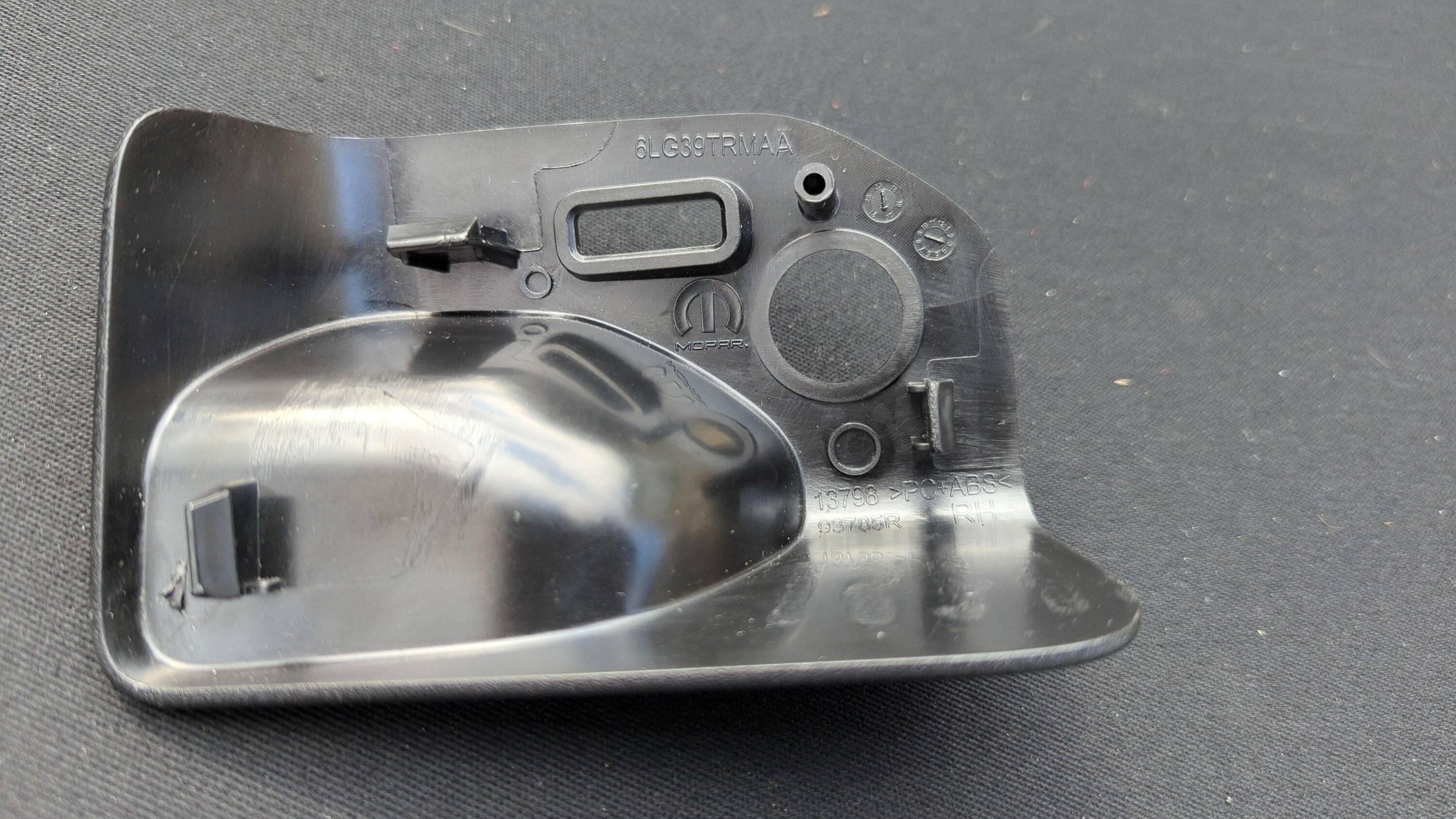

Does anyone know what this is for? Bought a new to me 2020 Mojave. This was in the glove box and I cannot for the life of me figure out what this is for?
It's got 3 different numbers on it. Mopar - 6LG39TRMAA
13798<<< PC+ABS
939785R RH
I Googled it but couldn't find anything.
Jeep Gladiator Hard top defroster plug cover 1680030072684187757928964220618
Jeep Gladiator Hard top defroster plug cover 1680030103781265077639064664026
Jeep Gladiator Hard top defroster plug cover 16800301250542237765698447225501
Any help would be appreciated.

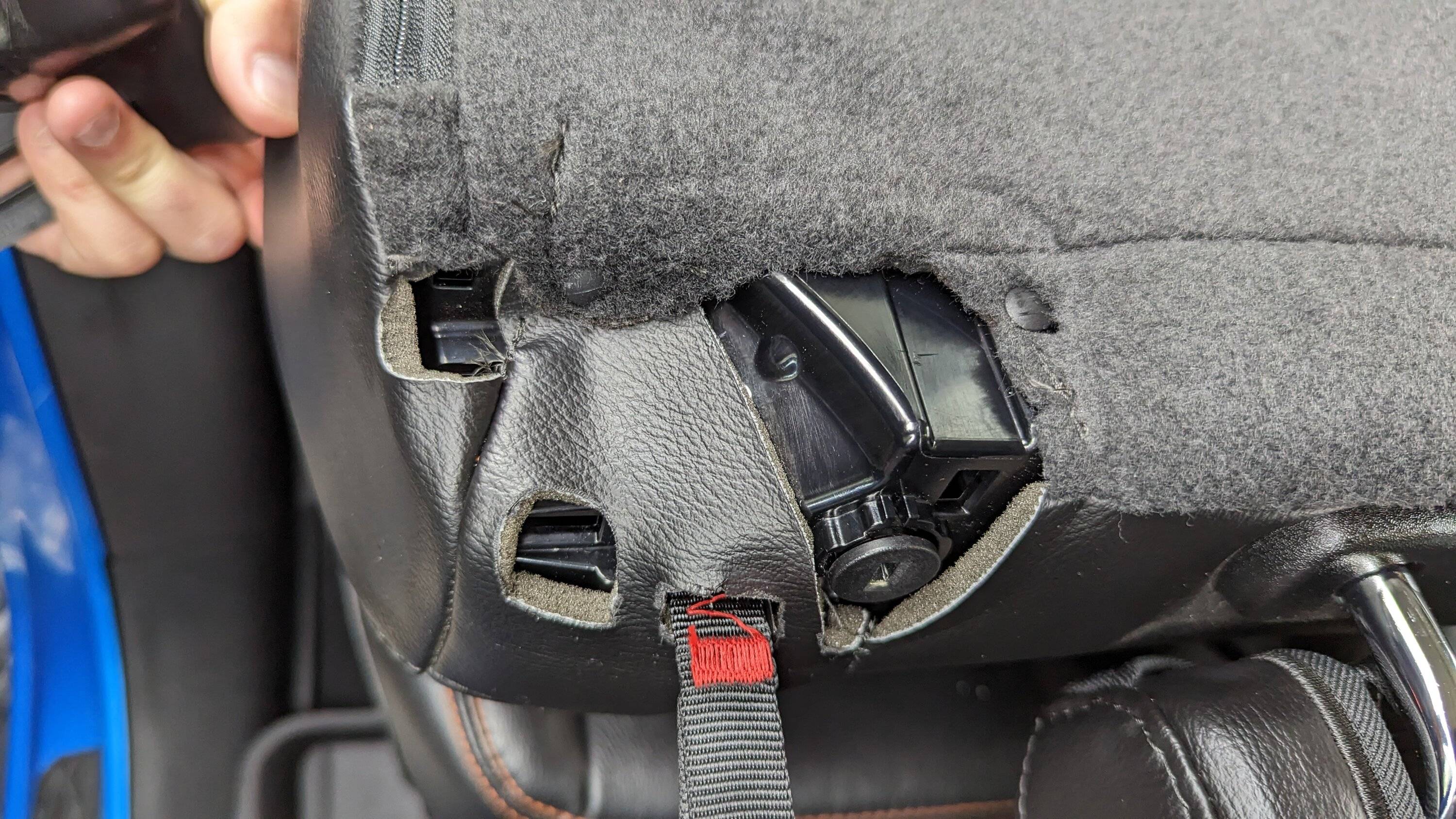

That’s a trim piece for the passenger side rear seat back latch release/locking mechanism. The loop you pull to fold down the rear passenger seat back goes through the slot and the lock cylinder fits in the round cutout.
Awesome. Thank you! It was driving me crazy.

Didn't even notice it is missing as I put my kids car seat in on that side the day I picked up the truck. I never had to use the latch. I'm assuming it fell off and the dealer just threw it in the glove box.

Took the car seat out and lowered the passenger side backseat. Low and behold the piece was missing. Was able to snap it back in place. Thanks again!
