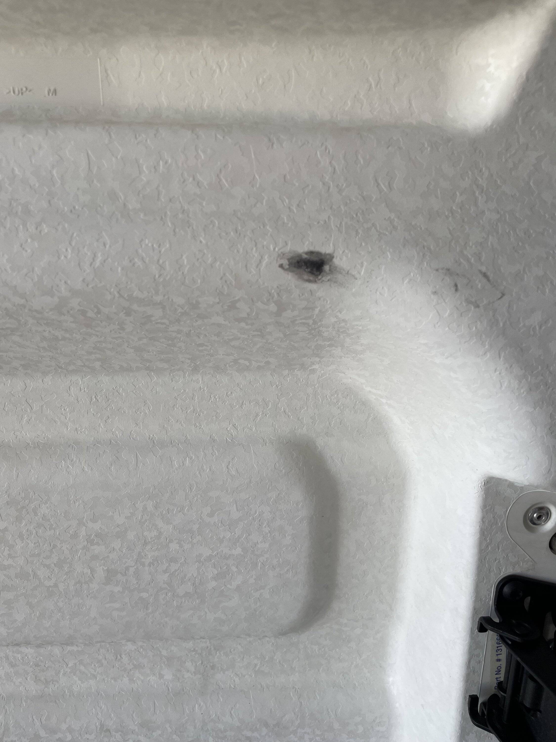

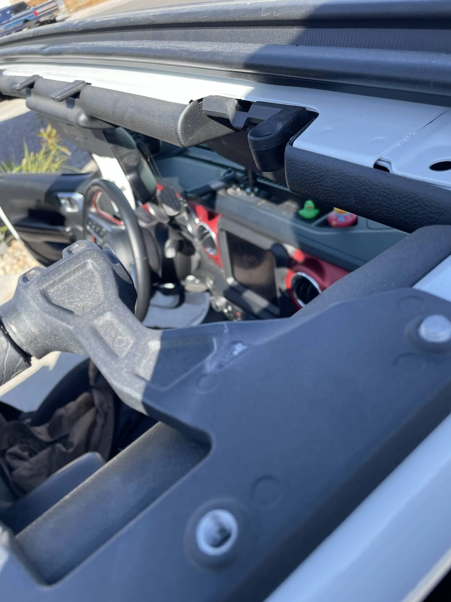

Okay found my issue… along with a loose rear portion of the hard top…. I still had the annoying squeak. I took the freedom panels off today to figure it out today and found it was my aftermarket grab handles. They’d come somewhat loose but not nearly enough to notice and the metal was hitting the freedom panel. I took some time with a rotary tool and it won’t become an issue again, even if it does loosen once again.
