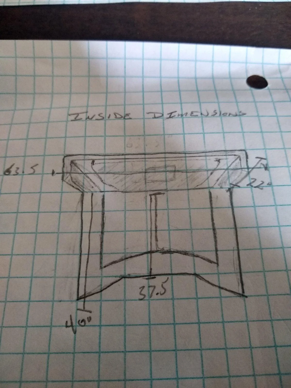

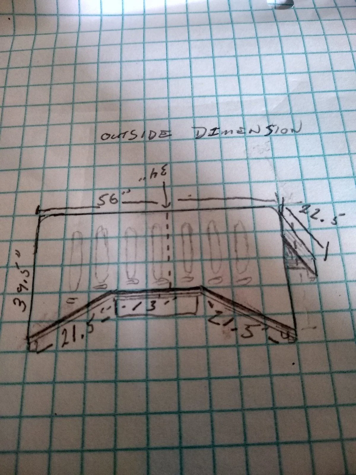

Okay, I put some numbers together:
Inside dimensions:
W: 63.5"
H: 22"
L: Long edge 40" (Center length 37.5")
Outside dimensions:
W: 56:
H: 22.5"
L: Long edge 39.5: (Center length 34")
If you also want to know the connection side dimensions they are
Left edge 21.5"; right edge 21.5"; center 13"
I hope all that makes sense. Just a note all measurements are a very close proximity and not exact. I round up to the nearest 1/2 inches if it fell between a whole number. Happy building! I'm working on a hoist as well for my top, that is what prompted me to take these measurements.

Sorry I am not an artist, I know my drawings are not to scale. Engineering is not my thing. These are very rough sketches.
They look good to me.

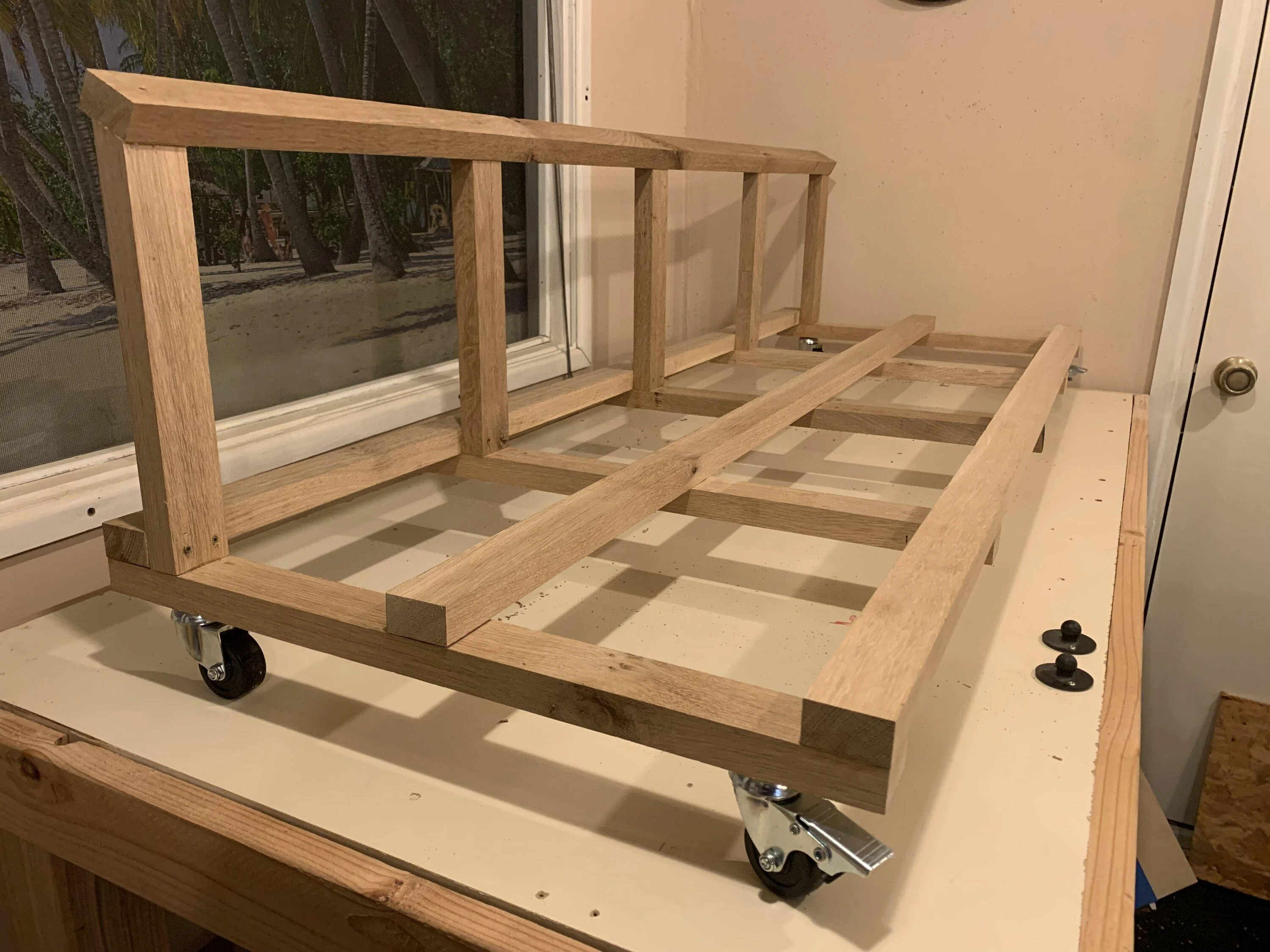

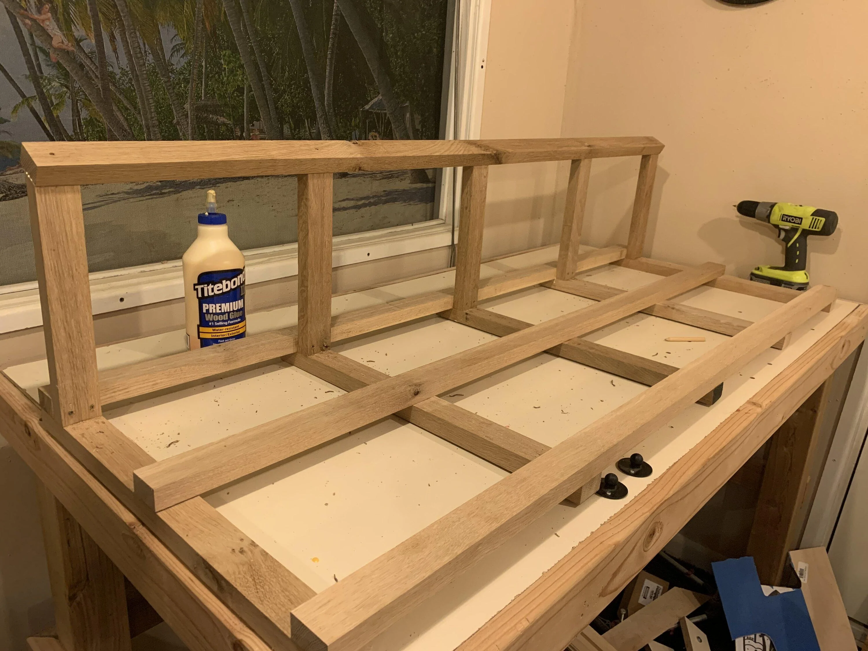

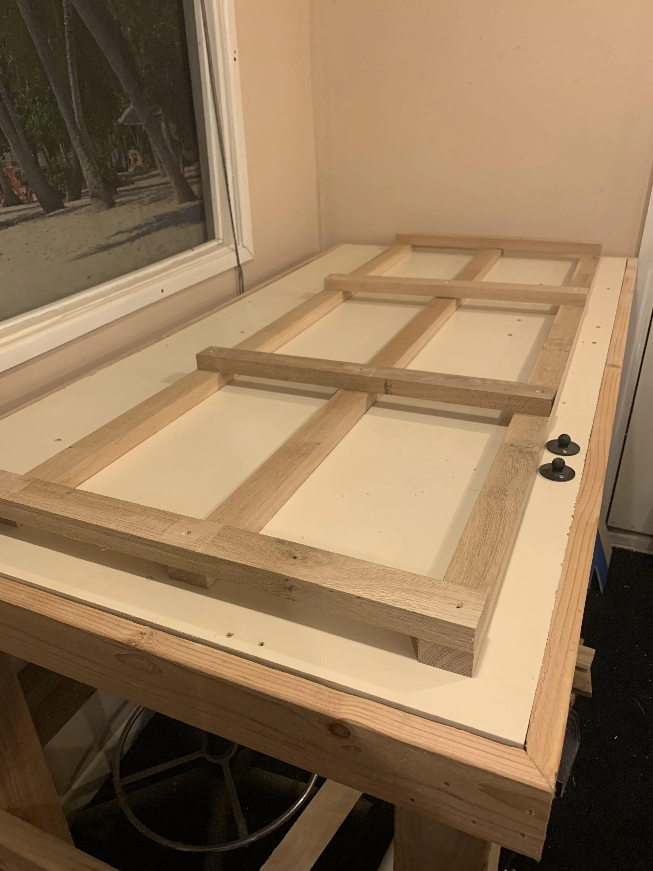

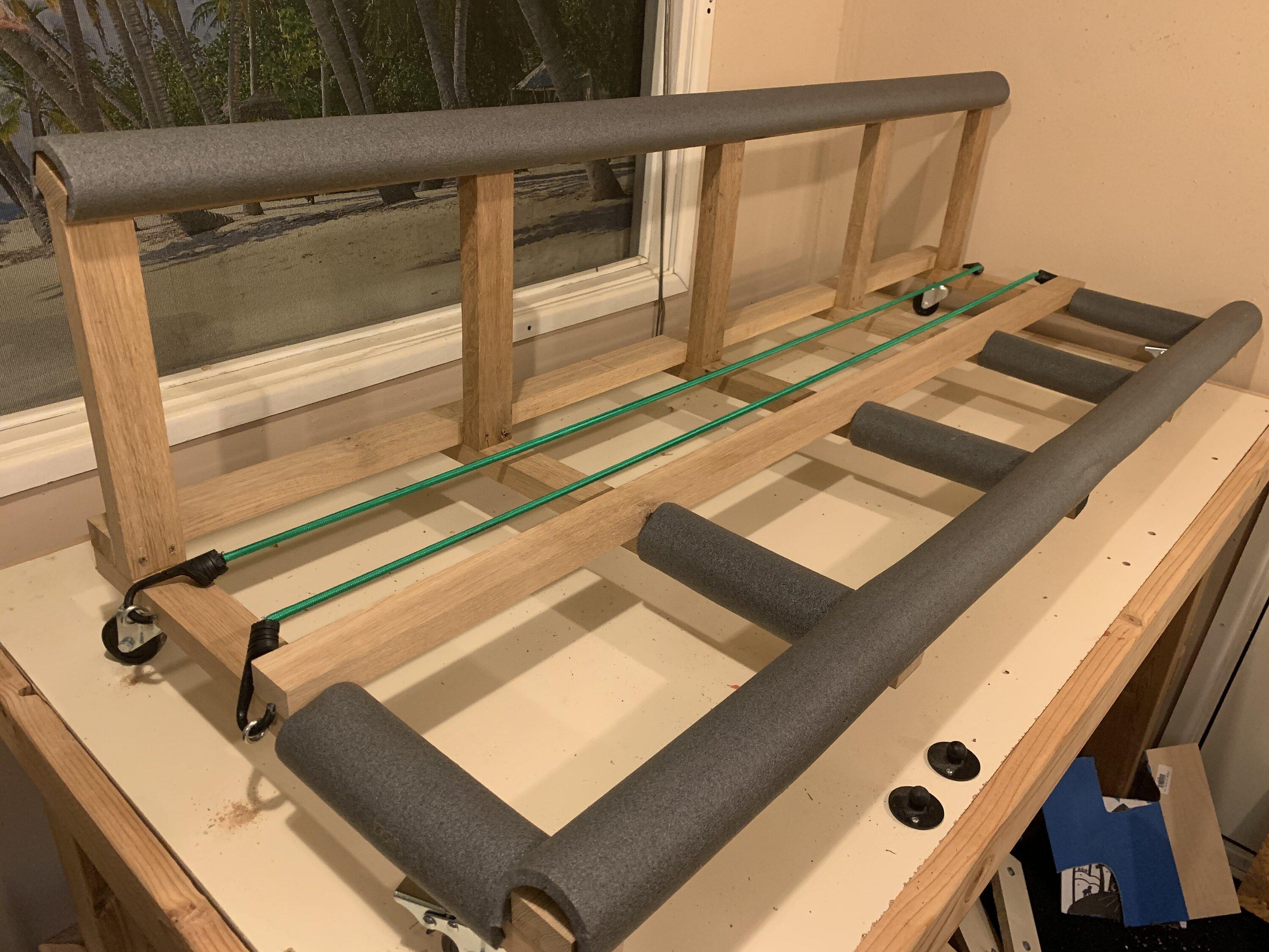

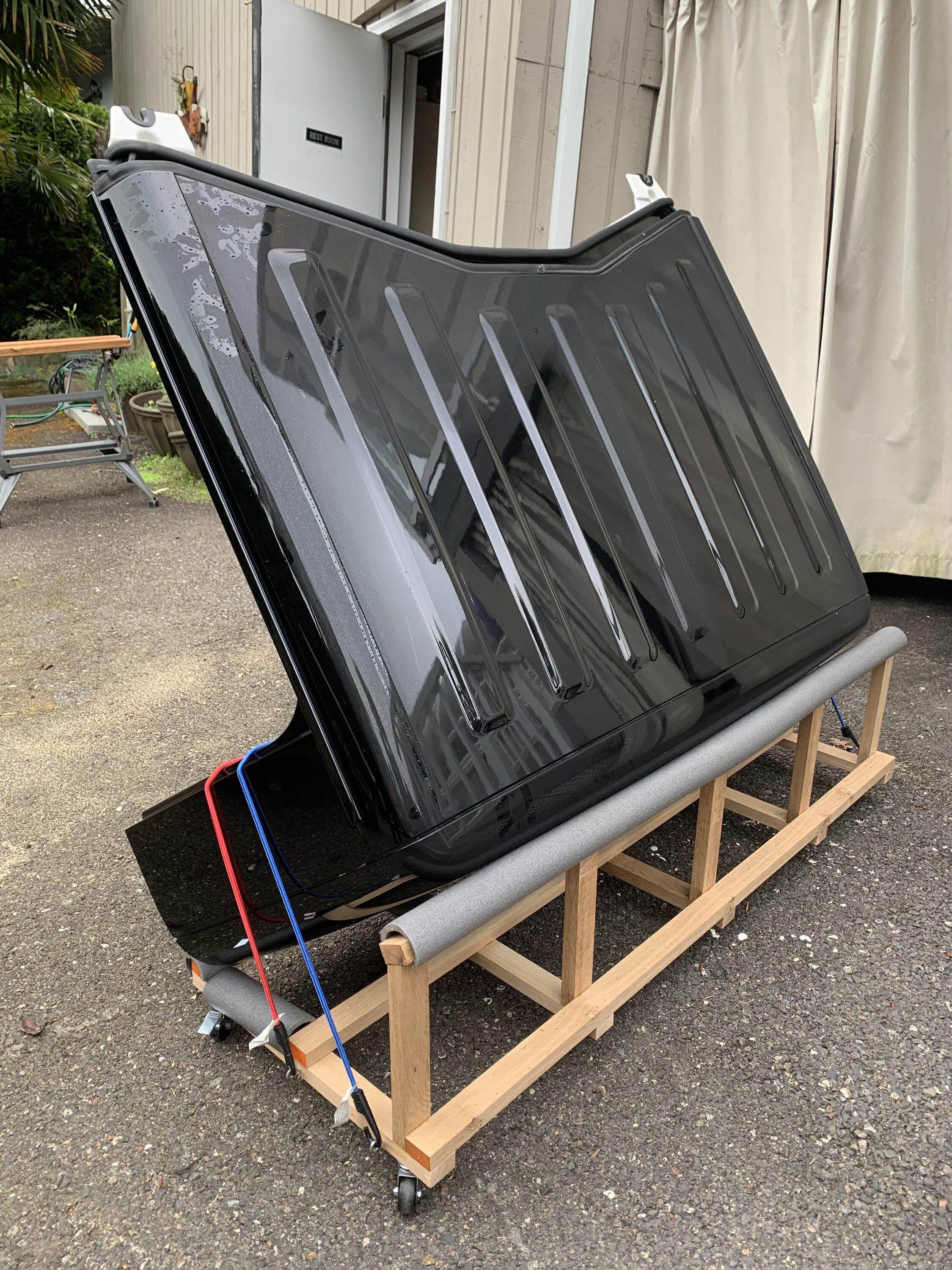

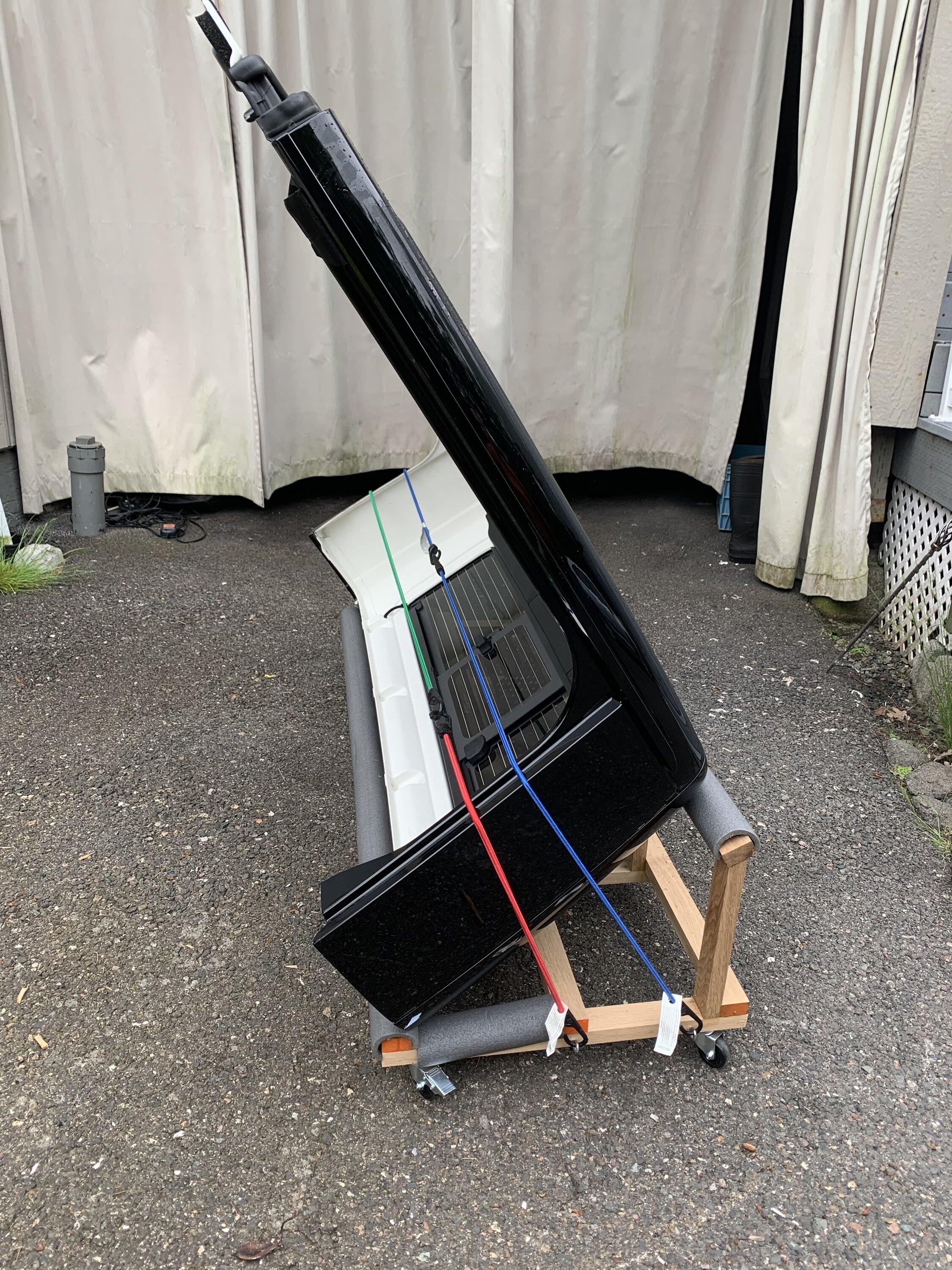

Here’s a hard top caddy I just made for my 22 Gladiator top. It’s narrow enough to fit through a doorway. I used an old supply of 1x2 oak strips. Measures 60” long x 22“ wide x 12“ tall. Glued and screwed together. Covered with pipe insulation. 4 eye hooks and some shock cords to secure the top. Simple.
