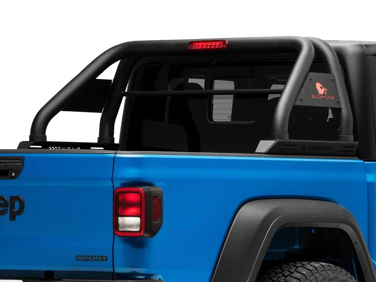

I'm looking at adding a retractable tonneau cover and a bed roll bar to my truck. The roll bar is mostly cosmetic, but also will allow me to add a light bar or pod lights. However, my favorite feature of my truck is removing the hard top and doors. Before I place an order for these things, does anyone here have a roll bar and still remove your hard top? How do you do it without a hoist system? Currently my wife and I pick it up from both sides and walk it across the bed when removing it, but we're not quite tall enough to lift it up and over a roll bar that way. I can think of a few possible solutions, but I'm curious to hear from anyone else who does it on a regular basis. One solution would be a soft top, but I'm not really interested in going down that road.

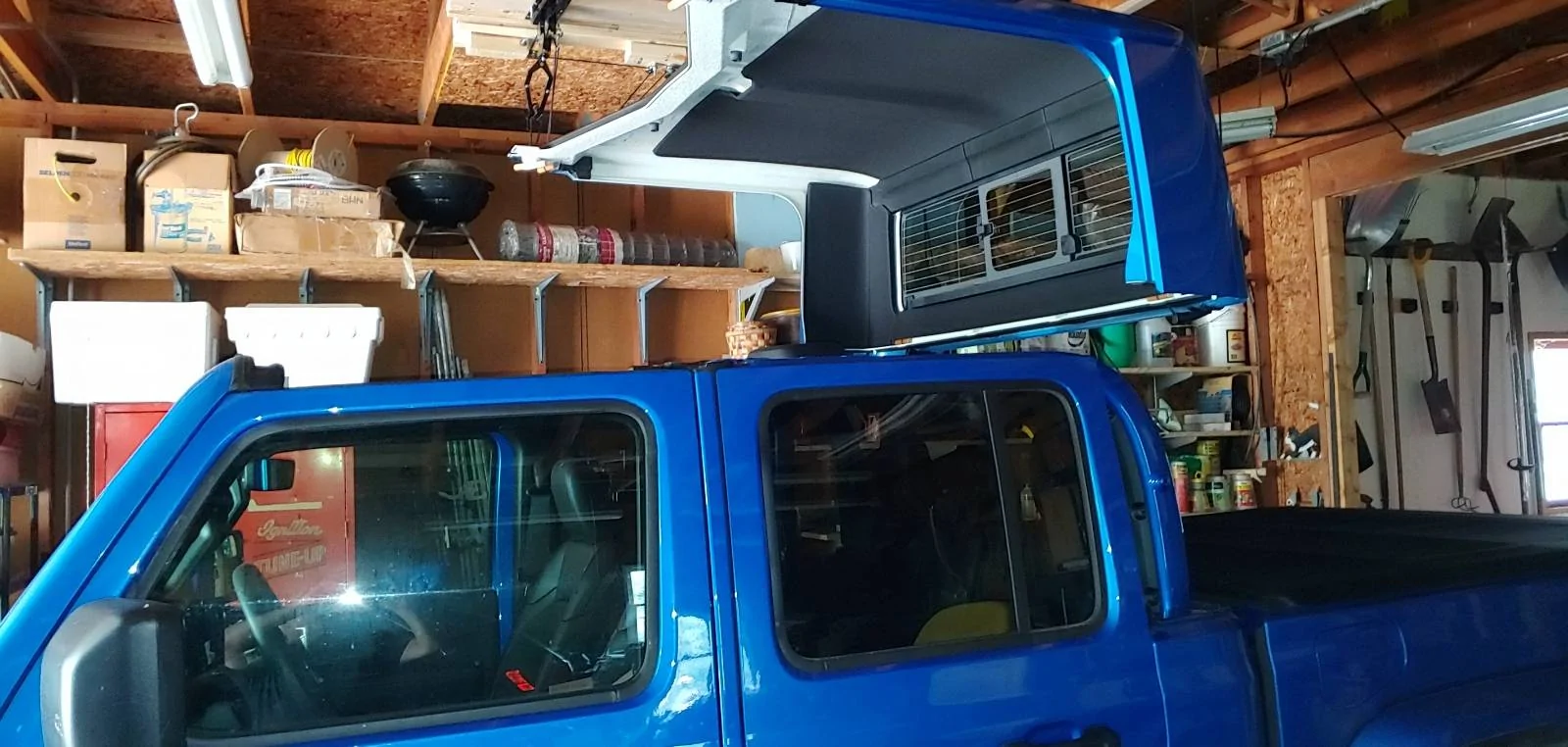

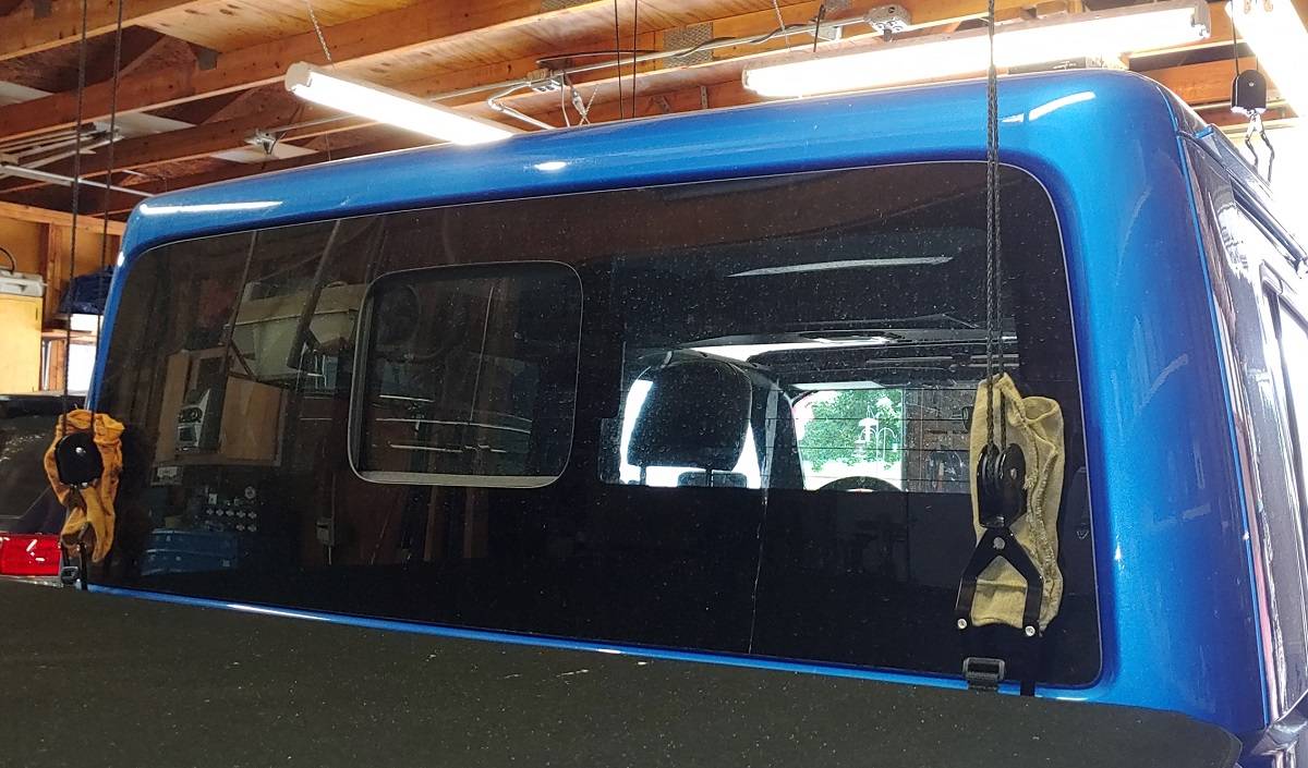

My rig would lift that top straight up without problem and leave it hanging in the garage above the Jeep.
I made my own top lift.

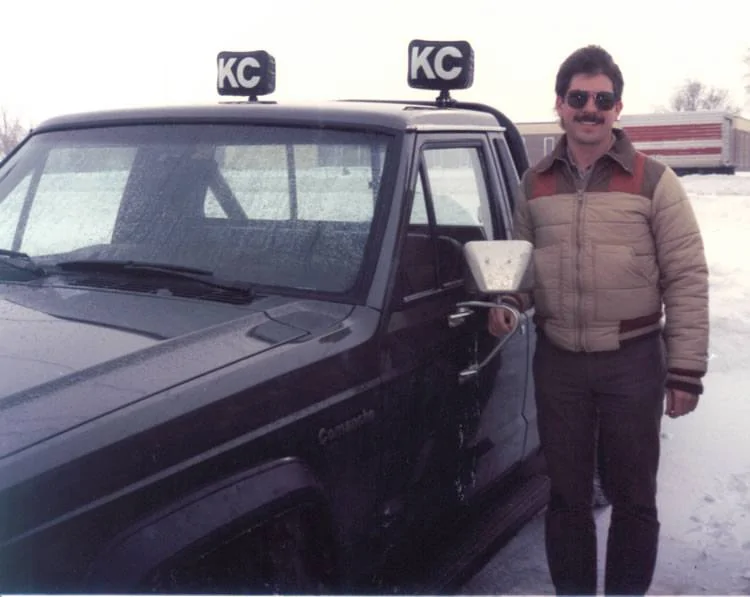

I'm fairly sure you'd not want to rely on this in event of a roll-over......... although this one wasn't attached just to the sides of the box, it did go all the way down to the bed above frame channels.
Jeep Gladiator Hard Top Removal With Bed Roll Bar? bill-1987_comanche-1988

@ShadowsPapa those hoists look like a bike hoist I have from Harbor Freight.
40,445
53,880
Close - bike hoist from Menards. Two of them. One for the rear, one for the front - cabled up with paracord and some pulleys I had one hand, going to a cheap boat winch on the wall.
Takes minutes - unbolt top, lift it up, drive away.
Back into the garage, lower top, bolt it on.
