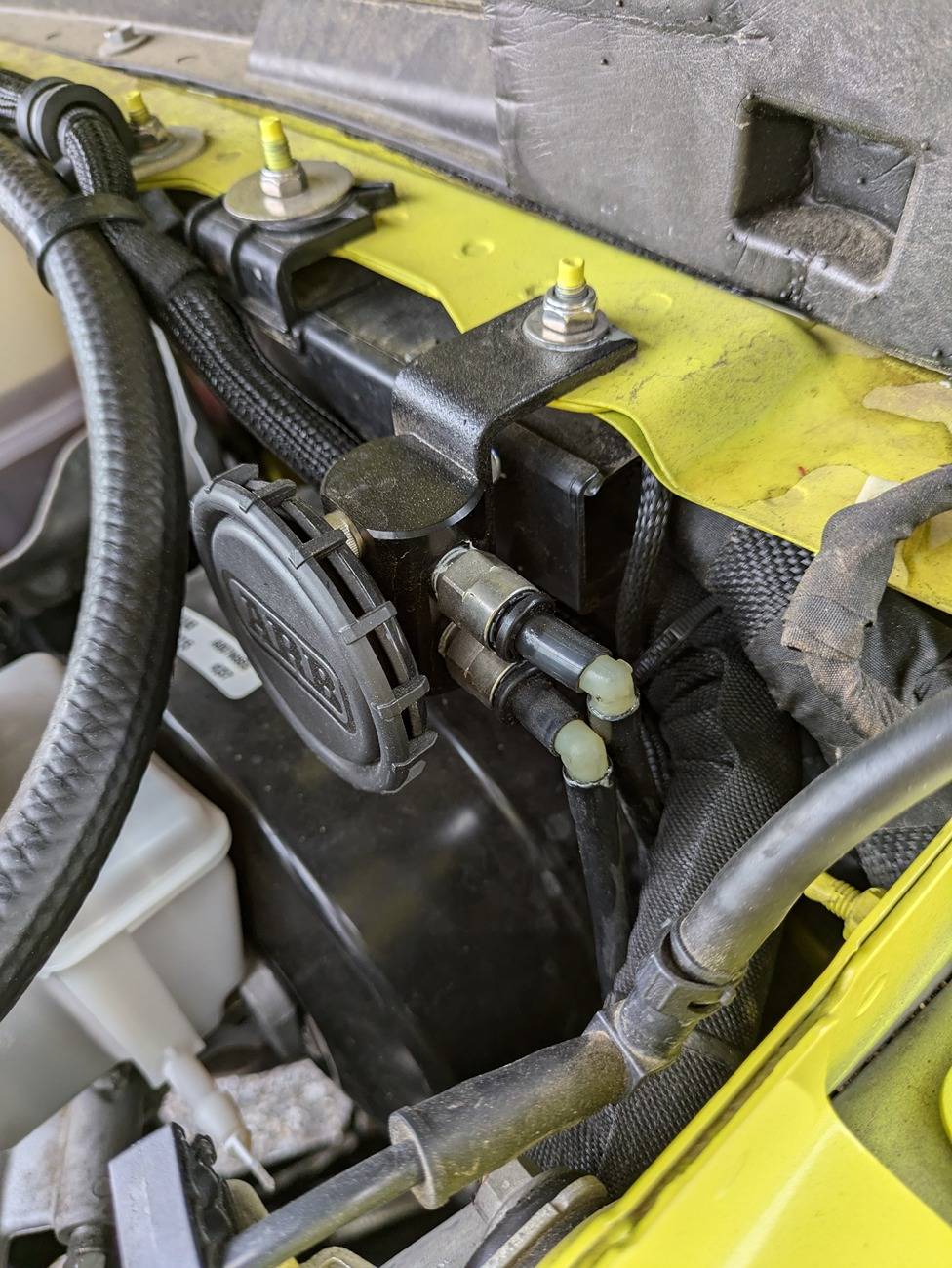

I know this is an old thread but how did you end up mounting it under the hood? I've got an ARB kit left over from a different project and thinking about putting it on the JT.
I can grab you a picture later today when I get home

Here is where it's mounted. I made a bracket and used the existing mounting stud. Been on for about 18 months now

I tucked mine under the driver's side cowl ... fits nicely
