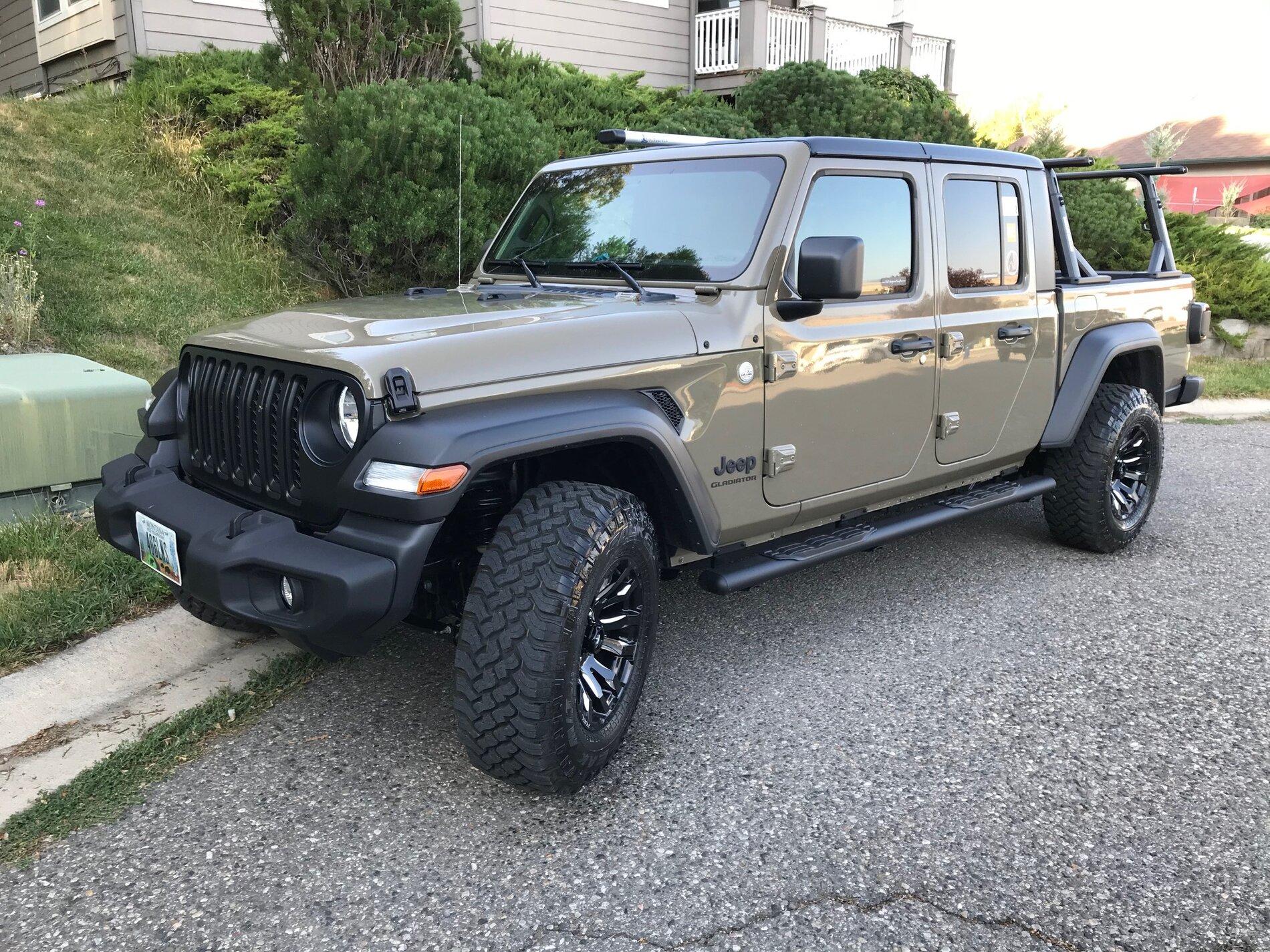

tabrods
Tom
Jun 9, 2020
81
81
MT
2020 Gladiator Sport s
This is what my black grille looks like from the dealer. I asked them to put it on when I picked up my new Gladiator and this is what I got. They also installed it for cost, no labor charge. Plus I got to keep the original grille in case I might want to change it back someday. Not a bad deal, looks great...
