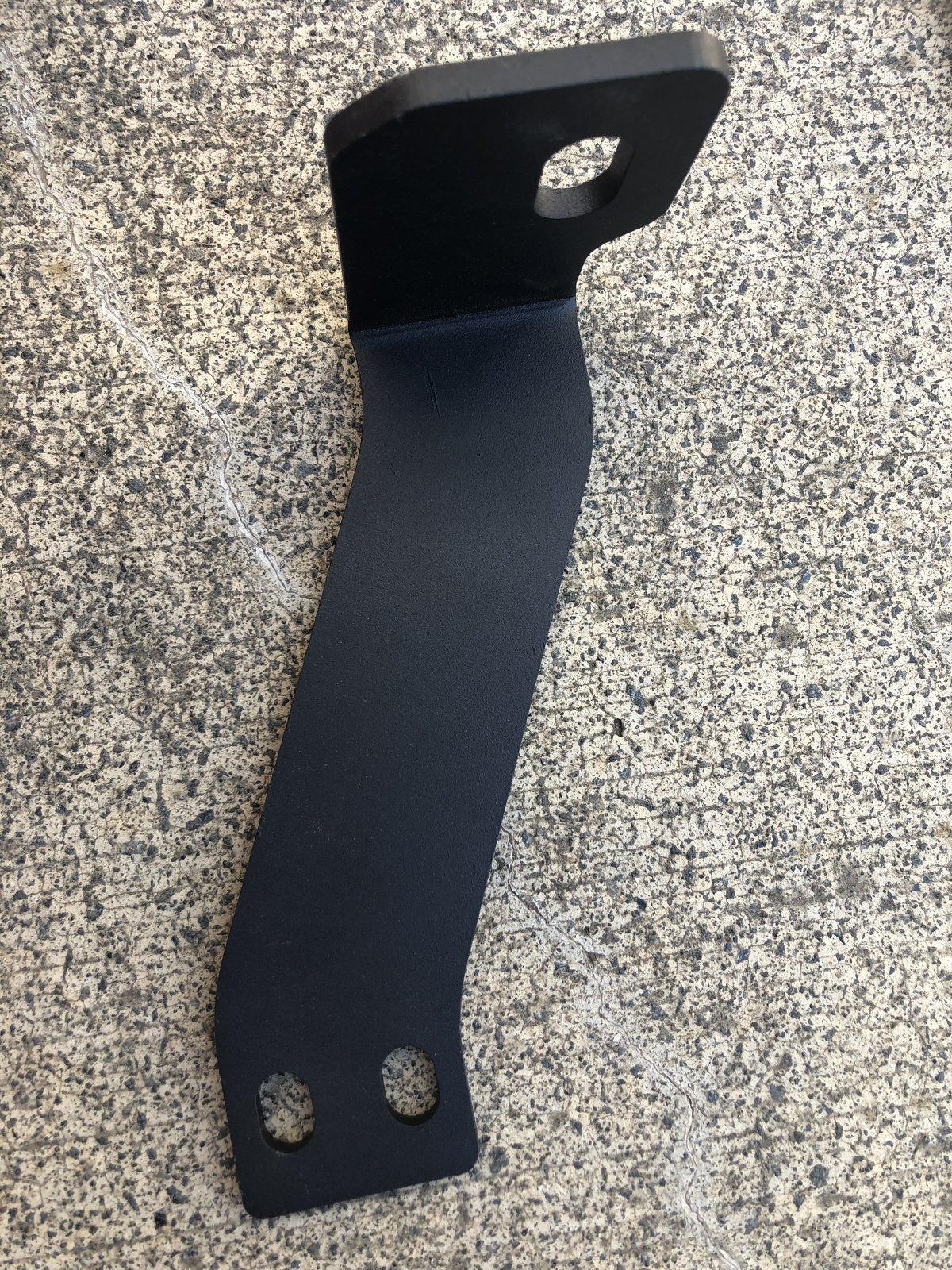

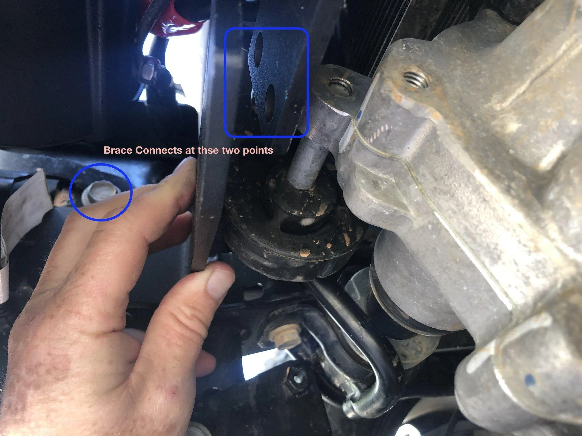

I received the RR HD Stubby Bumper. Got it nearly completely installed...attaching the last support bar. Passenger's side from winch plate to frame. Unfortunately, the Swaybar Diconnect sits about 1/4" in the way of the bracket. Is there anyway to move/adjust the position of the Swaybar Disconnet? This steel bar does not flex.

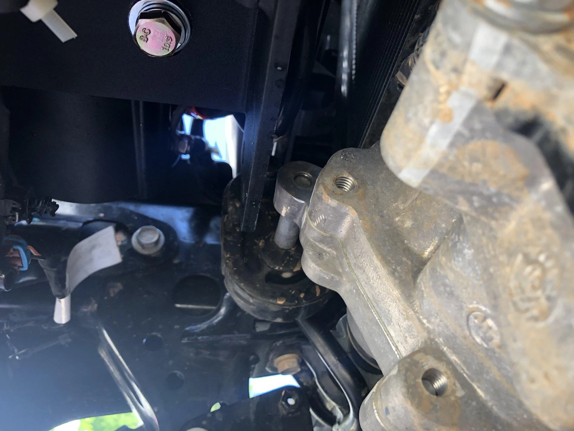

Yes. I tried Youtube even tried the manufacturer. The part they sent is supposed to work. Is there any way to turn or adjust the Swaybar Dosconnect?

I have the RR HD non-stubby bumper and the back of that bracket just touches the front of the rubber grommet on the disconnect and I didn't have to adjust anything that I recall. It seems as if the two-hole part of the bumper that the bracket should attach to is a bit further back than needed for some reason.

Well... I went ahead and installed the bracket. It pushes on the rubber grommet a bit. Maybe 5mm worth. Hopefully not going to impede any movement. I am not really sure what purpose that gromment serves. Dealership was not very helpful.
