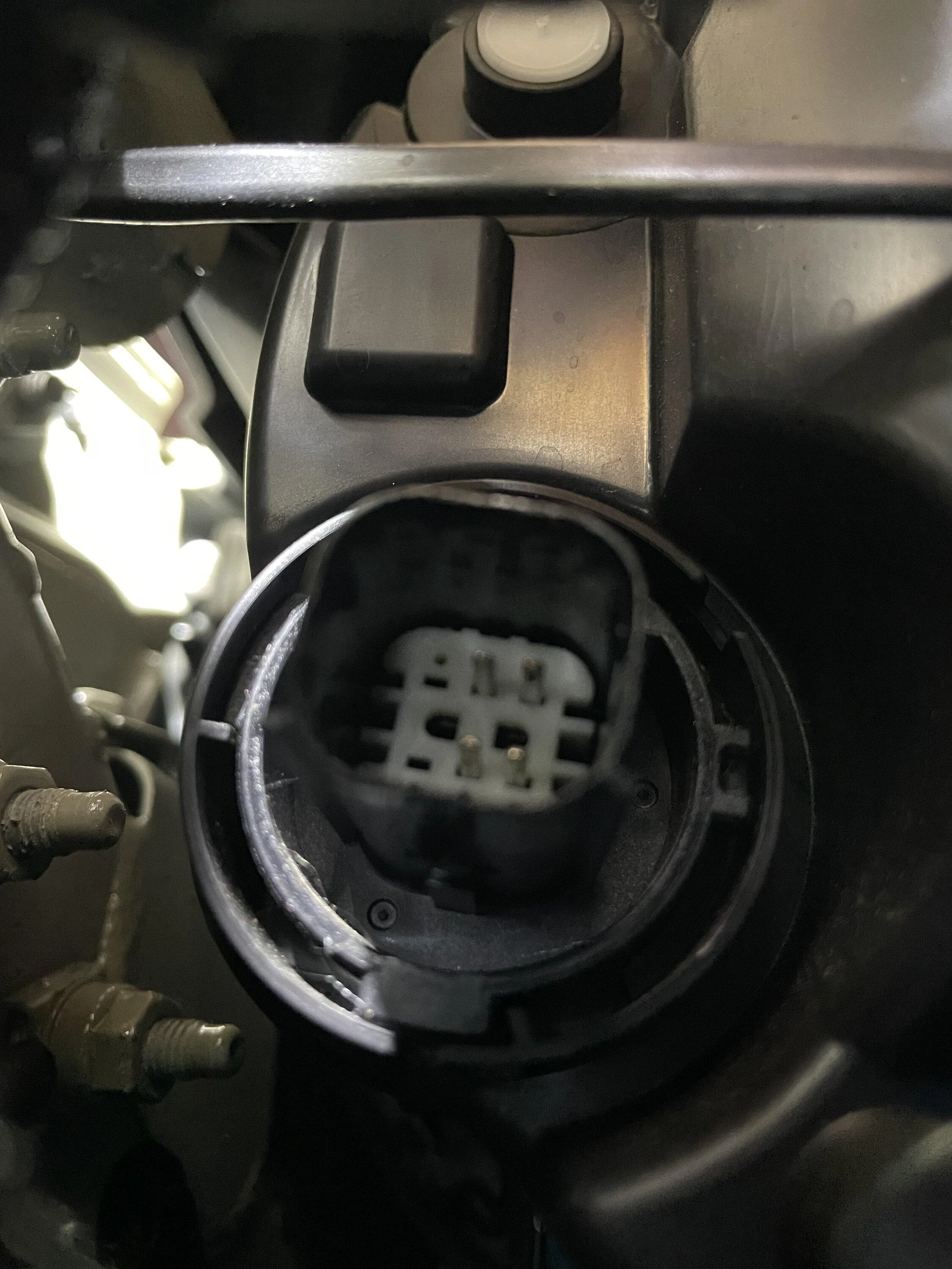

my gladiator has the oem led lights and came with them from the factory. i want to install so aux lights that will come on with the high beams and automatically turn off when i go to normal beams. i have done this on several vehicles by taping the high beam wire to trigger the relay. but i don’t want to tap the wire incase i have a warranty issue with the led light, i would prefer to get a wire that is basically a short extension from headlight to the oem headlight wire and tap it. does anyone know what that connection is called on the oem led lights? i plan to use the aux switch as the power source and headlight for trigger so they will not run on the street unless i push the aux switch but i will be able to instantly turn them off if i meet another vehicle on the trail. thanks guys

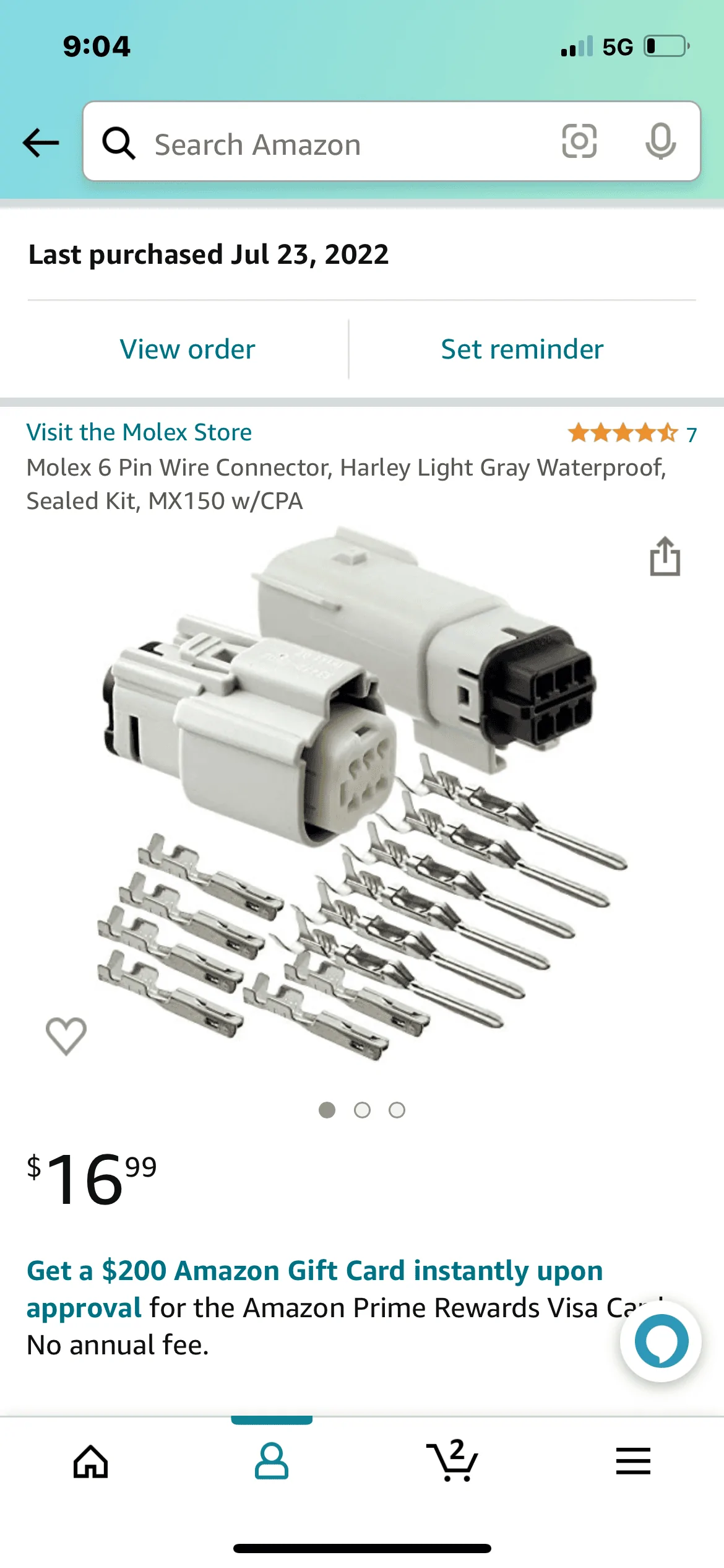

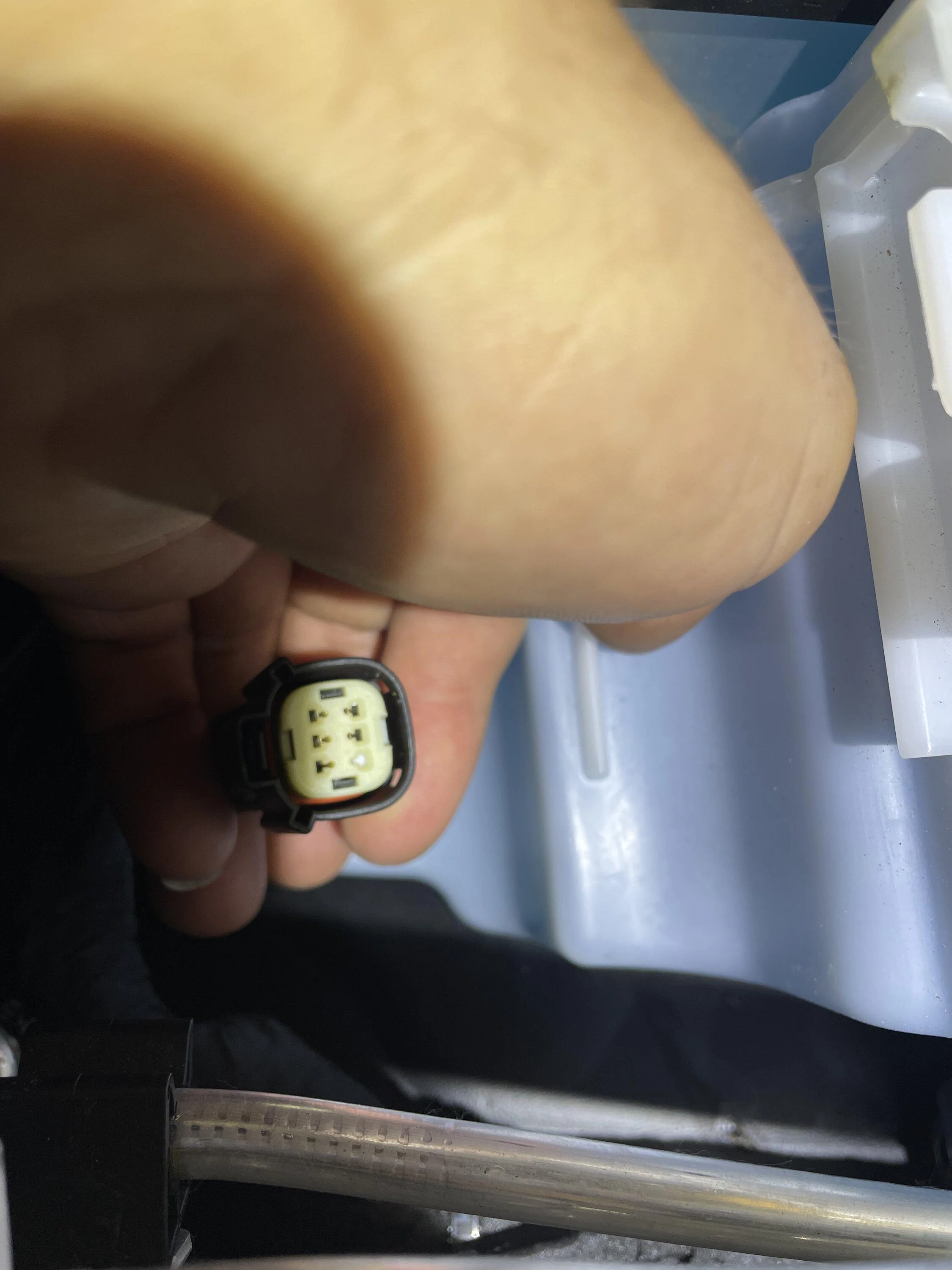

i was able to get a decent look at my led headlight which were installed at the factory. it has 4 wires run to each lamp and i believe the connection is a molex mx150 6 pin. i ordered a set of them to make my own extension cord. i will update on my progress if anyone is interested in this style of light trigger. i have always like it.
