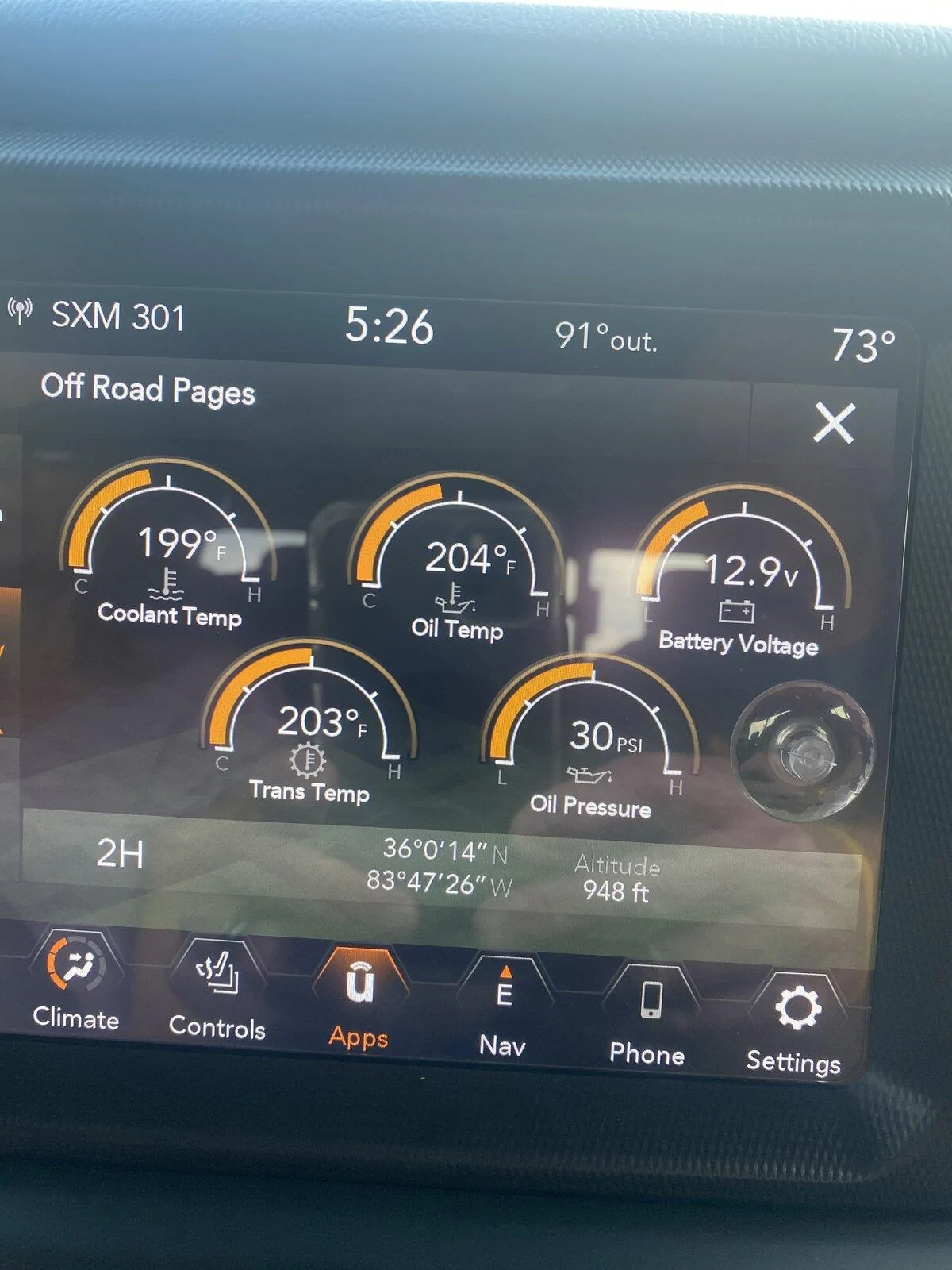

First couple hour trip in 2021 Mojave. Every so often getting moist hot air coming from floor board area. AC is on vents are cold. Temps look good for vehicle.
Help
Running the AC whether it was 70F or 100F+ outside regardless of AC temp setting (AC not in auto mode) I also experienced hot air blowing from the passenger side floor area. This would happen randomly with city driving or cruising at highway speeds (kept it in the double digits).
Today, per my request (from forum suggestions) the dealer reprogrammed per TSB 24-007-19 and TSB 24-007-21.
This seems to have fixed the problem, I will advise if further driving reveals otherwise.
