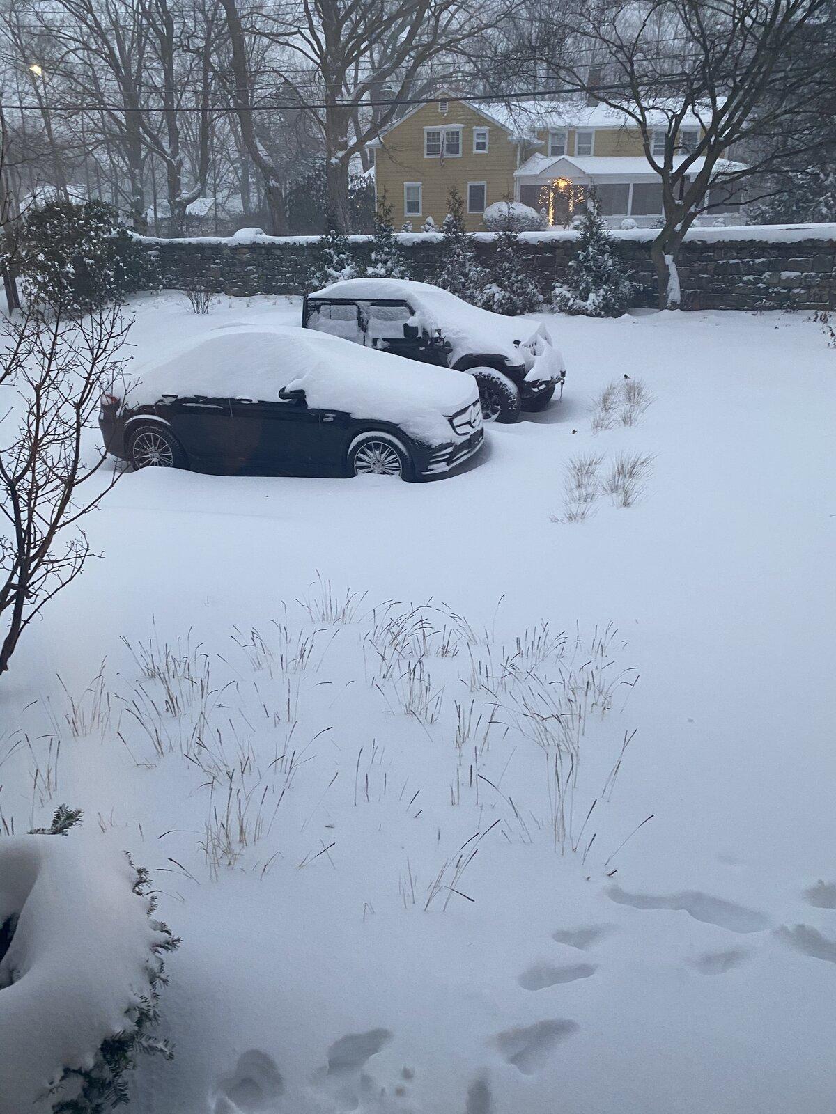

Personally, I love this feature. I am remodeling my garage and the JT and wife’s MB are parked outside. I hit the remote start when it is cold, five minutes later when I get in it is already nice and toasty. Then I turn it off. It’s nice when the weather goes from this to this in 24 hours.
