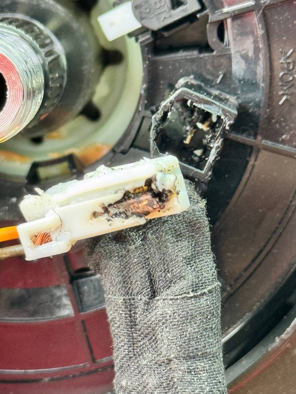

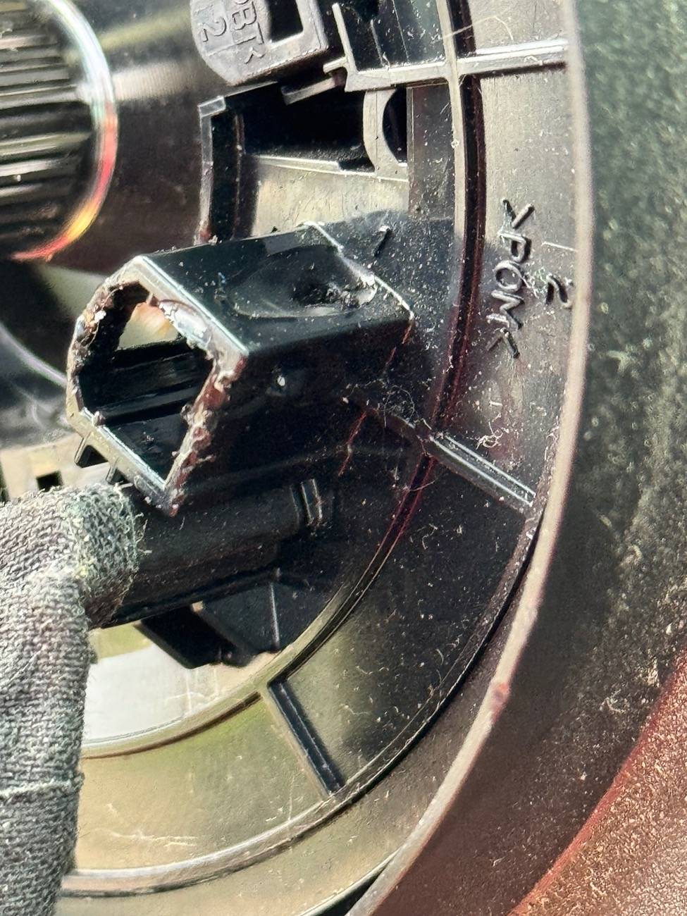

I’d say I found the source. The connectors were pretty much fused together, took some work to get them separated. Looks like I’ll be replacing the wheel and harness.

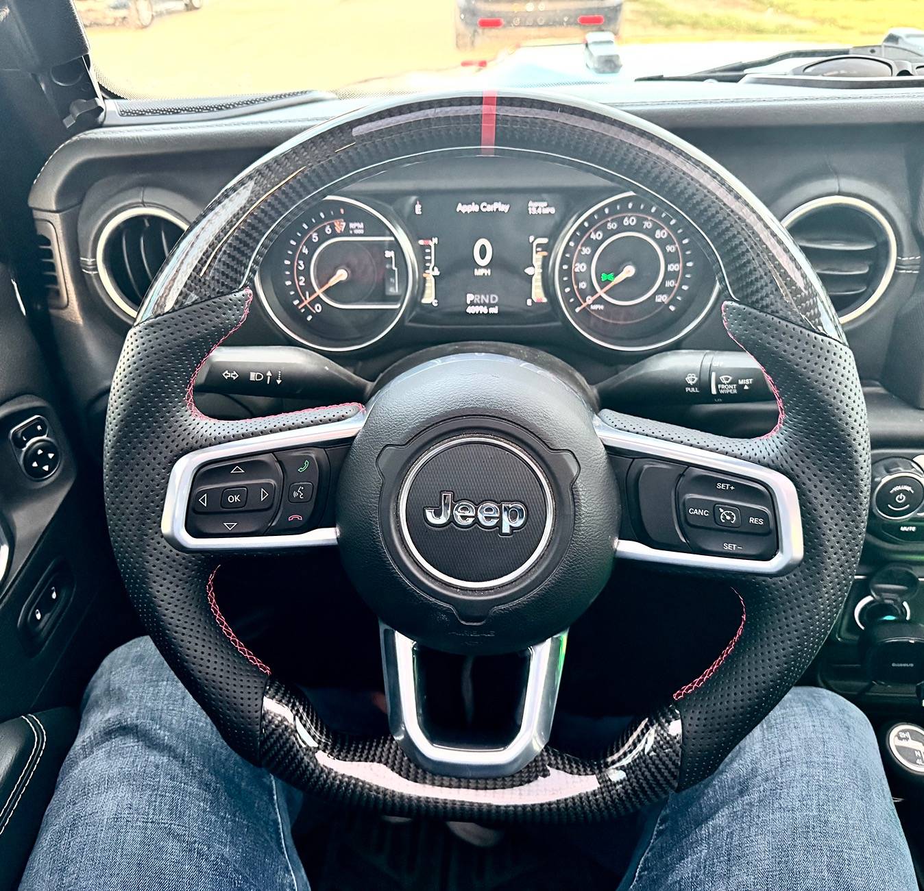

Well, $300 later for a new wheel and wiring harness and I’m back in business, heated grips and all. Not a mod I was planning on doing but it is a pretty nice upgrade over stock. Fortunately I was able to reuse the clockspring even though the connector was partially melted/damaged. That would’ve been another $275.
