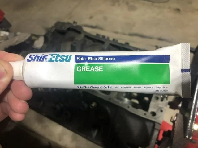

Deleted member 33157
Check where the posts go into the holes and lube them with silicone.
