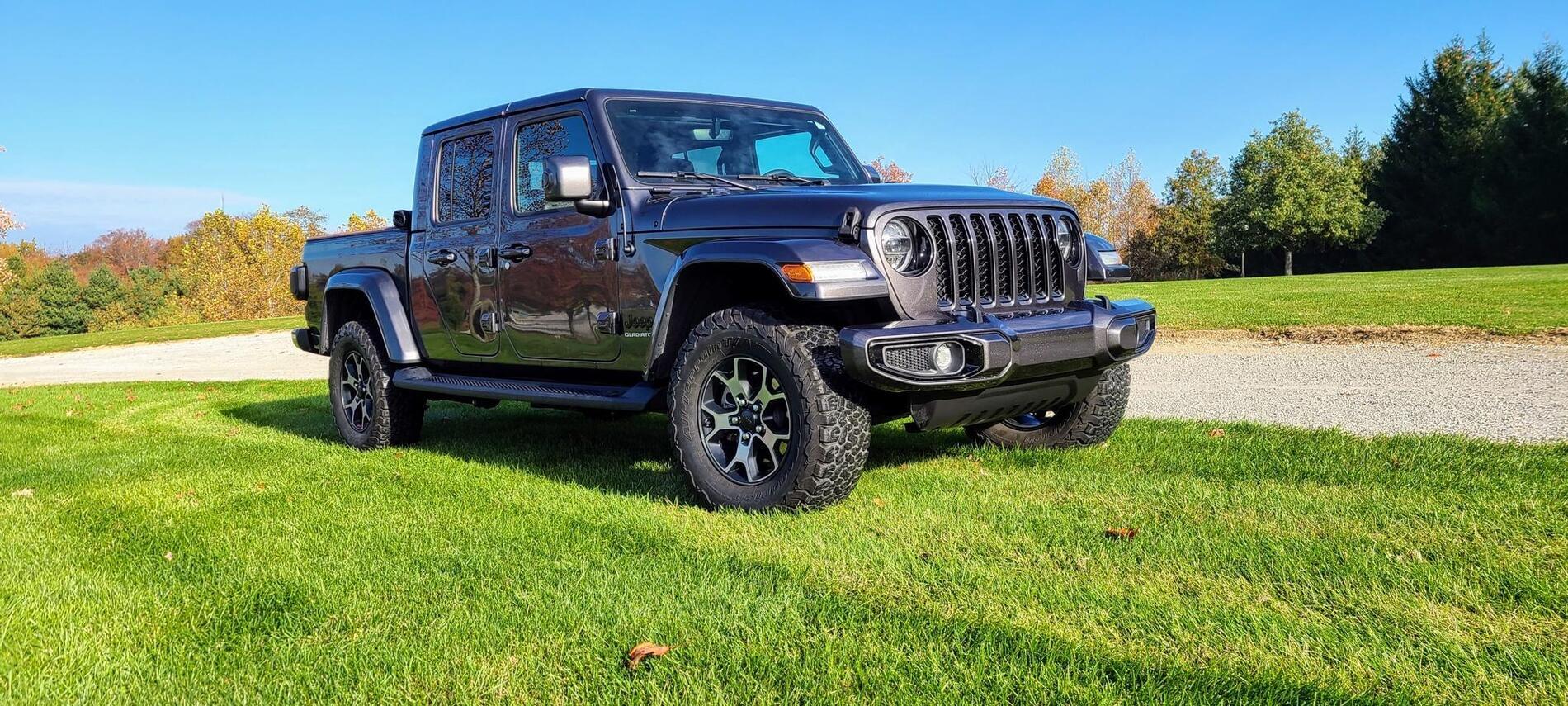

I‘ve had a High Altitude diesel in granite crystal for about two months now. Love it but need something better in the tires department when winter comes or when I decide to take this thing off-road. The factory Dueller H/T’s on 20” rims are nice on the road but are gonna suck in the snow.
I’ve got Baseline 4x4 Outfitters fairly local to me and Tony said he’d hook me up with a set of Rubicon wheels and BFG TKO2’s from a JKU. They’ve only got 2700 miles on them so I think as long as they will work I’m going to jump on them. Any reason they won’t work? Will I have to mess with the speedometer calibration? These have the TPMS in them. I’m assuming they’ll sync up to my Jeep fine? I’d probably just put them on in the fall and pull them off in the spring unless I really like the look…..
Also, if anybody has pictures of High Altitudes with Ruby wheels I’d love to see them.

Yes it did. Worked out great! Ended up with a set that had about 20k miles on them. TPMS synced right up and no issues with rubbing or anything else. Ended up buying all five and swapped out the spare as well. I’m planning on switching back to the HA wheels and tires in April or so.
Jeep Gladiator High Altitude with Rubicon wheels and tires.  Problems?  Also, pictures if possible MD8i1ic
