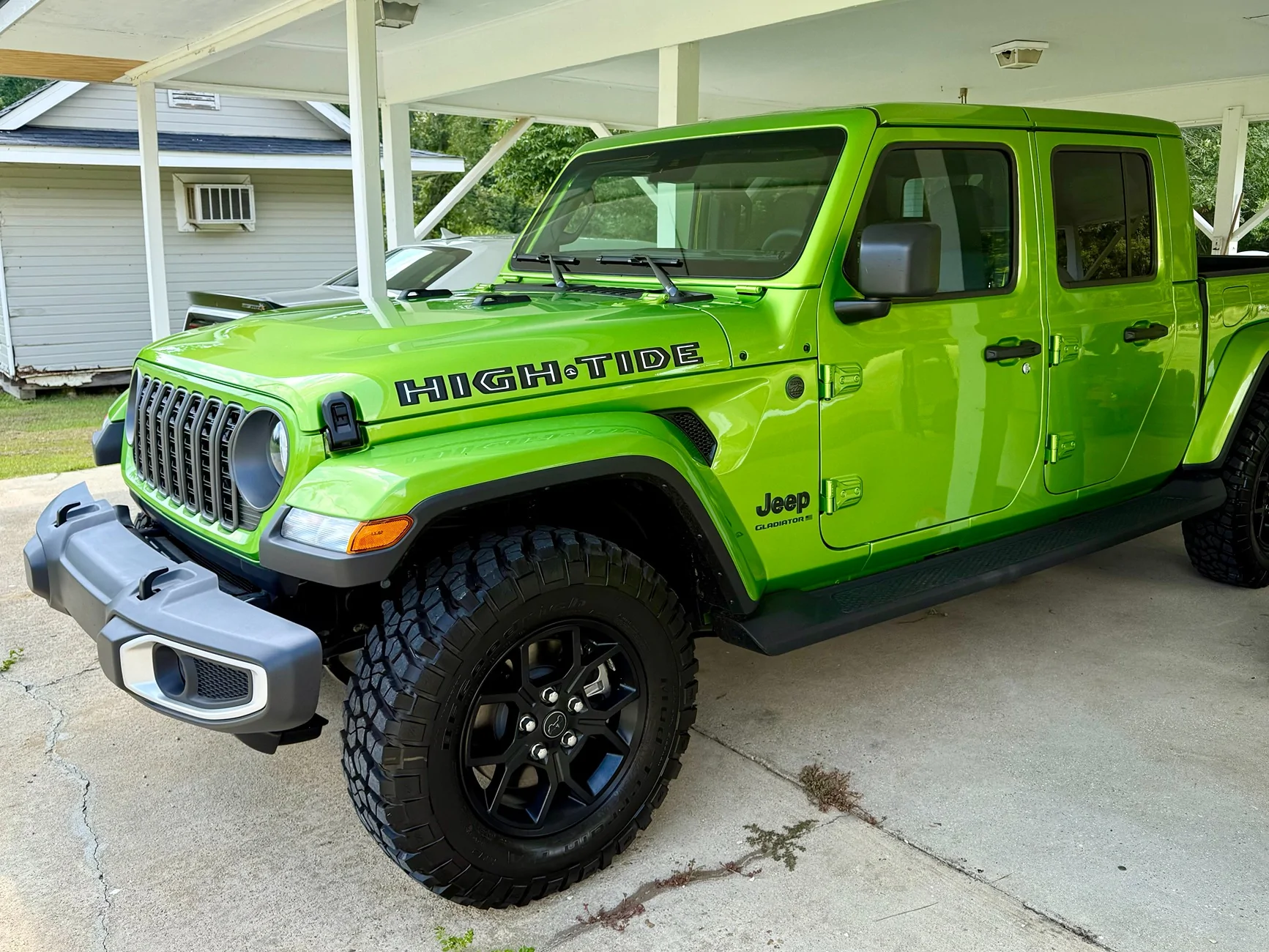

I never made a post for my new tires and wheels, so here we go. I started with Icon Vector 5 wheels in satin black (17x8.5 with a -6mm offset). I liked the stock wheels, but they're out of spec to run true 35-inch tires.
For tires, I went with a set of Mickey Thompson Baja Legend EXP (35x12.5), including a spare. I think I'm going to move the spare to a bed mount soon. I was glad to get the mud terrains off; the new tires ride great. I should be getting the JKS 3" lift installed tomorrow.

Great stance. Those wheels look very similar to my Fuel Rebels. 35" tires, but what lift do you have in this picture?

Yeah, the main difference in the wheels is that I didn’t want a bead or rivet look along the lip. Otherwise, they do look a lot alike.
In this picture, all I had was a 1.5ā€ Daystar spacer on the front. Trust me when I say the angle of this picture is really misleading, though. It still had a little bit of rake when you looked at it from the side. It’s weird how the angles on these trucks work in different pictures.

I like a little rake and have been kicking around 35" tires. I know I'll need at least a 1.5" inch spacer in the front to allow 35" tires. I have a '24 Jeep Beach which I believe is a similar spec to your High Tide. This gives me a great idea of how it'll stand. :beer:

There was no rubbing with those little spacer blocks for me, either. I have the wheel width and offset and all in a previous post if you need to reference any of it.
I think your main options are to get the Teraflex spacers, find a similar one on Amazon, or you can do like me and find the Daystar version on eBay since they don't seem to make them anymore. They're all probably about the same, though.
