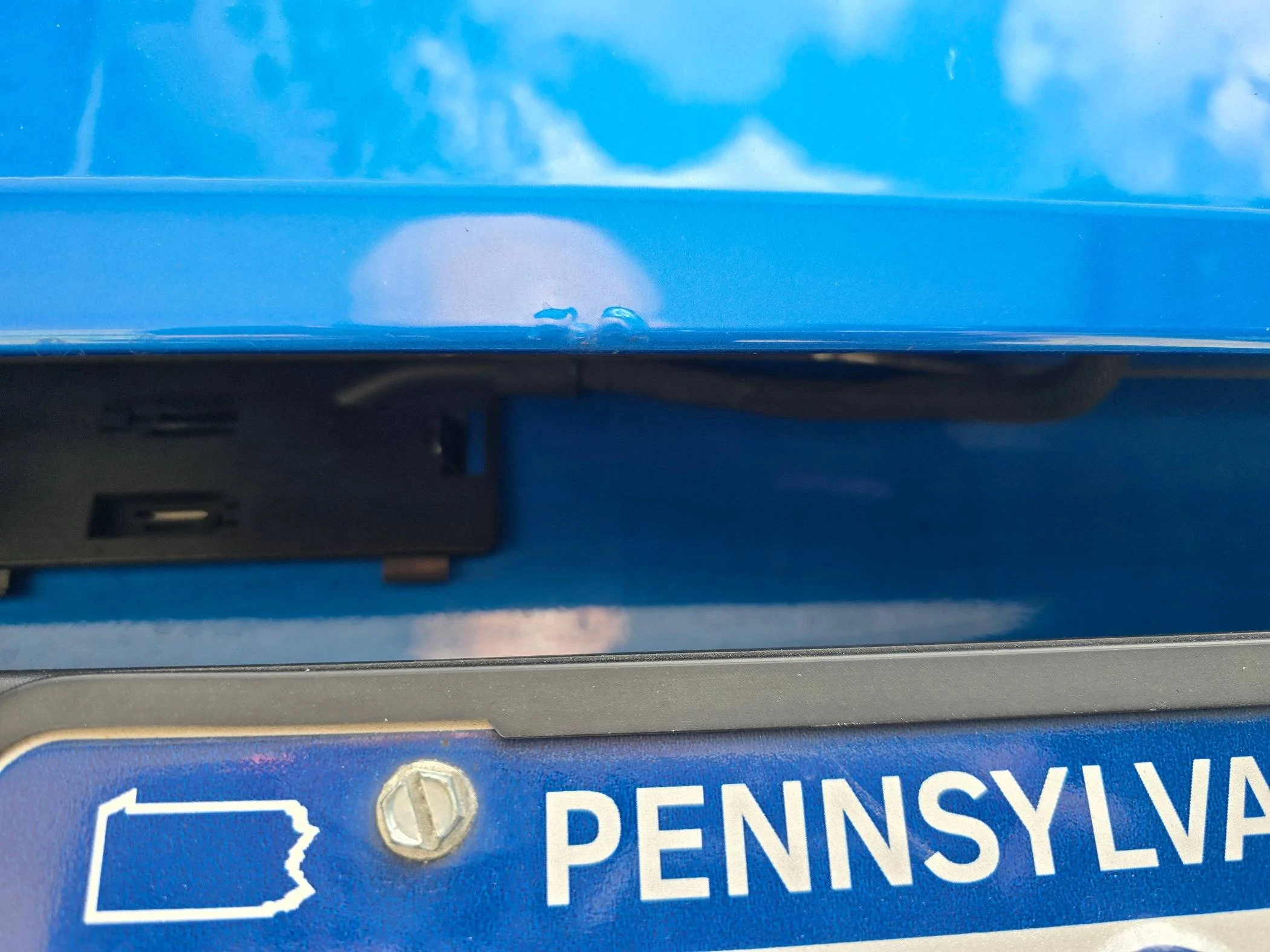

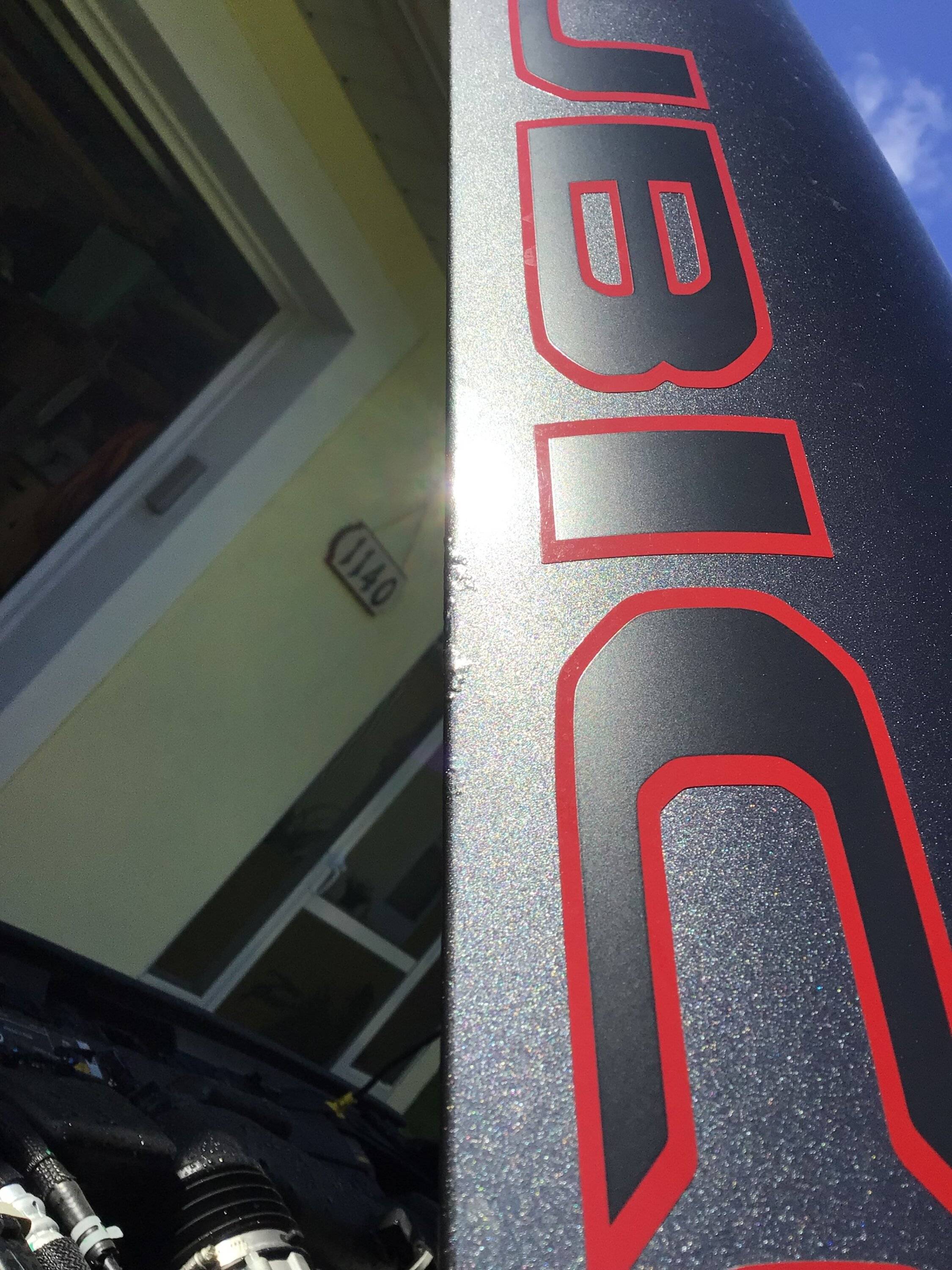

Hood edge paint starting to bubble.
Brokenpinata
Nov 17, 2022
Pittsburgh
2021 Gladiator Overland, 2018 Jeep Renegade Latitu

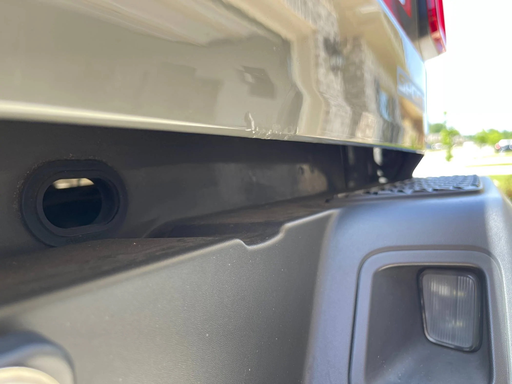

Has anyone had the problem on the tailgate? Everywhere else seems ok, just this spot I just noticed.
Well damnit. I just went out to check mine after I saw this post and sure enough, bubbling on my tailgate as well. I'm taking mine over tomorrow for the hood, so I may as well add this to the ticket.

I worked at a high end aircraft manufacturing company for a few decades. We had paint adhesion issues quite often. I had to troubleshoot and address the issues and found some interesting contributing factors. The obvious reasons are cleanliness correct paint / primer formulation / etching . Primer and paint thickness were a big factor in disbonding. The specs on the coatings were very specific on thickness. One issue I saw over and over was over spec thickness of coating at the edges of parts. Usually on the lower edge relative to gravity while coating is applied. Coatings naturally "pool" at these edges and accumulated over spec thickness specific to each coat/ material type. I ordered a small calibrated ultrasonic device to measure coating thickness in mills and sure enough many low side edges disbonding were over thick.

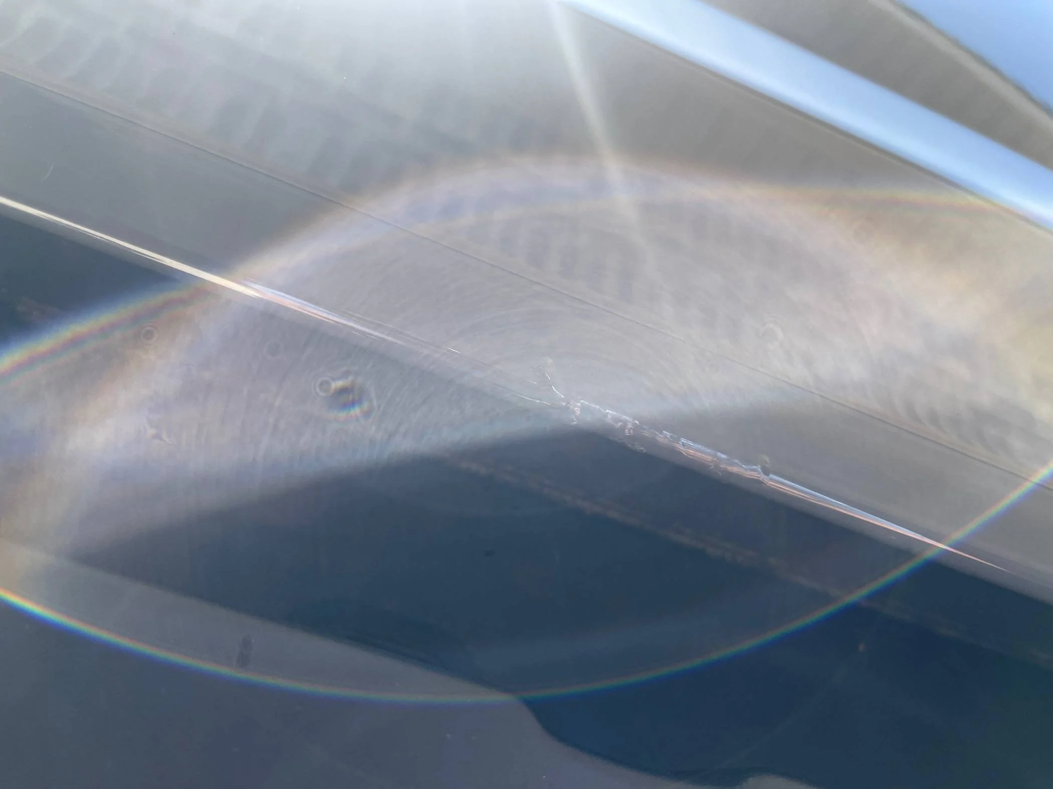

Read this thread today and thought oh lemme check...uh mistake. Found a little bit of bubbling on the edge of the hood in one spot that I can find.
Anyone know if the warranty is still good for paint on a 3 year, 2 month old Glady?

5 years on corrosion warranty

My 21 had corrosion on the tailgate. Nearby dealer that has done the service work on all 4 of my Jeeps told me to get in line....expected date in 2026 because I didn't buy it from them. So much for customer loyalty.
Went back to original dealer. Had an appointment 3 weeks out, had the truck in the shop for a week, provided a loaner and the finished product looks great.
