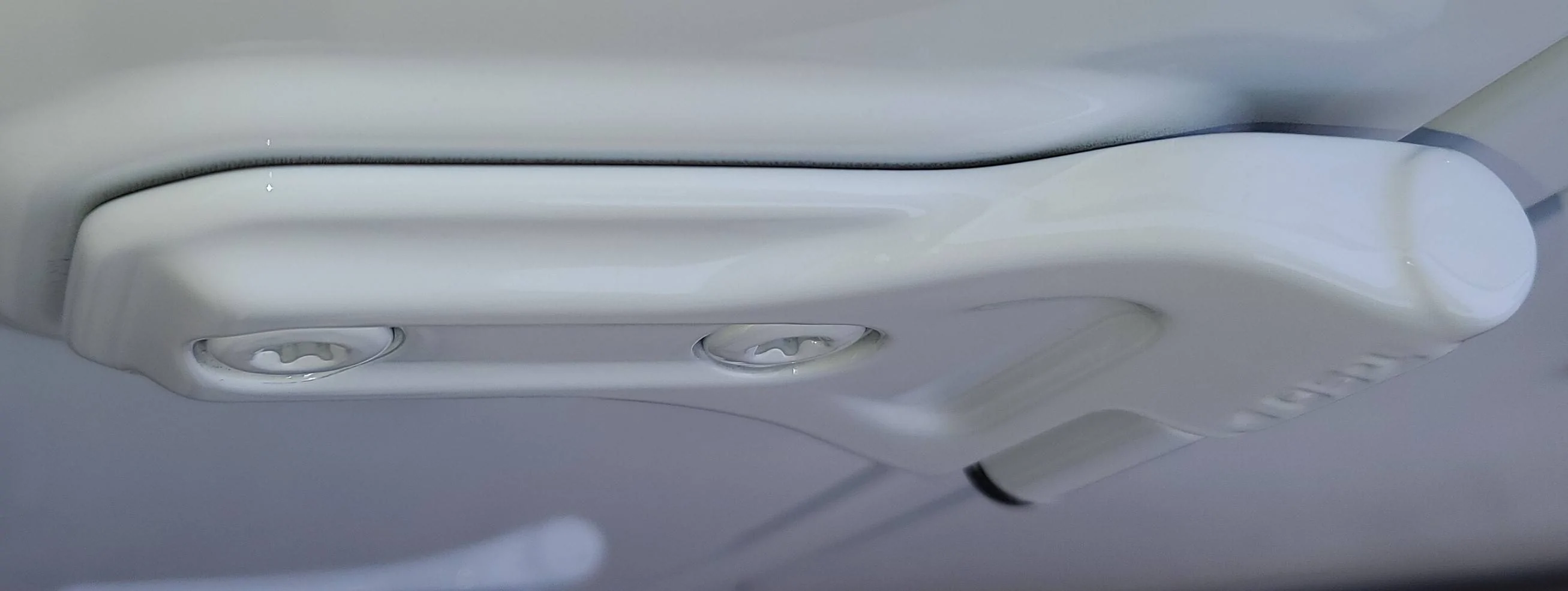

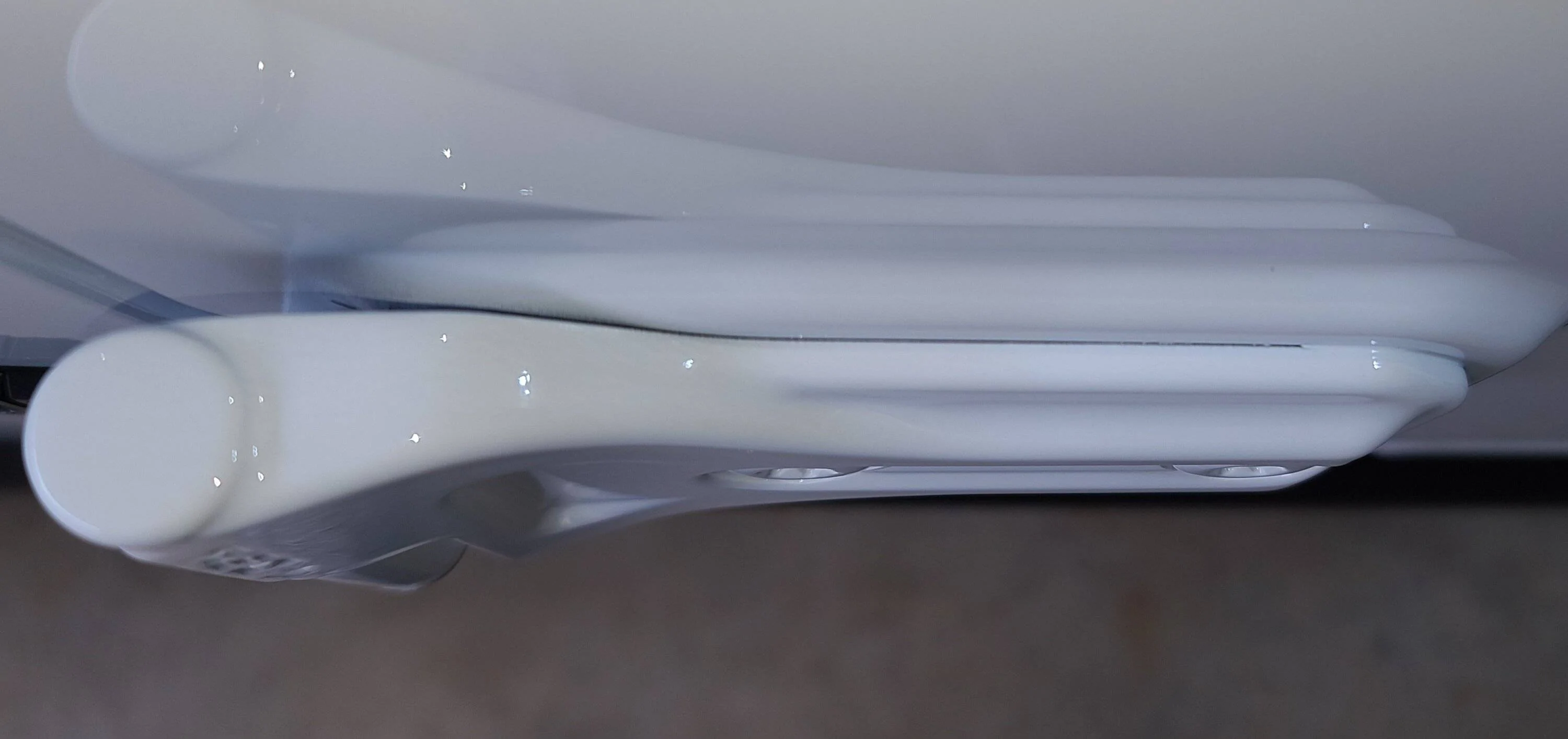

I have a 21 JL and a 23 JT I notice that on the JL there is no real space between hinge and door, and its been painted over some. With the JT it looks like there is some sort of spacer between the hinge and door....I guess Jeep is trying some measures to address the hinge bubbling issue.

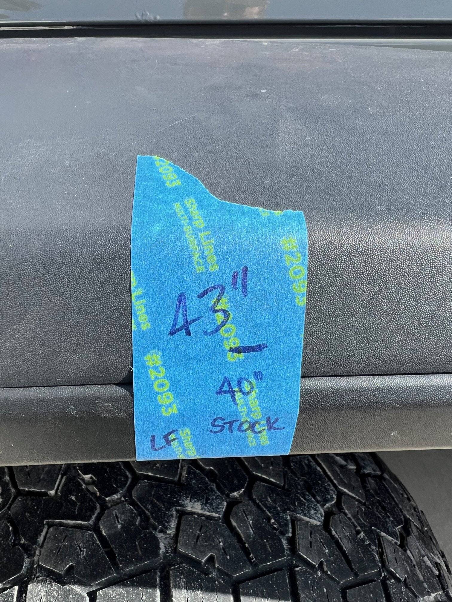

When taking pics of my before/after lift numbers, I saw a little bubble in the pic. Well, s**t. The first chink in the armor. I double checked yesterday and I have a couple spots on the left side (all I wanted to check at the moment).
Jeep Gladiator Hood edge paint starting to bubble. IMG_1672
Hmm. Maybe I'll get this repaired and then replace it with a CF or fiberglass hood.
