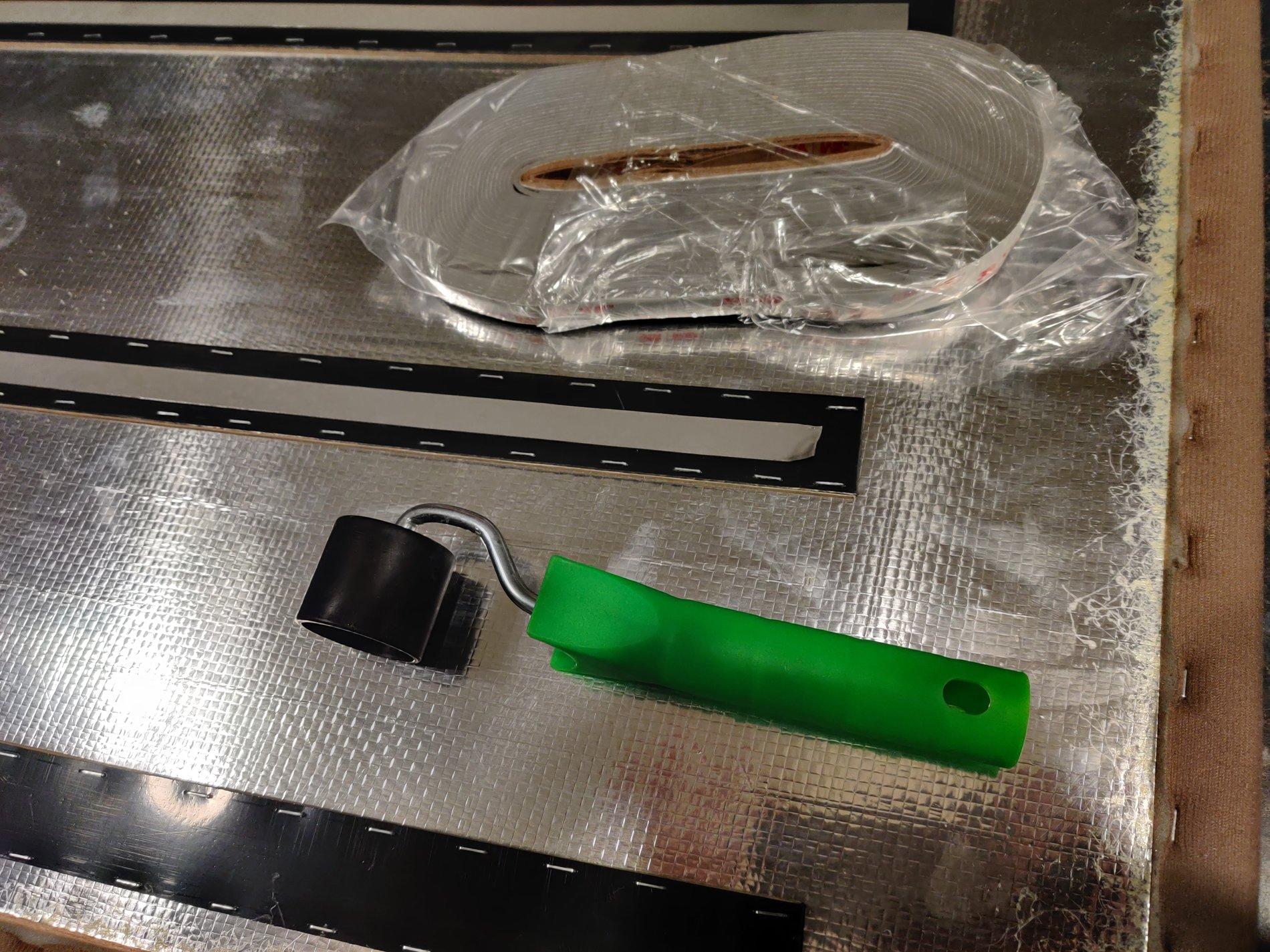

Jeep Gladiator Hothead Headliner adhesive issues? IMG_20200115_174907
this is what he sent and the email that processed them.
Hi Oscar,
I'm very sorry that you are having an issue. We are sending new tape today. I'm attaching some videos that will help.
If you have any questions please let me know.
regards,
Mark
Hothead Headliners
Remove & Replace 3M tape:
Prepping your hard top:
Cold Weather install:

mopar headliners are done at the factory in what I would assume is a climate controlled atmosphere. It’s not old weaker stuff vs new stuff. It’s 3M VHB brand and sometimes with cold weather it doesn’t have the ability to bond the way it should. Adhesives should be warm to help the bonding process. Mopar has had significant time to bond. I wouldn’t dream to call hothead expensive. It’s cheaper than the Mopar option, comes in different colors, and overwhelmingly has not had issues with adhesive on the majority of applications.
That, plus their customer service is A1. If you’re concerned, you could always ask them to send some extra VHB and I’m sure they’d oblige. Otherwise you can buy a roll for cheap on amazon.
That being said, I did my fronts indoors and my rear top in 40 degree weather and they held up fine. I followed their directions to a tee for cold weather install.
I suppose I could order them now anyway, but just wait til the spring or early summer for warmer temps to attach them. The highs here this week will barely hit 20-degs.

yea I think you’ll be happy with them overall. If you have a heat gun (or blow dryer), you could just heat up the adhesive on the headliners before attaching them. Seen people do that as well.

So I reinstalled my falling rear panels last night.
Heat gunned the top a bit so it was warm to touch and then I used a lot of heat on adhesive. MAKES A HUGE difference in the tackiness of that stuff to be warm. Panels when up nice and easy.
HIGHLY recommend a heat gun when applying regardless of ambient temp.
