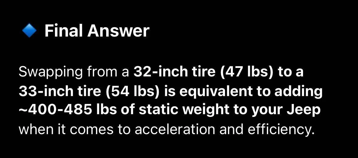

How accurate is this? Static weight added when going from 32" to 33" tires

I think this is referencing unsprung vs sprung weight. When I was racing off-road motorcycles, we paid a lot attention to unsprung weight, as we spent a lot of money and time tuning suspension for high speed desert. Not sure why it matters on a Jeep that sees mostly road use and low relative speeds. A few pounds difference in tire weight just isn’t going to be noticed until the suspension starts to cycle at higher speed and more diverse terrain.

Switching from a 31 inch tire to a 33 you'll gain about 13 pounds per tire and significantly increase the rotational inertia due to both weight and the added diameter. As a result braking distances will increase measurably and pads will wear out more quickly. Fuel economy and acceleration will suffer. Suspension and steering components will have to work harder and larger, heavier tires put much more stress on driveline components: axles, differentials, CV joints and the transmission. They will also negatively affect your gearing, especially in low range.

It’s not just tire weight, but are you using the same stock wheels? The issue here is what’s called unsprung weight, the ultimate enemy of power to the ground from a dead stop and highway speeds that hinder the power taken to spin the wheels up. Not to mention the stress on shocks, springs and every bushing.
