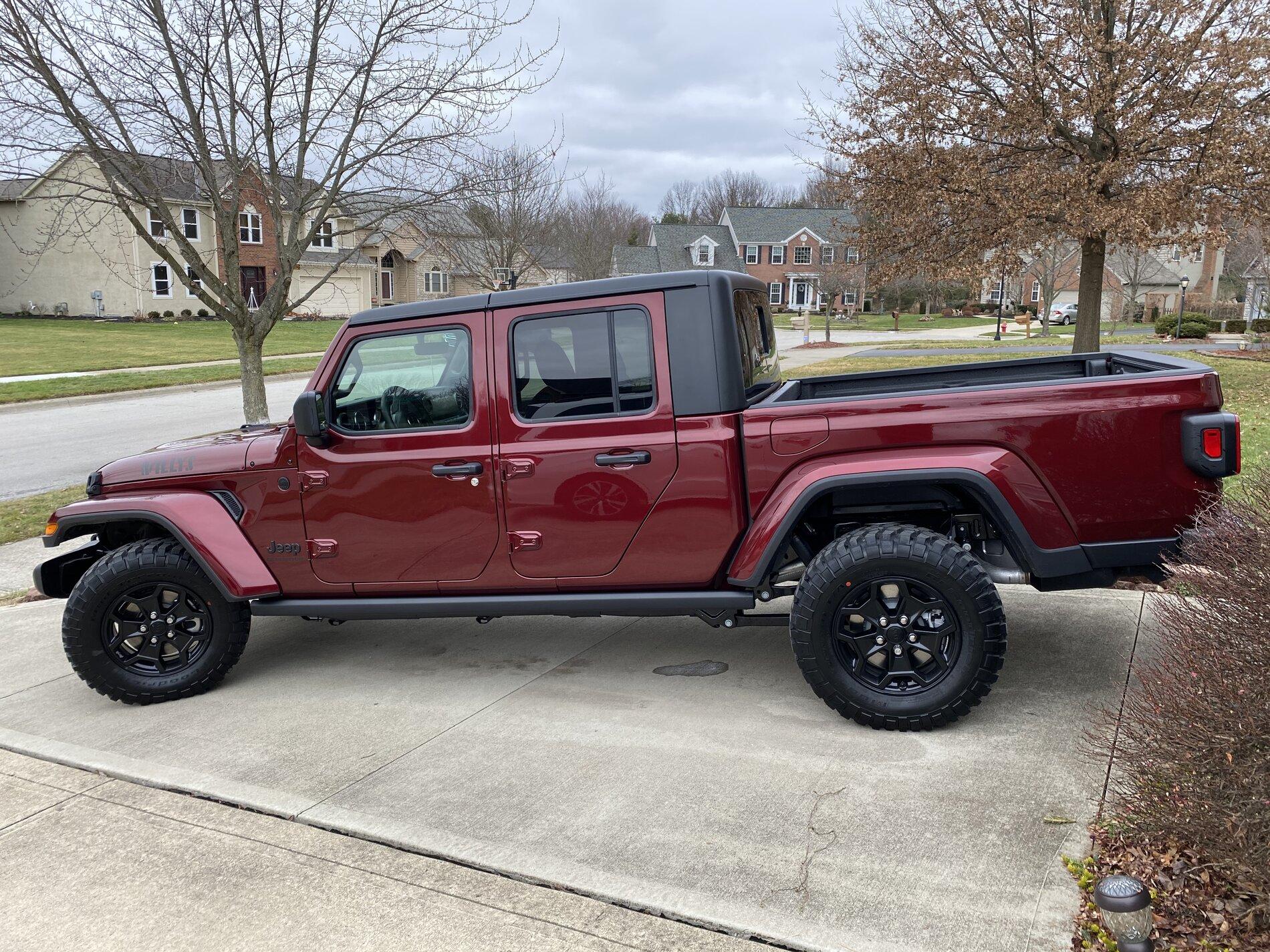

The Jeep issued Willys package 32–Inch LT255/75R17C Mud–Terrain Tires on
17–Inch x 7.5–Inch Black Aluminum Wheels looks pretty correct, in my opinion. I could go larger, but I like the way she handles with these. There are some smokin' deals on little used takeoffs in the member marketplace.
Jeep Gladiator How big of a tire on Sport S without doing a lift or having any issues? 4229DE5E-4E5E-4CBF-B378-882487EEFF80
Oh yea those rims and tires look so good on the snazzberry color. Got a deal lined up on some Willys take offs. Should be picking them up next week.

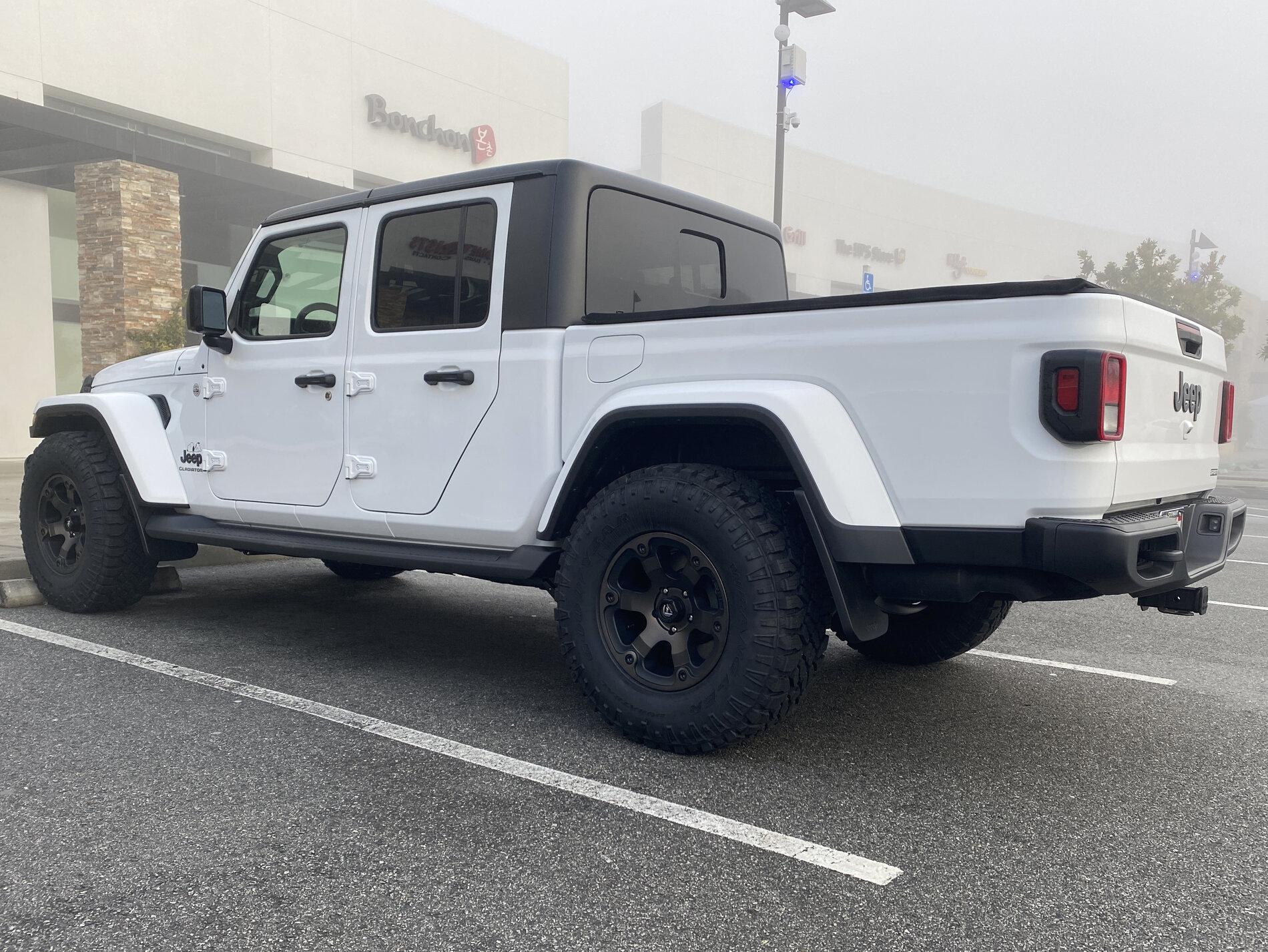

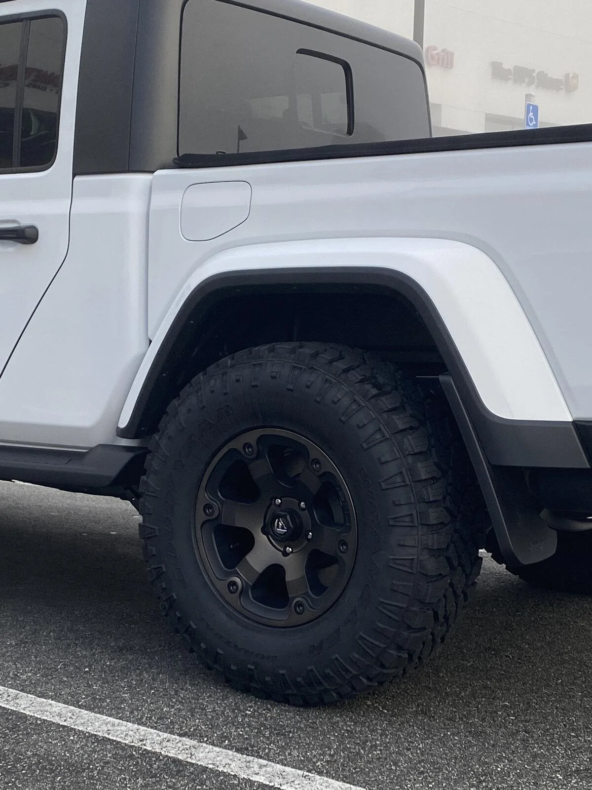

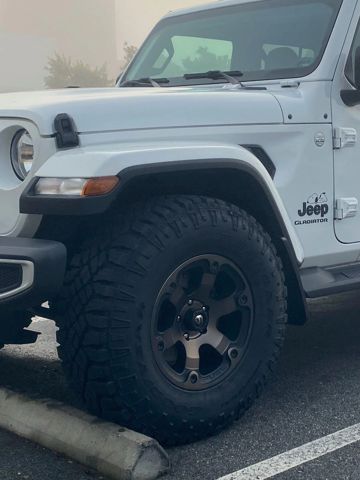

For stock wheels I think the largest tire you can use without modifications would be a 285s. So a 33-ish tall tire.
Had to get aftermarket wheels to get 35s to fit.
-Goodyear Wrangler DuraTracs 35x12.5x17
-Fuel Off-Road Beast 17x9, +01 Offset, 4.00 Backspacing
No lift
No trimming of wheel wells
No lift

Great question since I am about to pick up a gladiator on Thursday and was curious about the same thing. Love the look of your gladiator, do you have any rubbing? Also, how did you determine the right offset and back spacing? Any knowledge your willing to share, would be greatly appreciated

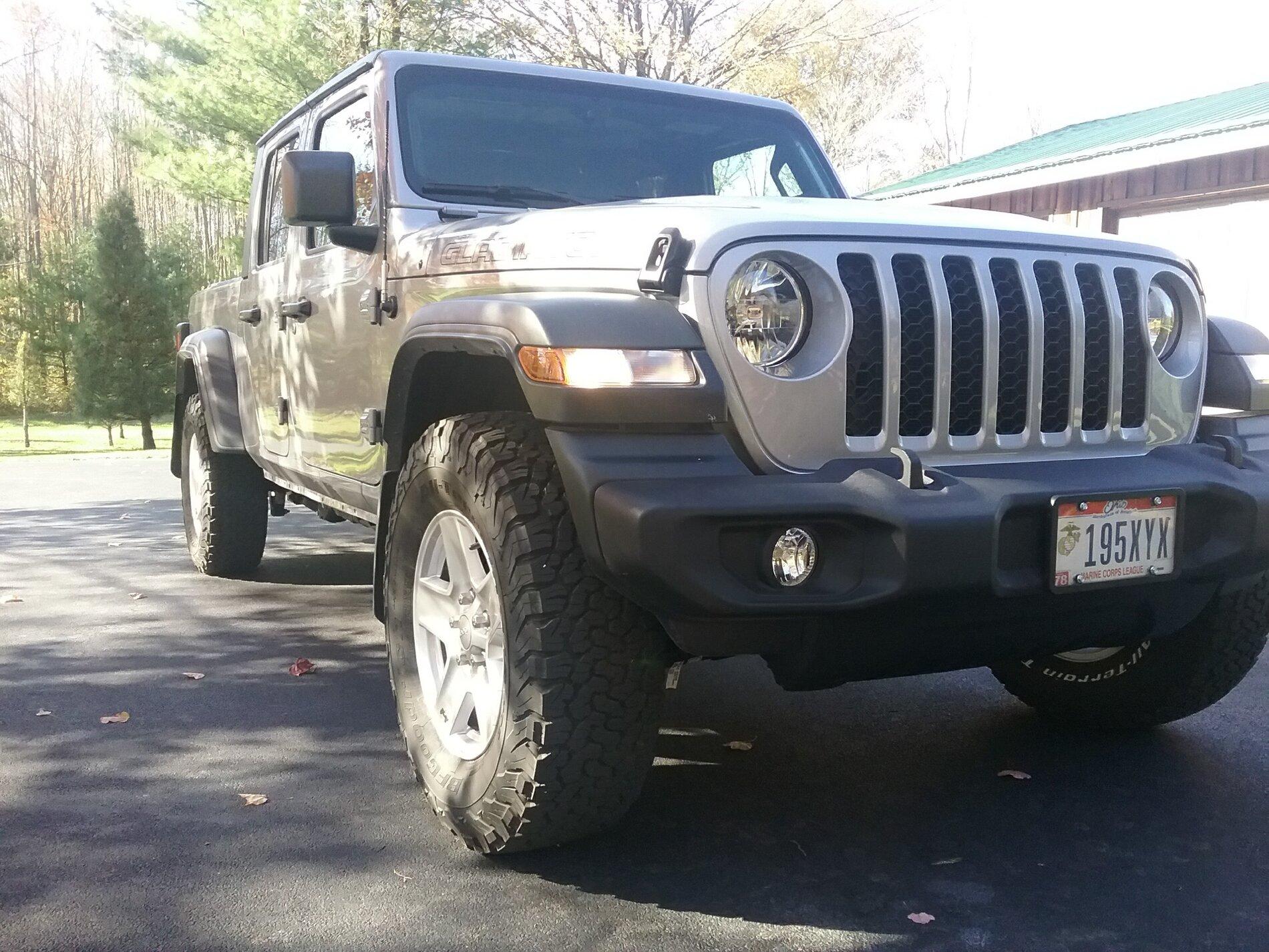

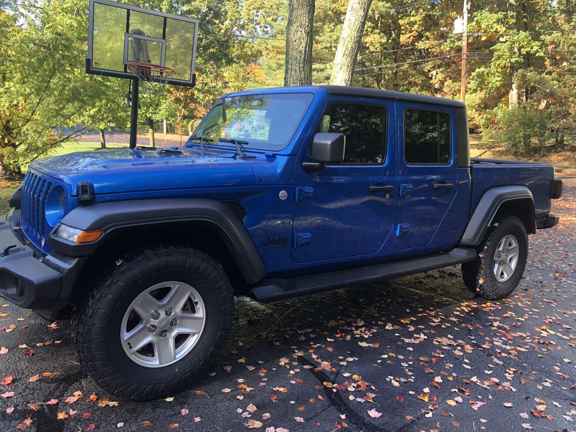

35x12.5 all stock
