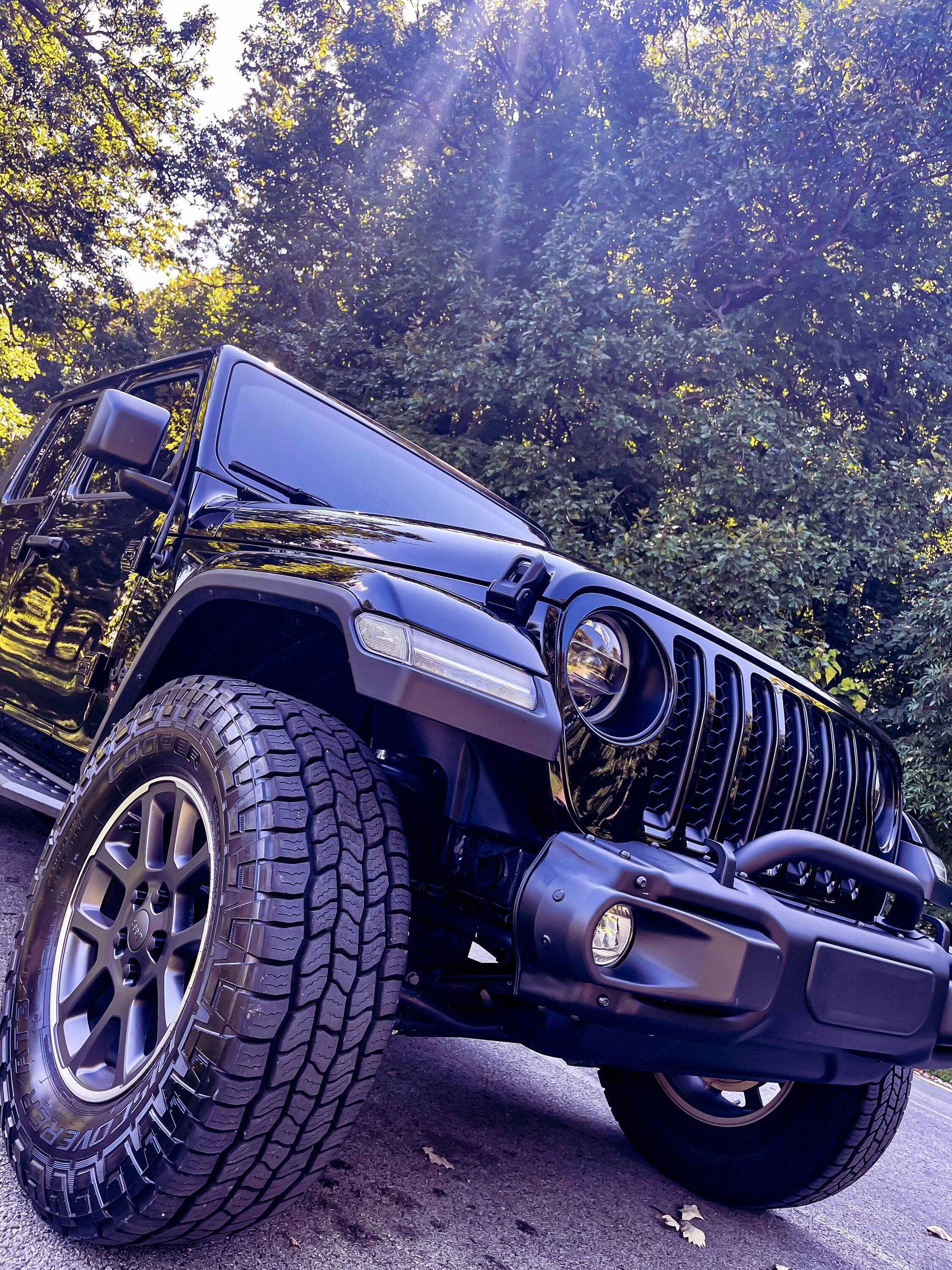

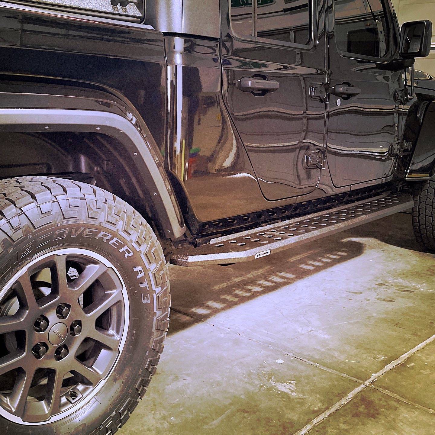

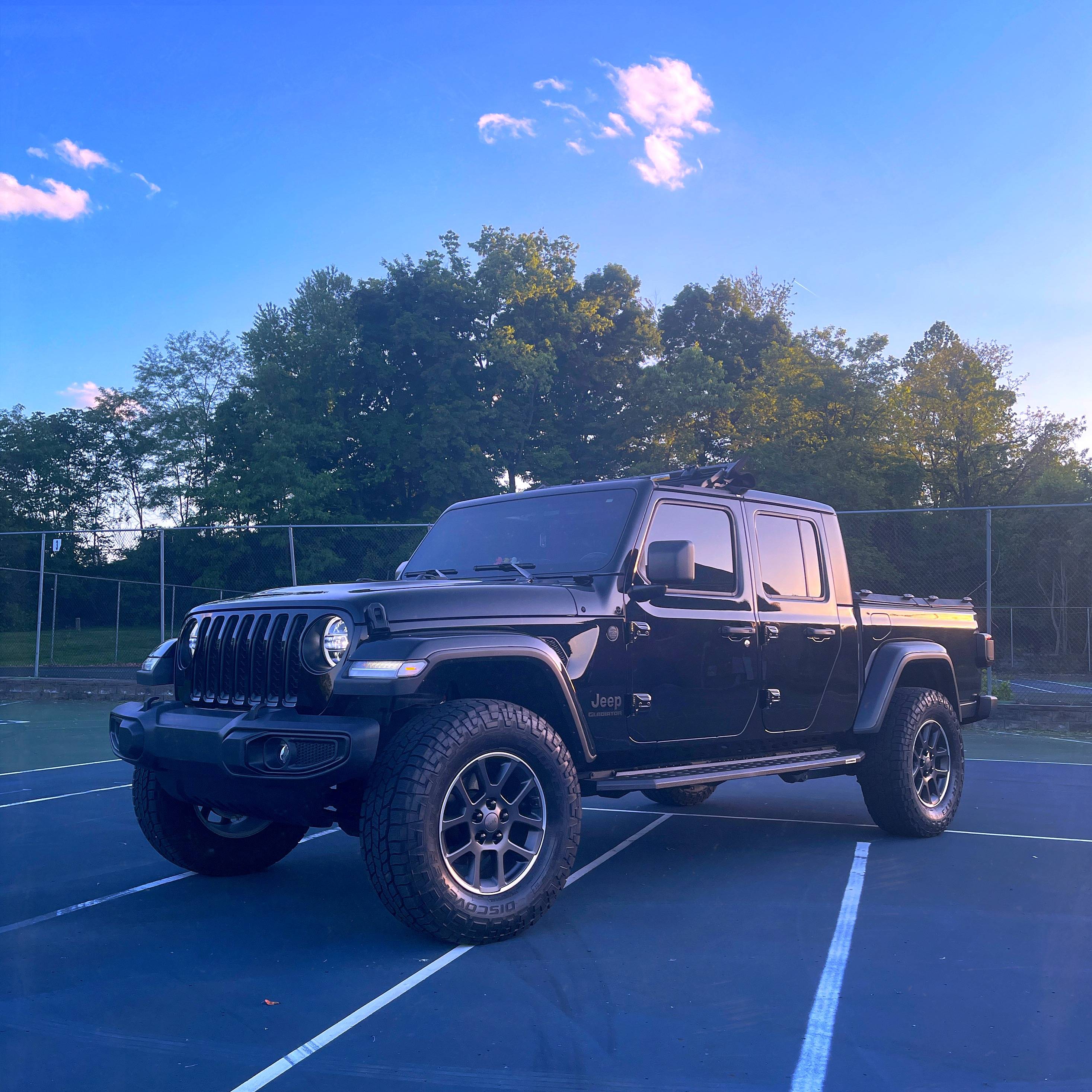

I have 295/70/18s which is basically a 35 equivalent for the most part. I no longer have them on my overland wheels anymore considering I got aftermarket wheels recently and remounted them on the new wheels but I ran those for nearly two years on the overland wheels. I'll actually be selling my overland wheels here soon along with a fifth matching spare. 295s are like the sweet spot for that wheel. Others have also did 275s.
Check out my build thread in the beginning especially the first couple pages since new tires was one of my first upgrades. Not only shows more pics of them after installed but I had a lot of commentary from others looking to do the same. So may answer some questions besides the abundance of other threads on this topic. Also I included a few older pics here below
