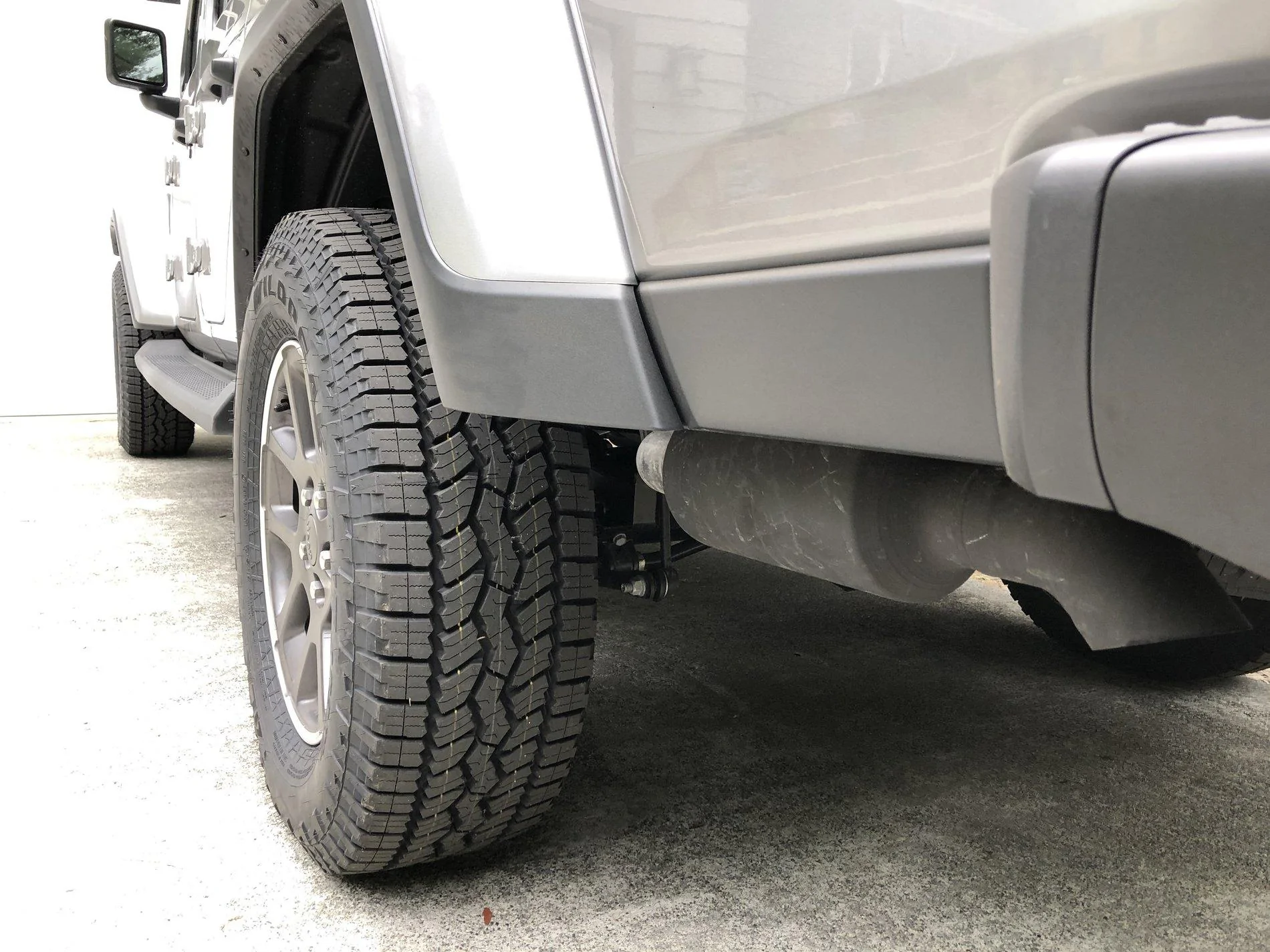

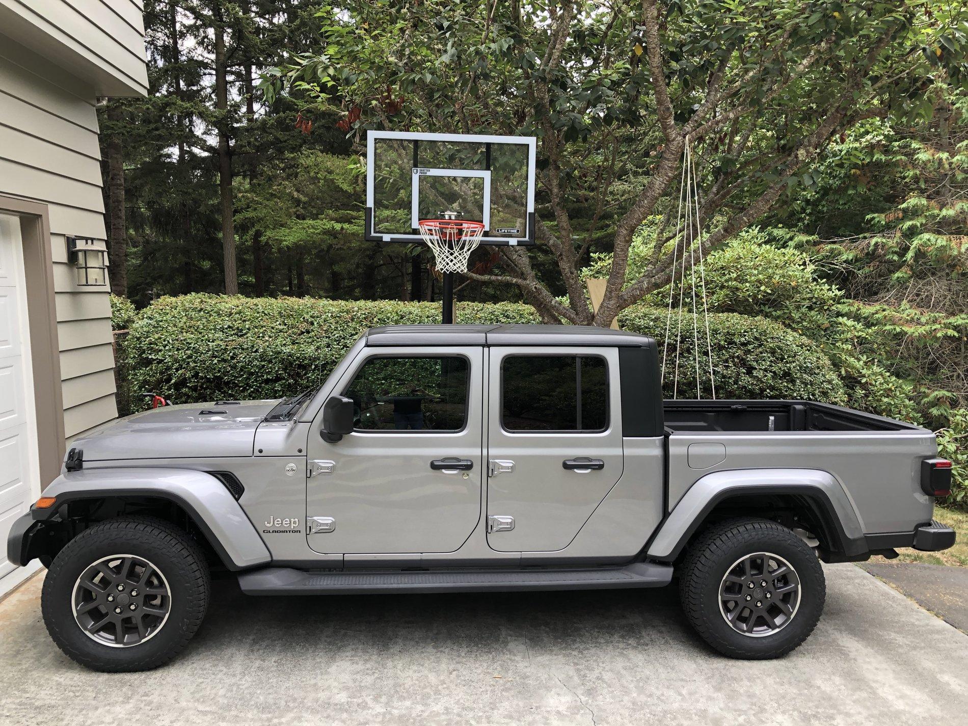

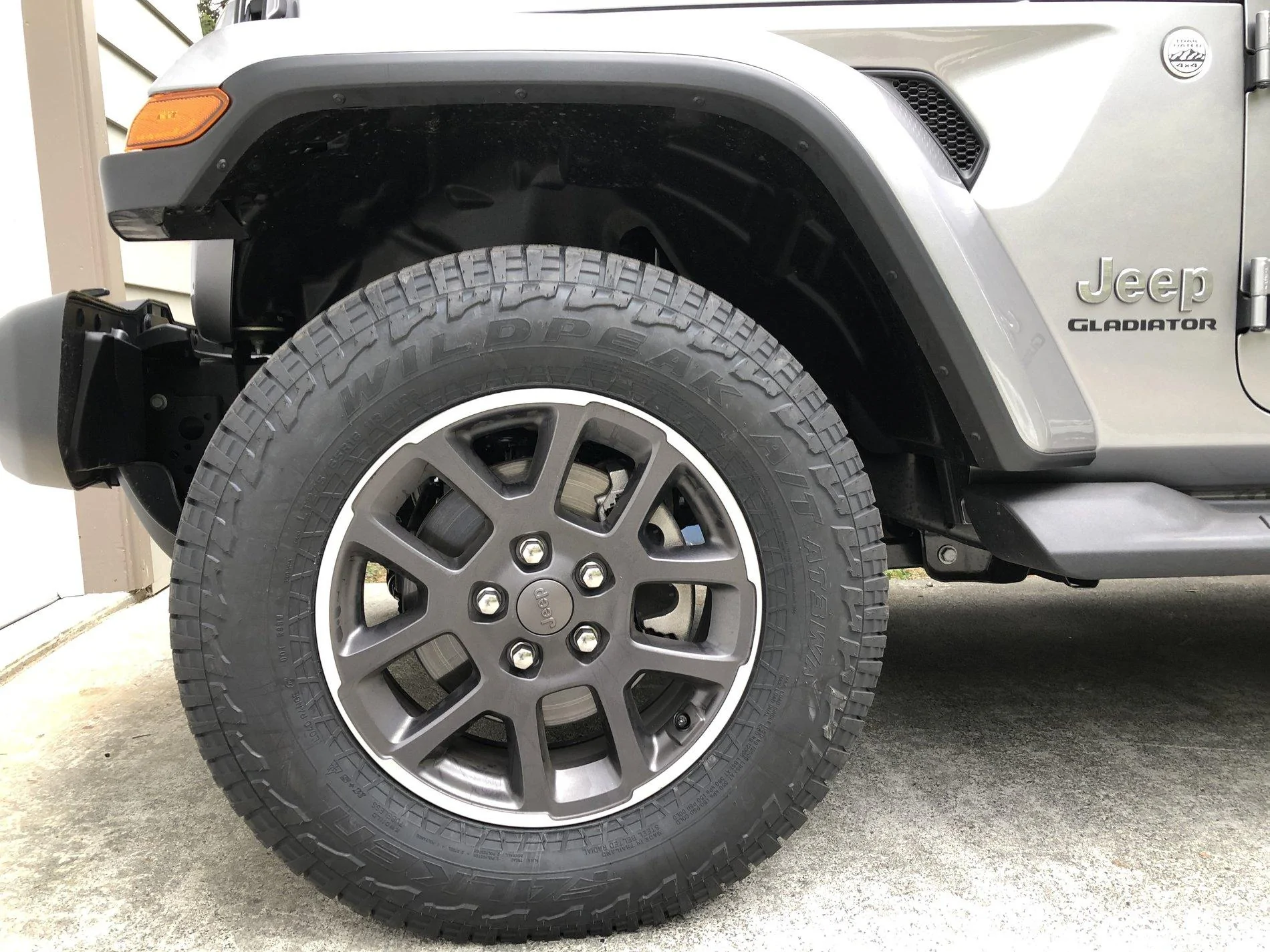

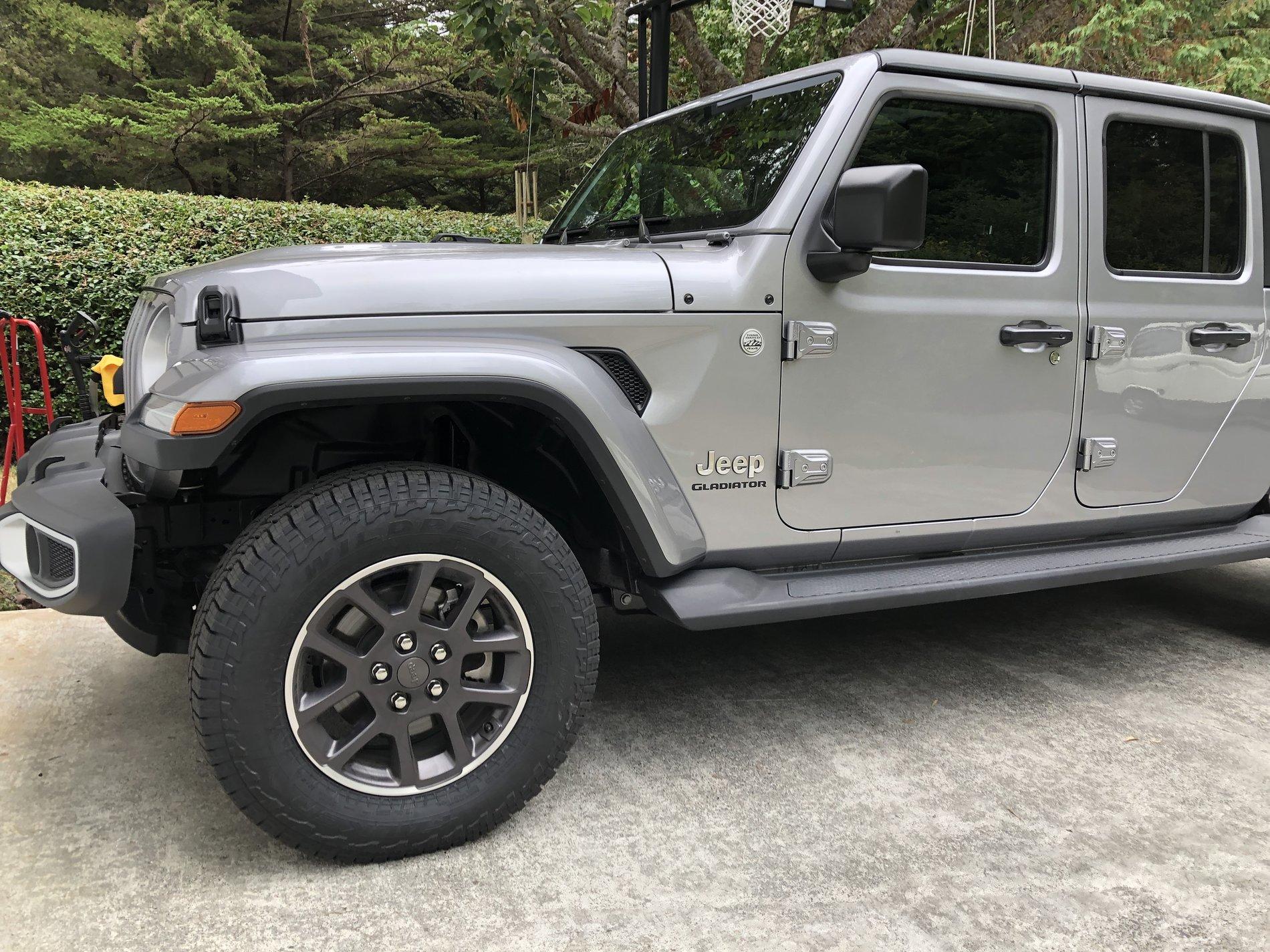

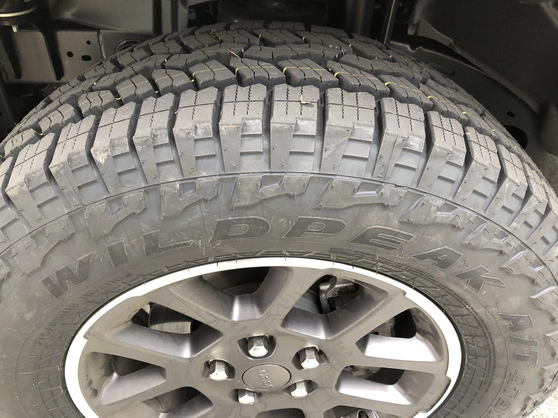

Today I installed a set of 275/65/18 Falken Wildpeak A/T AT3wa (C rated) on my OEM Overland wheels. Same diameter and same sidewall height as OEM 255/70/18 tires just wider. So far so good, but I’ll report back after a few thousand miles.
Jeep Gladiator Bigger Tires on the Overland Wheels or ??? E5DA8B0B-4084-4387-8A8B-808A39C476F4
Jeep Gladiator Bigger Tires on the Overland Wheels or ??? B17B22CD-455E-4882-AF99-0224766A91B8
Jeep Gladiator Bigger Tires on the Overland Wheels or ??? B39672C2-9F15-4FDA-994E-213B91C61A37
Jeep Gladiator Bigger Tires on the Overland Wheels or ??? 80B9751C-8103-4B95-932B-17FF078BAF94
Jeep Gladiator Bigger Tires on the Overland Wheels or ??? A0EBB6DD-5535-4EDA-891F-ECA31AB087A6

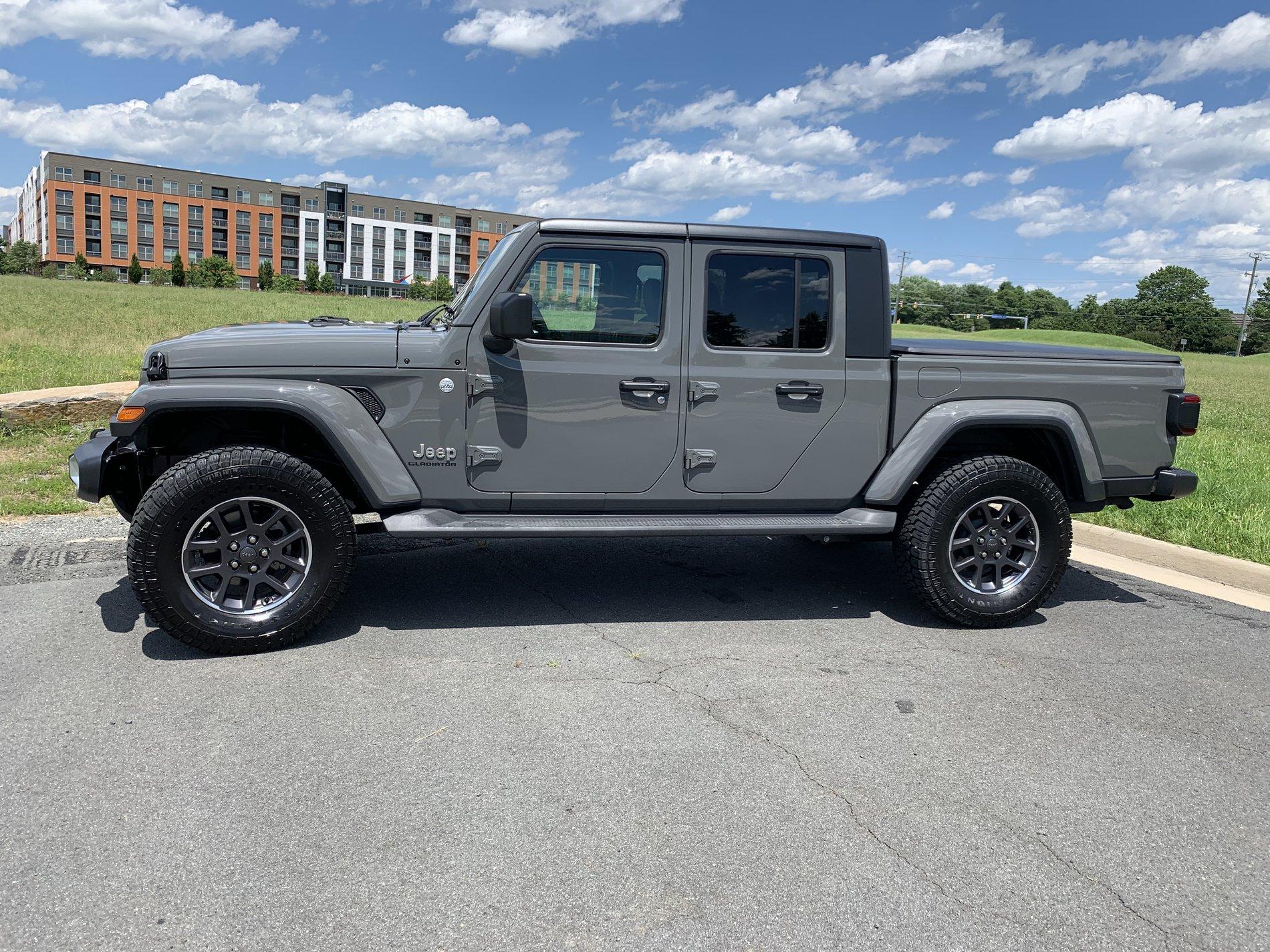

Jeep Gladiator Bigger Tires on the Overland Wheels or ??? 359DC059-F36C-45A9-991D-80C86D1B2B70
35s on stock overland wheels with 1.5 spacers (there was rubbing on the right side at full lock) and 2.5” rough country lift/level kit.

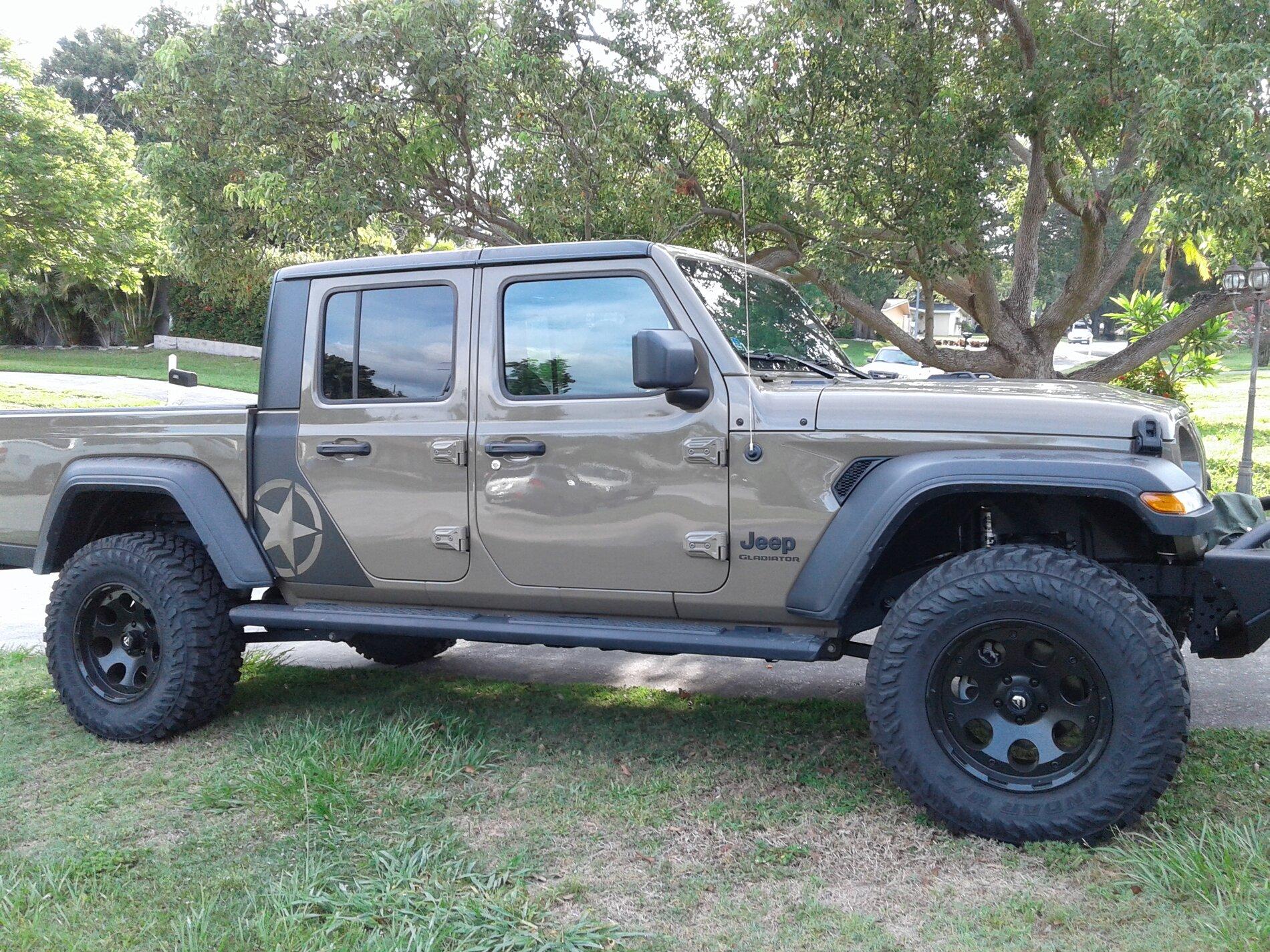

Anyone throw on some bigger tires on the Overland wheels (with photos?:)
Was trying to decide if I want to put a bigger tire on the Overland wheel or pick up a set of Rubicon wheels.
Not sure the pros and cons of either except I do know that the 'street' tire of the Overland has to go.
Not a overland but I do have 18in rims and 35s

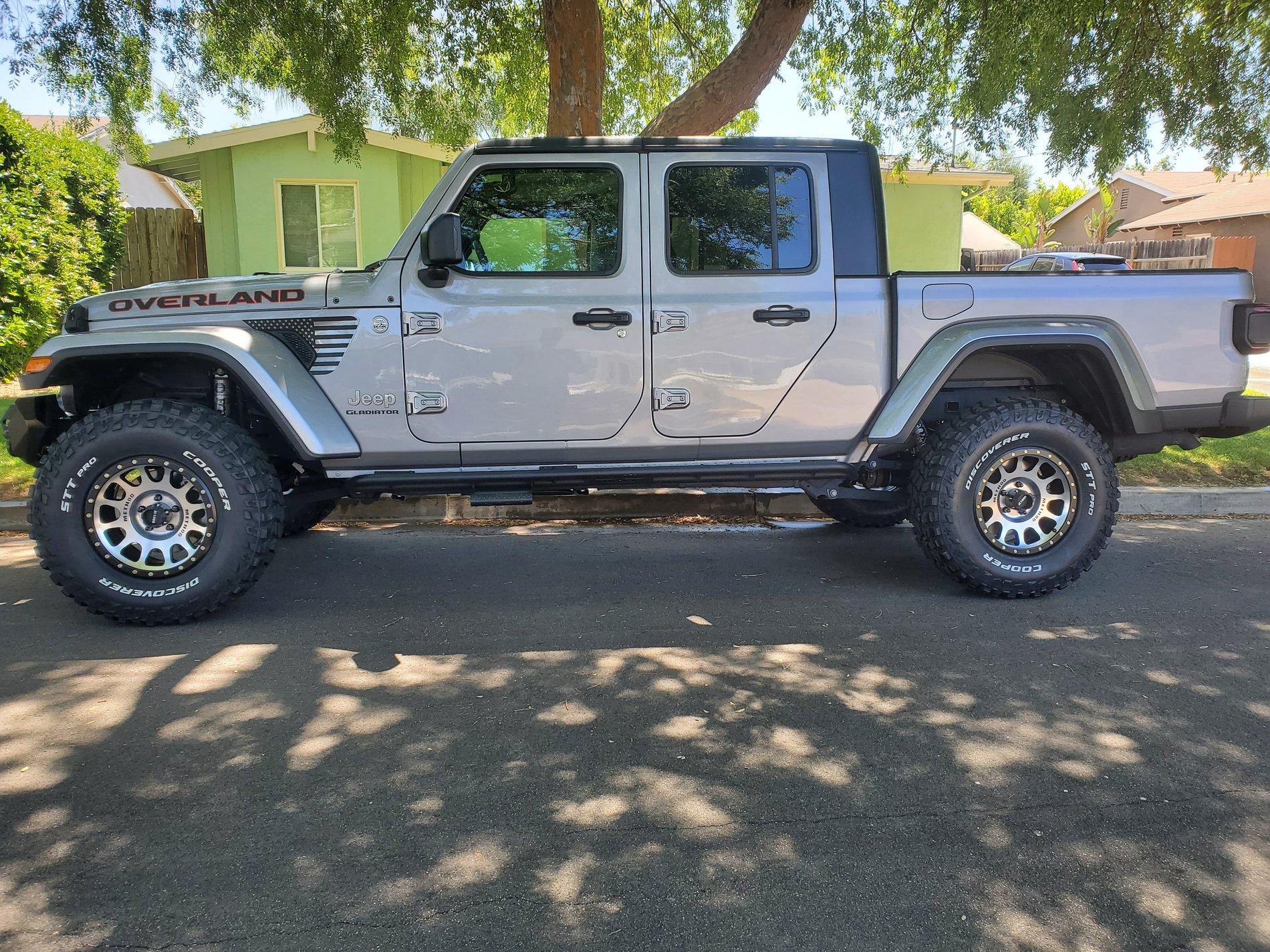

Been that route on my JKU Sahara. Put Cooper 33's on OEM rims. Cost $300 a tire. Bought a buddys JL Rubicon tire/rims for $1000. Now the spare has a good rim to do 5 tire rotation. ANd tires are cheaper in the future!!! And the plus is I like the rims better than the overlands
I like the look of those wheels,I have the Overland and I'm searching for a set of those rims you have.
