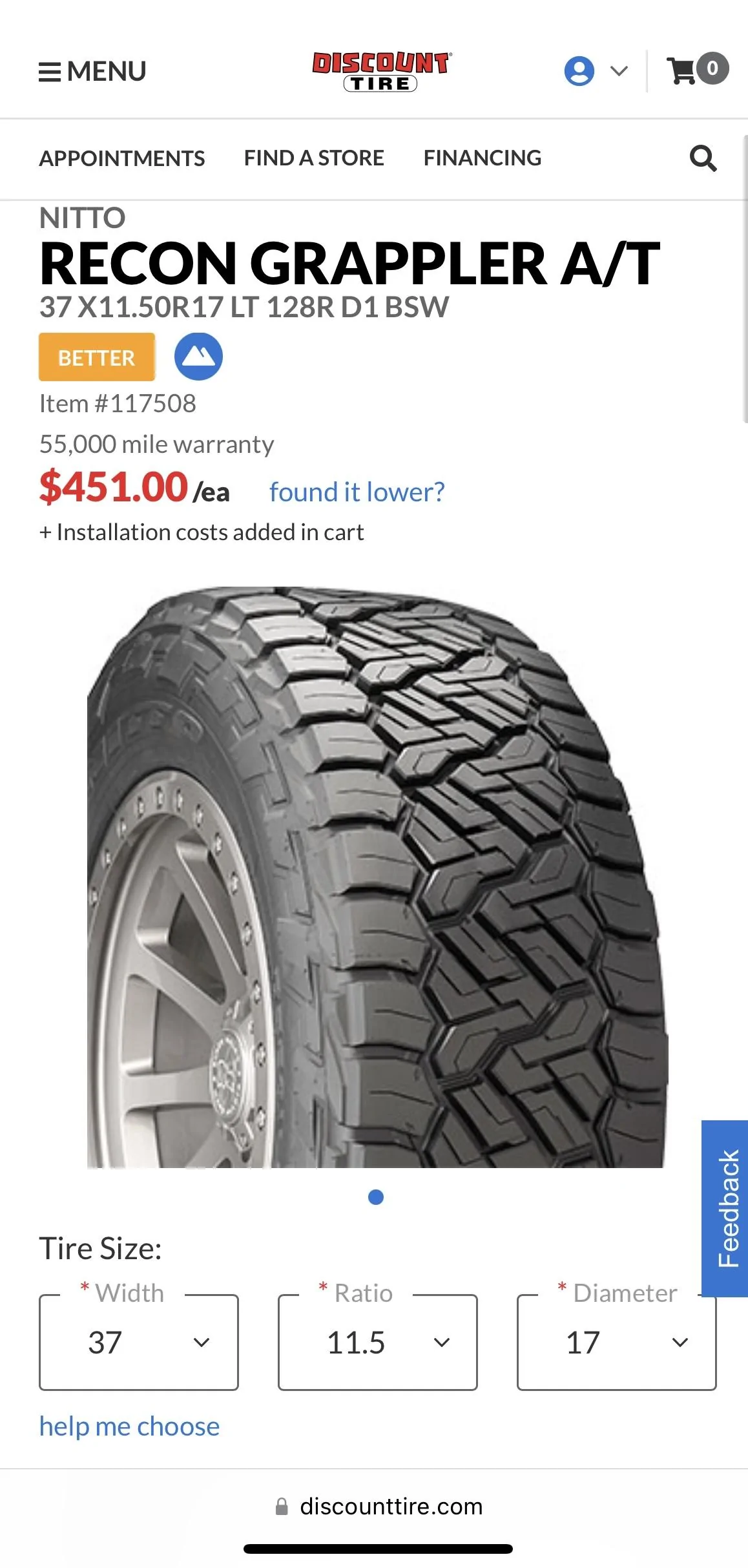

Toyo Open Country, at 37x11.5 or the Nitto Trail Grapplers (same width) will work with the stock wheel. There is also the Kenda Klever at 35x10.5.

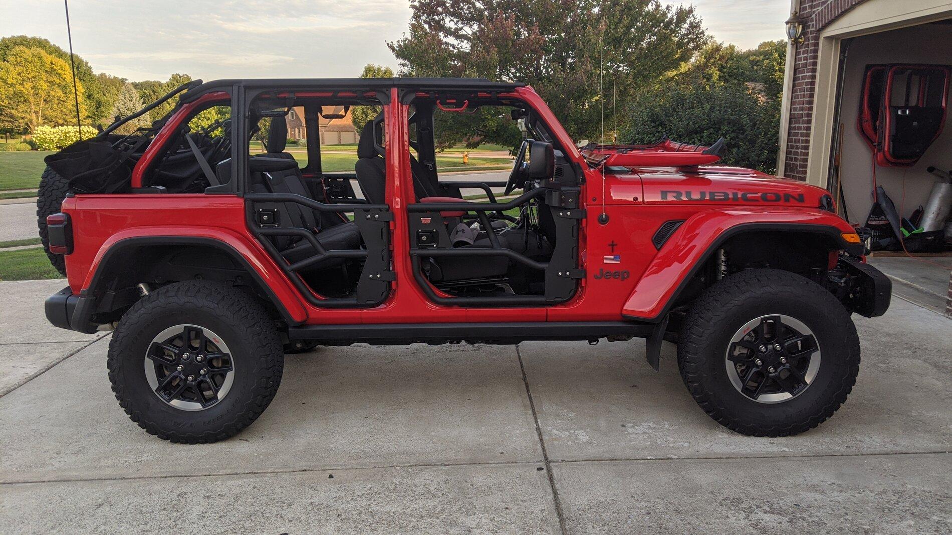

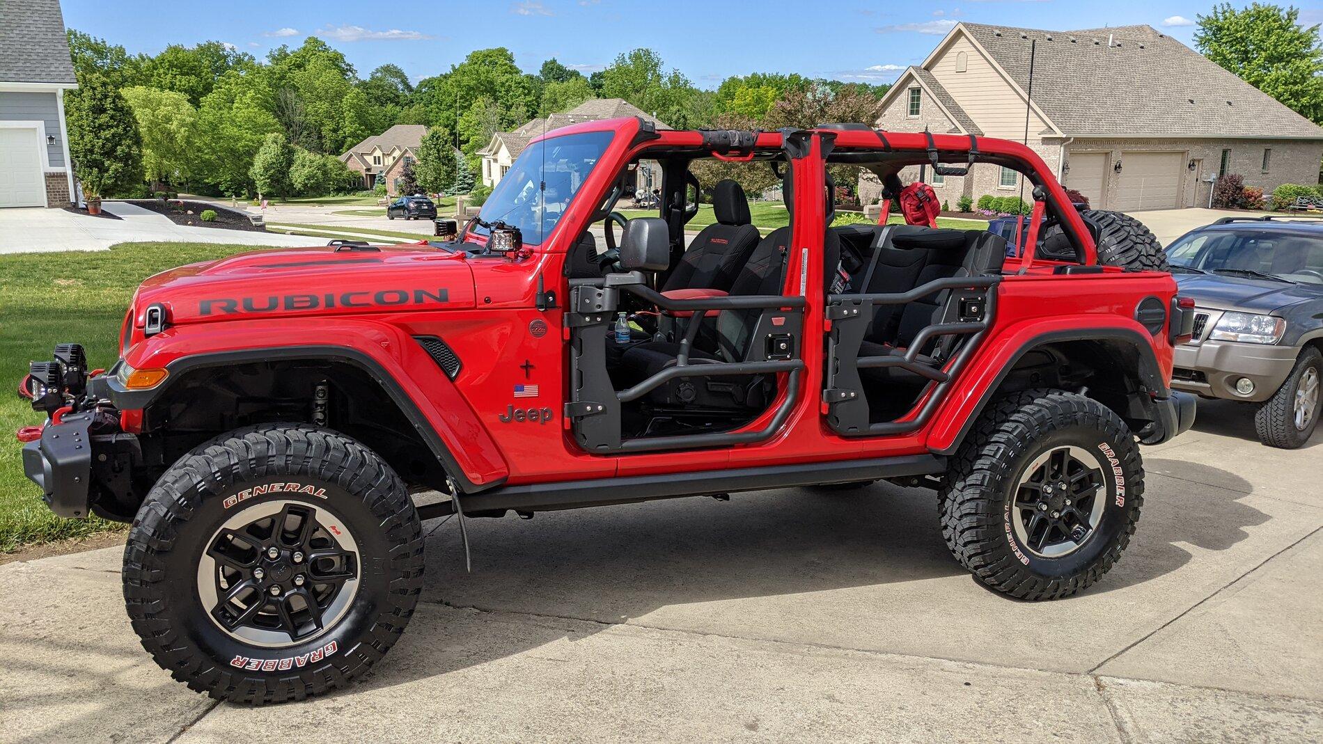

I ran 315/70/17 KO2's on my stock rims on the JLUR for 3.5 years and 47k miles. I ran a 5 tire rotation and they still have plenty of tread left. I'd say they'd easily go another 20 to 25k before getting to the wear bars. Maybe more. There has been no rubbing, in spite of much off-roading and flexing at the maximum at full turn lock, either way. They did wear more in the middle, but not dramatically more.
I just switched to General Grabber X3's in 35x12.5x17 because I wanted a more aggressive tread. They ride exceptionally well and handle just fine. I haven't been off-road with them yet, but I expect no rubbing. They have a very slightly greater diameter than the KO2's. Maybe 1/4" or so, but much deeper tread. They will undoubtedly wear more in the middle, but again, I expect long life out of them. And the KO2's performed VERY well in all conditions. So far, so good with the X3's in the dry and wet. We'll see in the snow. But I'm betting they'll be great. They do have some siping, which will help.
No sense in arguing over it. If you are not comfortable putting 35's or larger on 7.5" factory rims, then don't do it. But there are enough of them on the road on JK's, JL's, and JT's, that to suggest they are a safety hazard simply has no merit in fact or the real world. Also, while not always wearing as evenly, they still last plenty long, and will likely exceed the tread warranty on most, if not all tires, given proper rotation, alignment and healthy shock absorbers. That said, you can never go wroing playing it conservatively, either.
Btw, I run C-rated tires. Jeeps are really too light duty for E rated tires. The C's ride MUCH better and are much lighter weight. The KO2's and Grabber X3's both weigh about 64lbs.
Grabber X3's
Jeep Gladiator Bigger Tires on Stock Wheels PXL_20210529_210723255
KO2's
Jeep Gladiator Bigger Tires on Stock Wheels IMG_20200829_193345

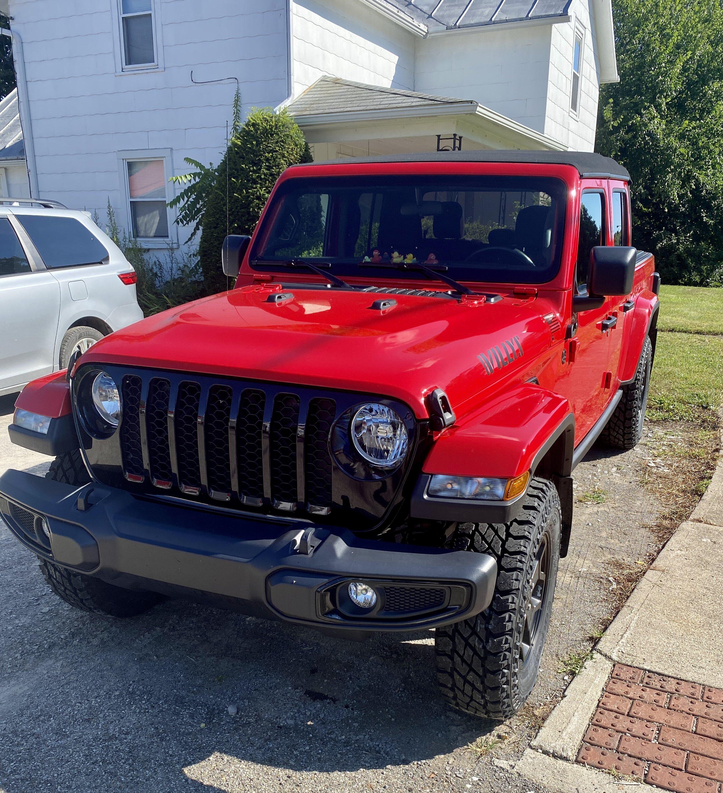

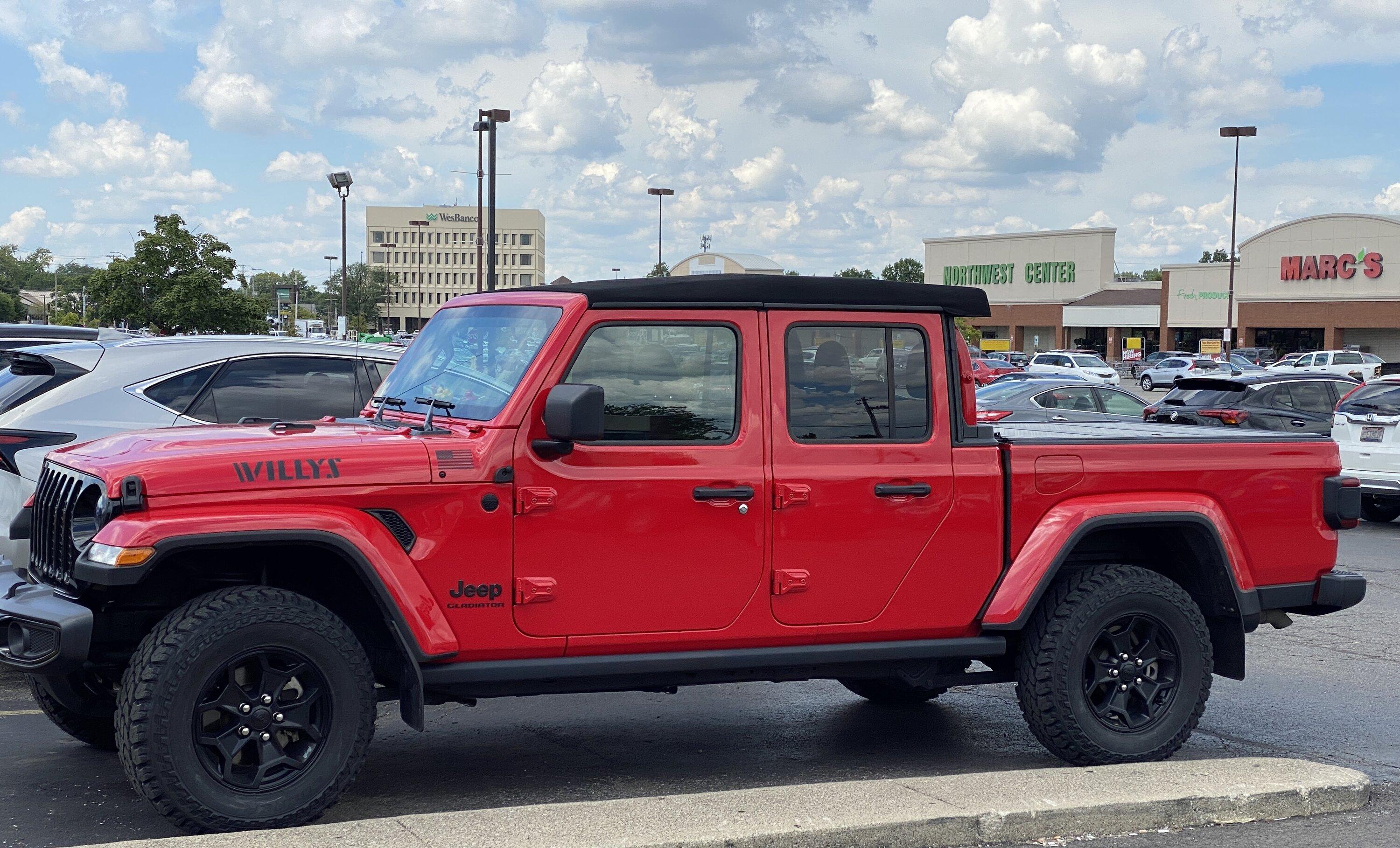

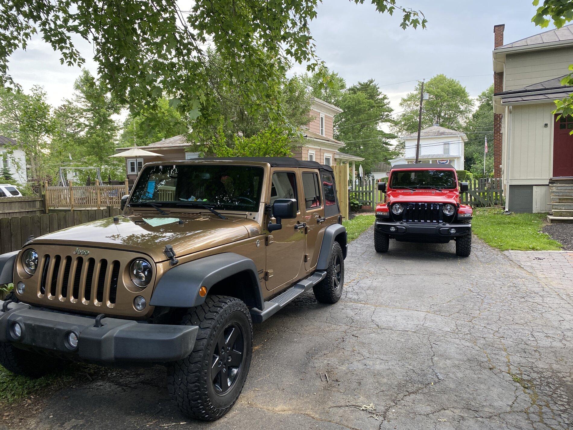

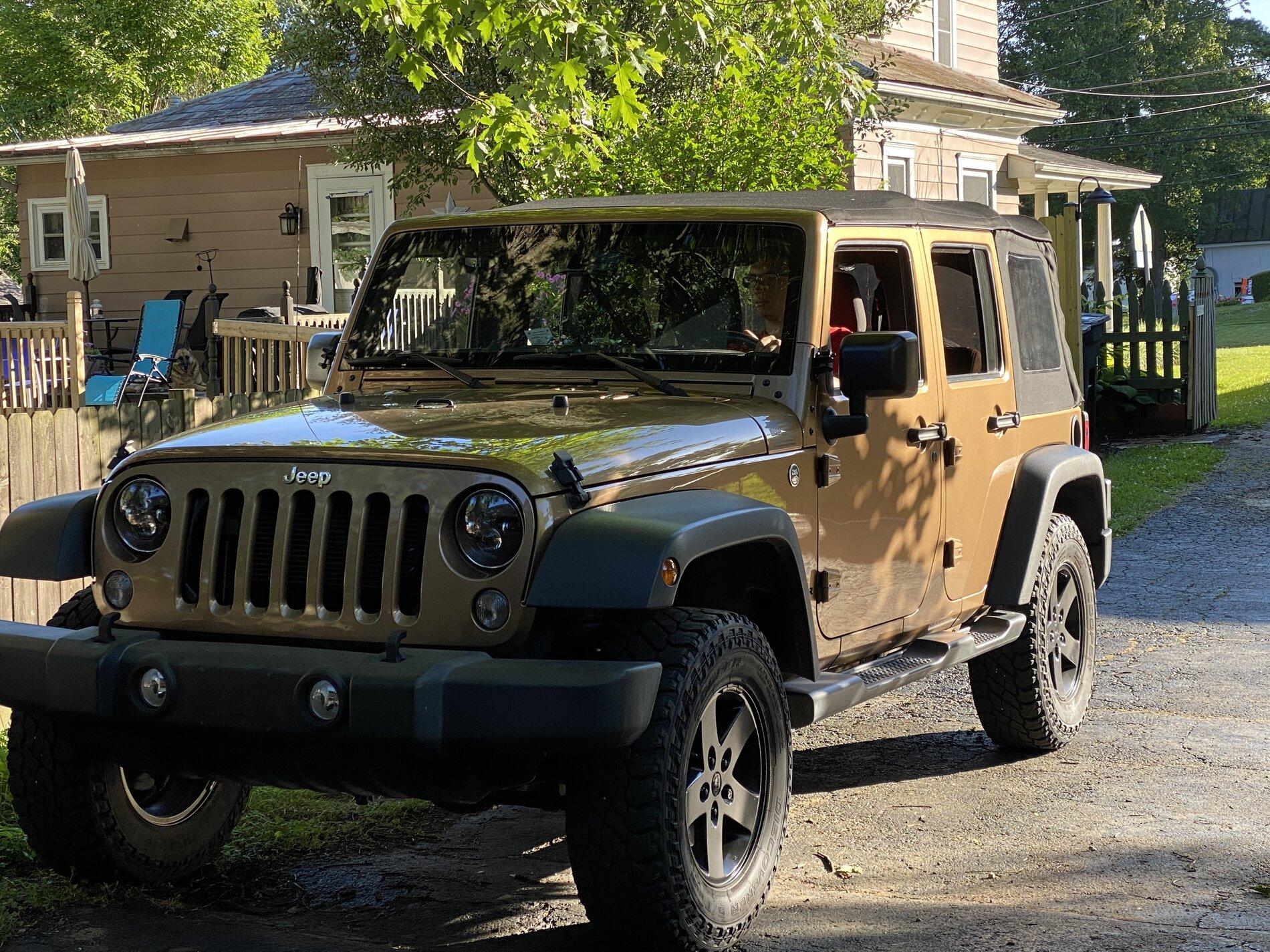

I have a 21 Willys that I plan to put 255/80r17 cooper discoverer st maxx on when I wear out the stock tires. This gets you to 33" on stock rims. I did this on my 2015 jku with a 2.5" lift and the tires wear great, are quieter (my humble opinion) the only draw back is they are stiff because they are heavy and load rated but for my Willys truck that's not a bad trade off.
I grew up in NW ohio, Toledo jeep and Findlay tires (but I like them because they are some of the best in the world)
Jeep Gladiator Bigger Tires on Stock Wheels 51CEB2BE-1BF0-43E3-AE8E-373D6299E8B5
Jeep Gladiator Bigger Tires on Stock Wheels 8BCE349D-4E2C-408C-AAE0-90711C1DE56D

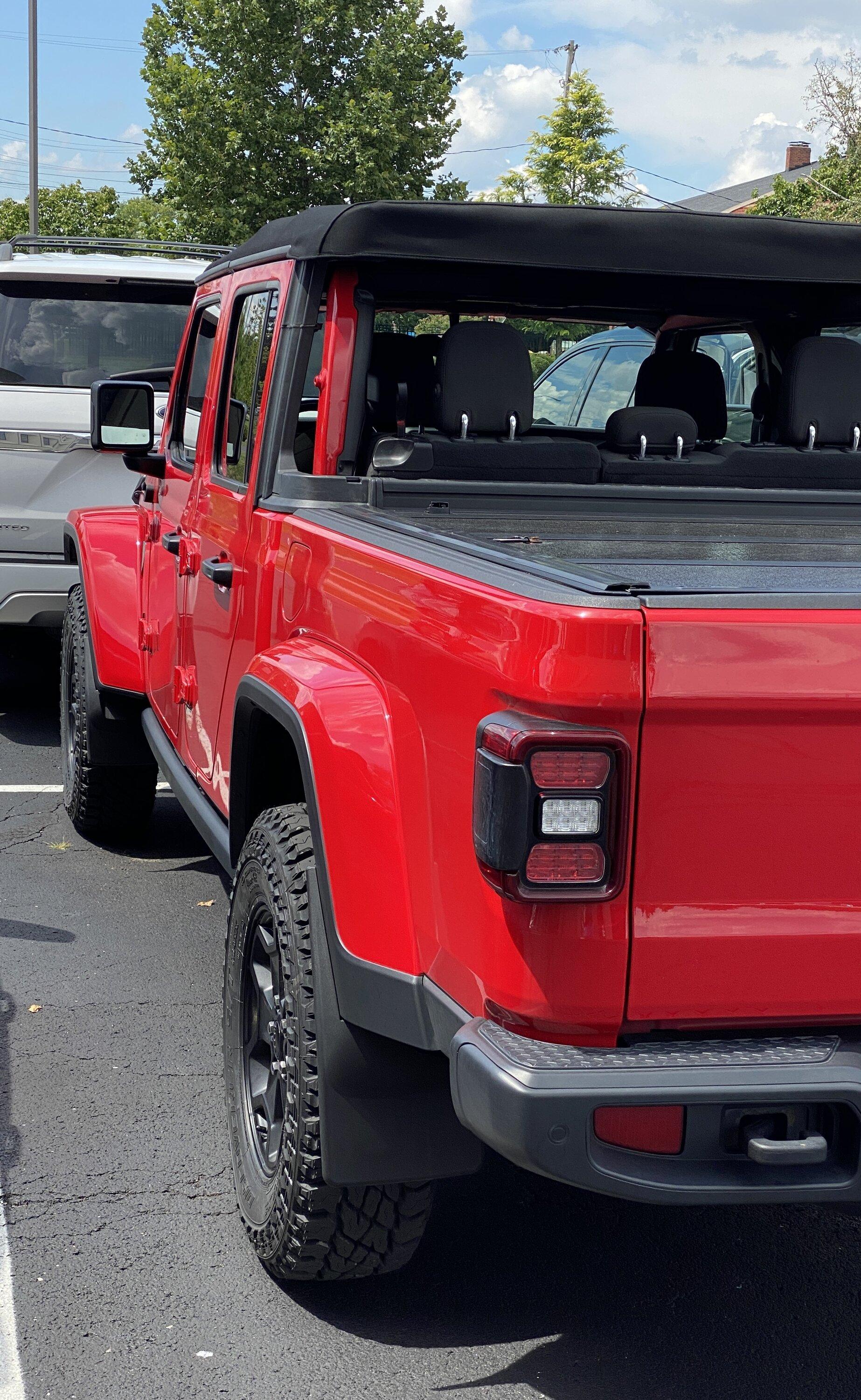

Round 2: just had them put on 255/80r17 cooper st maxx.
Ssssooooo much quieter! Wow!
definitely pizza cutters, but I like it looks "factory" to me: note the gladiator is on a 1.5" front and 3/4" rear lift, the tires are about 33" diameter.
the cooper tires have lasted a very long time on the wrangler, loved them on it, now I have put some on the Gladiator.

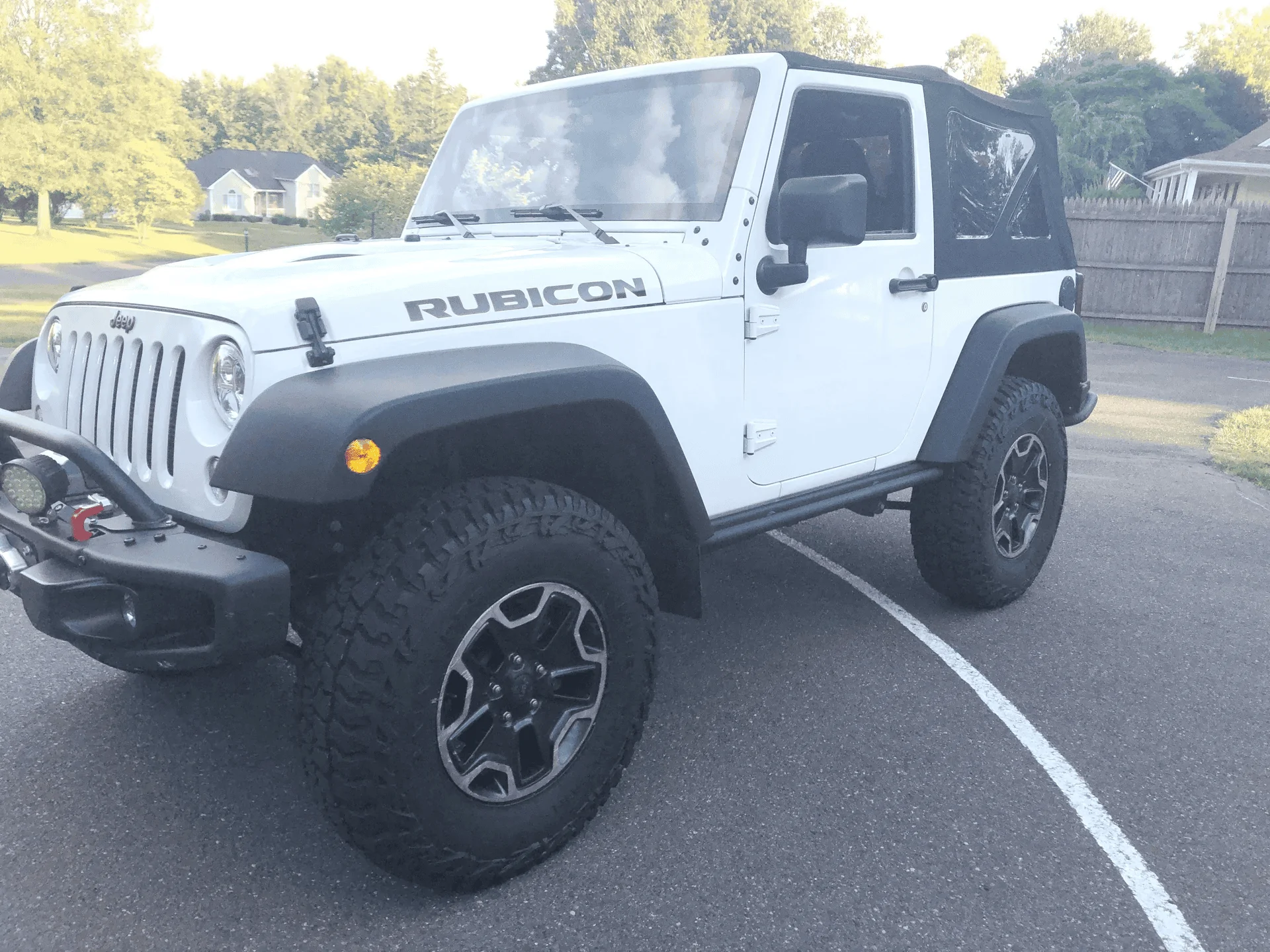

I just put a set of 255/85R17 M/T Baja Boss ATs on my JK, which has the same wheel size as the JT. I'm very impressed with their ride quality, ease of balance and they have done well off road so far.
For anyone wanting to go with 35s and keep them tucked under the fenders, this tire is a great choice.
Crappy pic, but you get the idea ...
