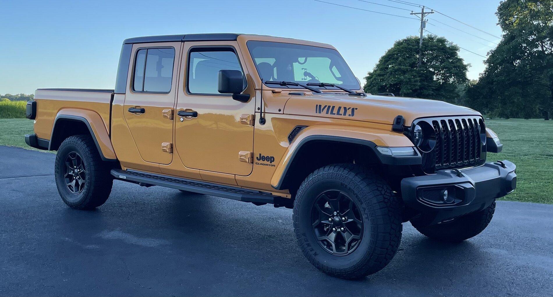

Installed 285/75R17 Ko2s on stock 21 Willys wheels this week, slight rubbing on sway bar links at full lock. I havn't even done any flexing yet disconnected. This is with a level (around .5 rake)
How are you guys shoving so much tire with no rub?
Not sure if the Willy's has the bigger axles but the Rubicon, Mojave and Max Tow has the extended axles and that's how most of us aren't rubbing.

Makes sense. Willys does not have the wider axles.

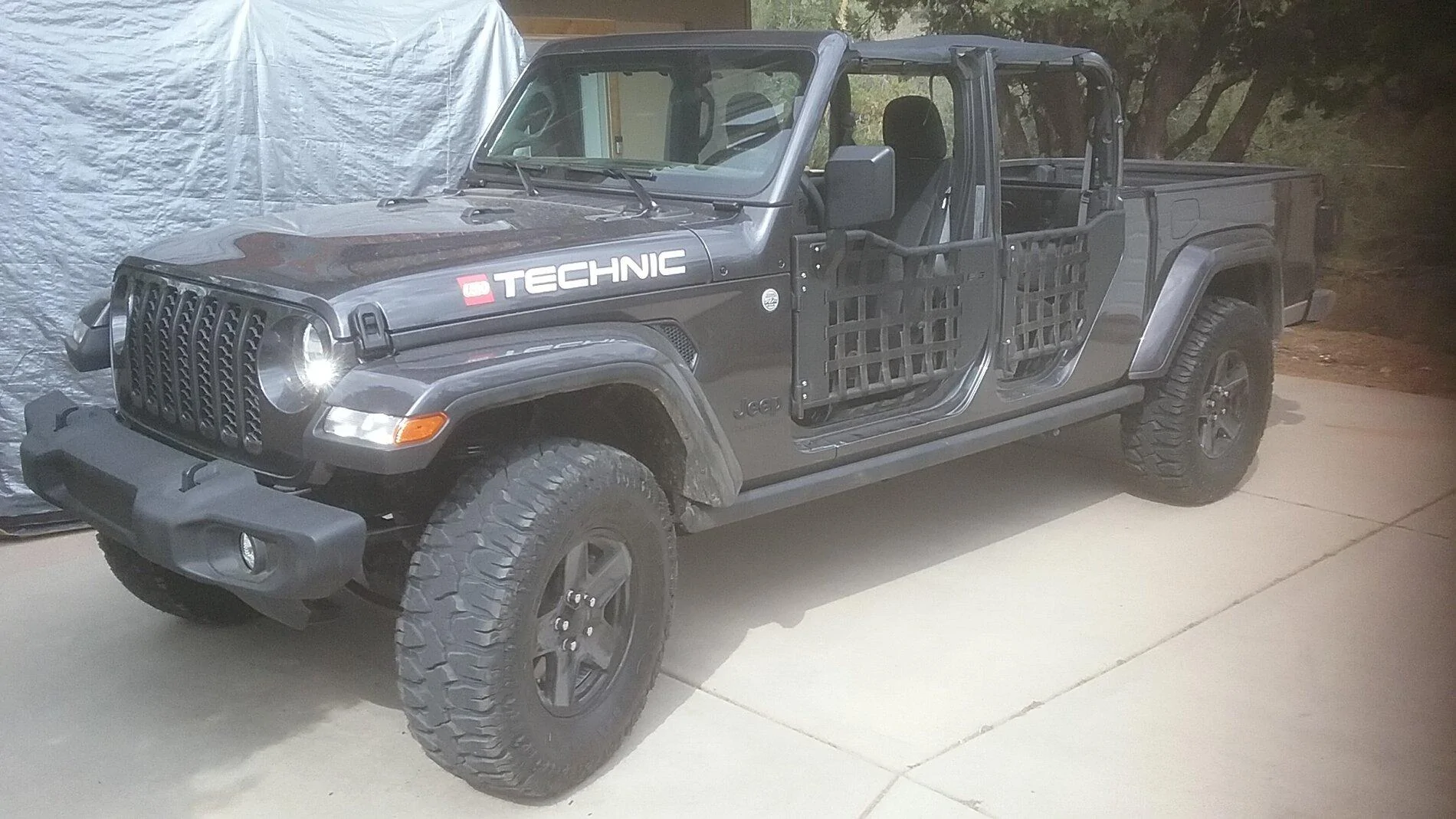

285/75R17 Milestar Patagonia X/T's on stock Willys wheels. 1.5"TeraFlex levelling kit in front. I have not experienced any rubbing. I have tested it flexed, but don't use swaybar disconnects. For my purposes, it works great.
Jeep Gladiator Bigger Tires on Stock Wheels Jeep with new tires
Jeep Gladiator Bigger Tires on Stock Wheels 20230627_132742
