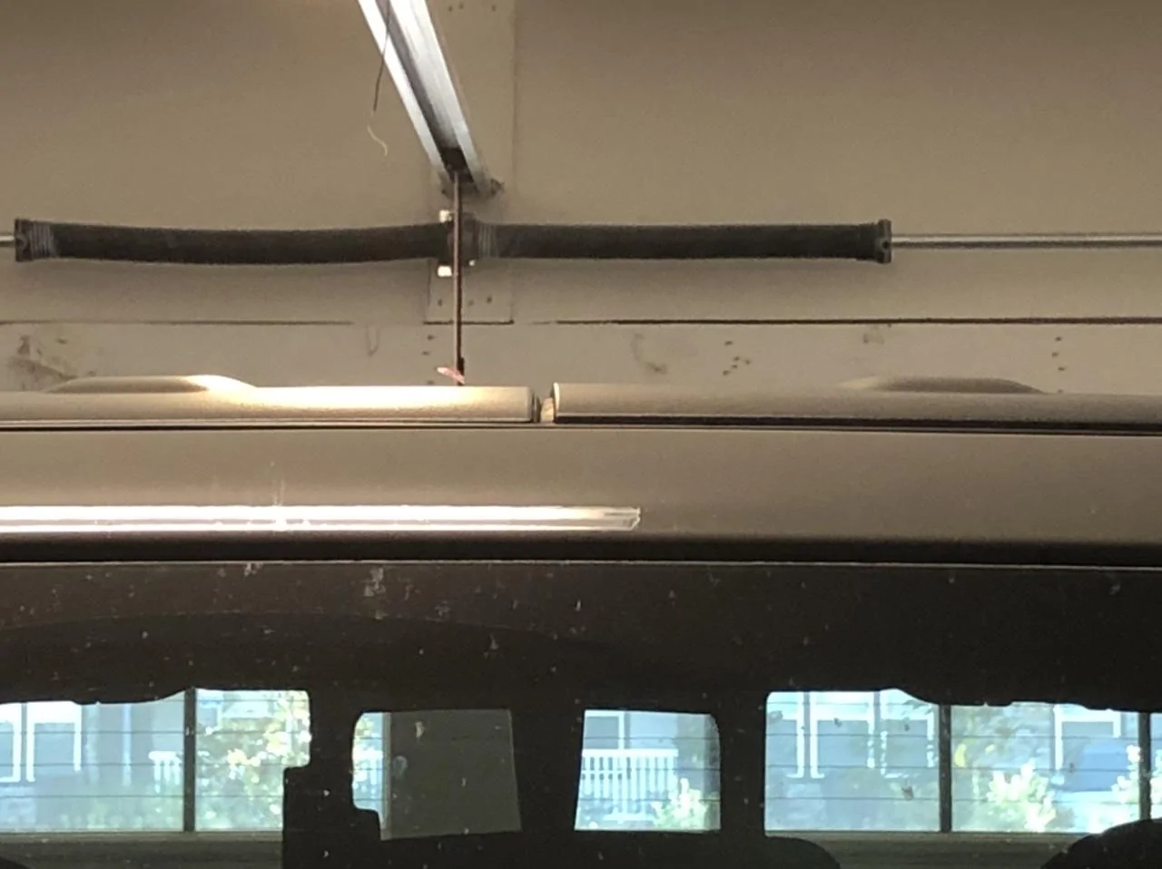

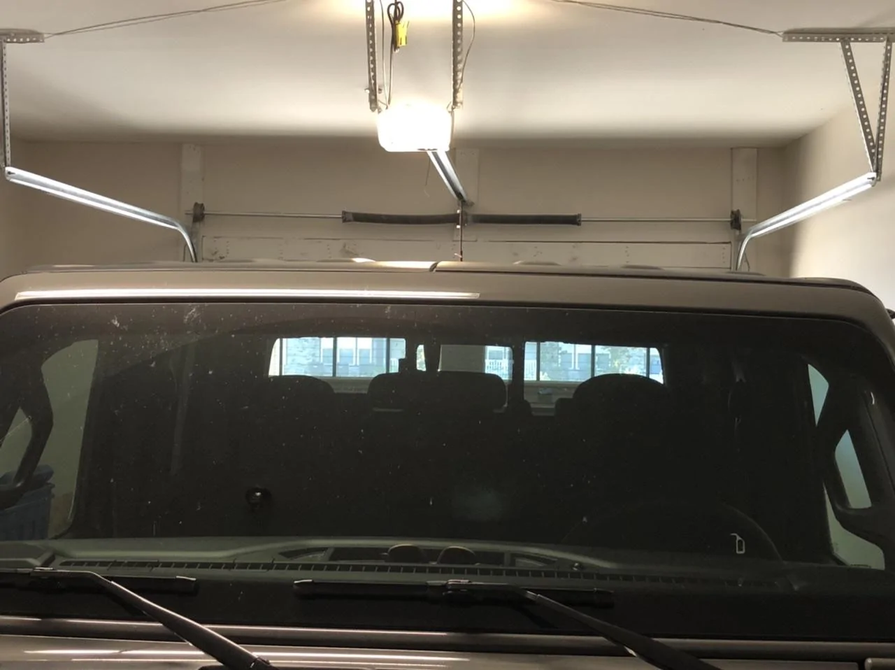

So the dealer was unable to resolve the alignment issue and referred me to their sister dealership about 30 minutes away that has a dedicated body shop. We have travel plans and decided to drop the Jeep off with them for the next week to resolve along with Jeep corporate.

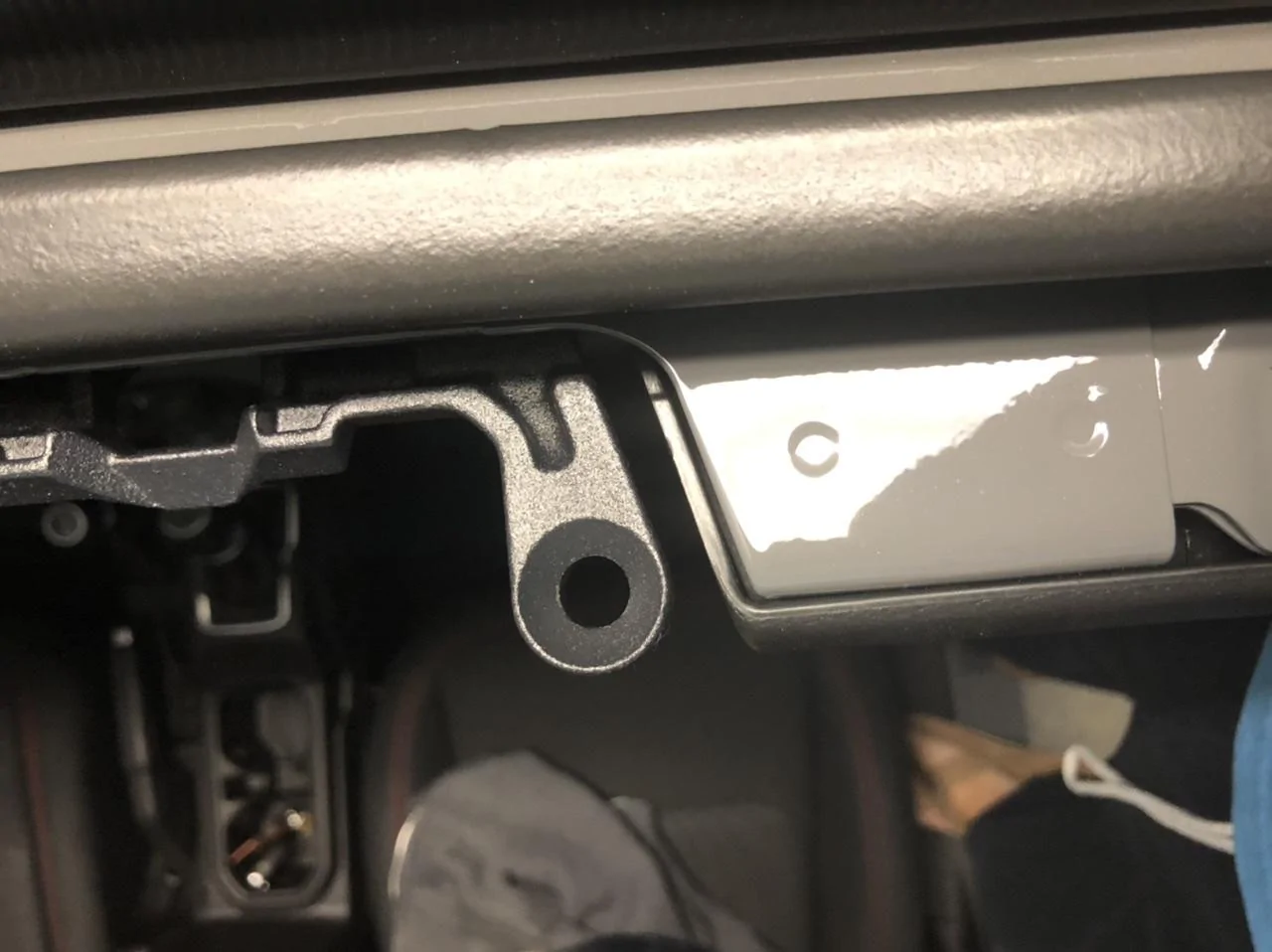

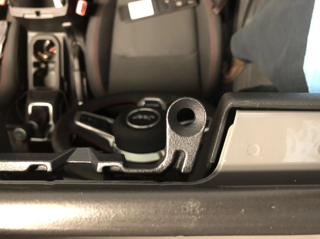

Made the drive out intending to leave the keys and the body shop manager jumped in and got to work. He ripped off the plastic interior panel that can be seen at the top of the windshield and located the stopping tab to which the panel rests and locks to with the twist handle. Turns out the thing is slotted for up and down positioning. We spent about 5 minutes in the parking lot and everything is flush. I can now have normal volume conversations. For the first time I can hear my tires over wind noise. I’d say <45 mph there is little to no wind noise. At about 70 mph or so, what once required 23ish on the volume now requires about 17 for the same song through CarPlay.
I feel silly that I didn’t resolve this myself, but I also wasn’t ready just yet to start taking apart panels for my $50k+ Jeep because someone got lazy on the assembly line. Glad it is resolved! I still have some fine tuning I’d like to do, but I’m happy.
Sorry for bringing up an old post, but my wife had a 2021 JL Unlimited built in October of 2020 and the first time we took the freedom panels off and back on I have the exact same problem mentioned here. The front corner of the driver panel sits higher than the passenger and the pin that drops into the white retainer is about a half inch from being fully seated correctly. Do you have any more info on how they fixed this? Gives me something to do while my Mojave gets built. ?
